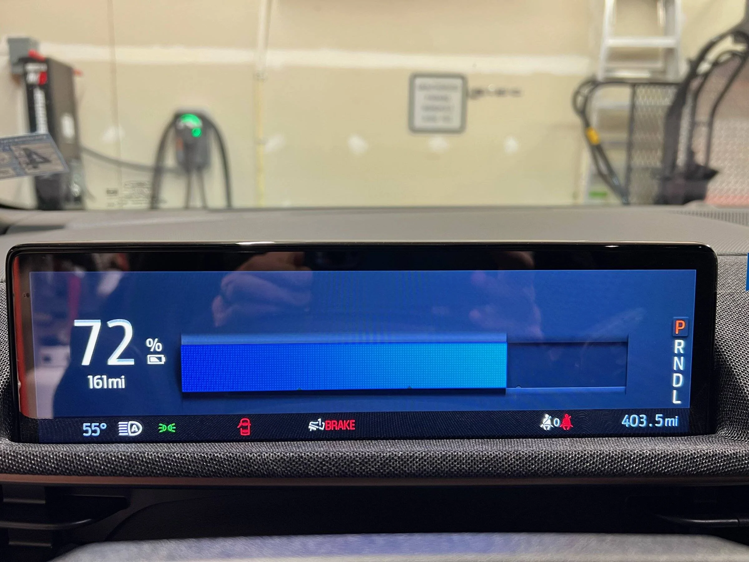

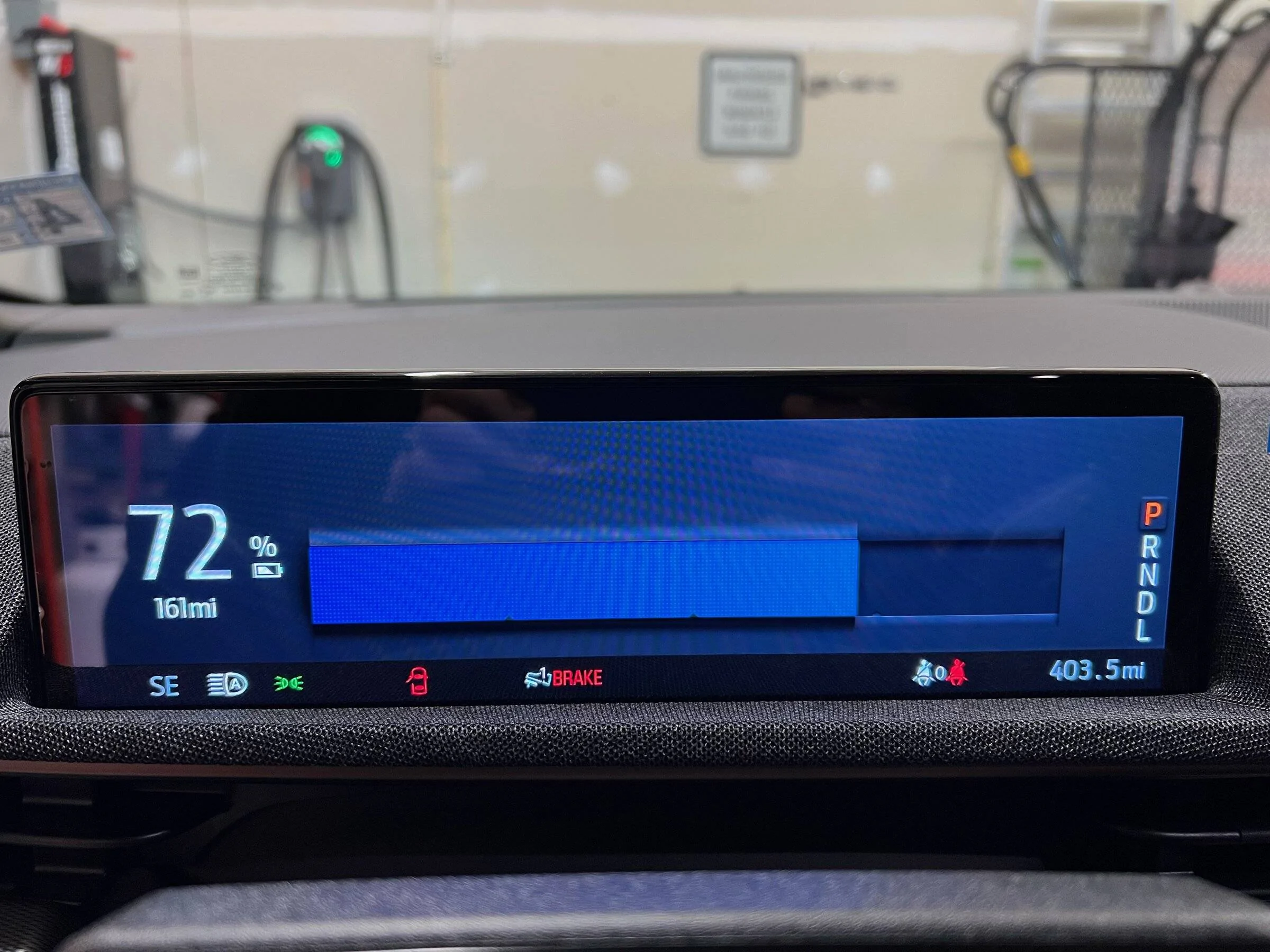

That was it! Doing a full rescan with the MX+ found the rest of the modules, including the IPC. It hung on the HCM and had to be force quit just like you said. Worked fine the second time, and I now have the outside temp in the IPC. Thanks!have you tried deleting the vehicle profile and letting it fully rescan? I have an OBDLink MX and a clone VCM that work fine. Forscan tends to hang on the HCM and I have to force close the app, but it always works the second time.
