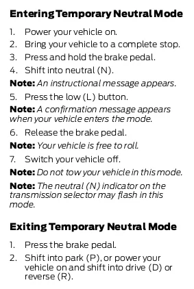

We got stuck at the car wash... before you cringe, it was touchless. Save these instructions! We had to do a web search to find out how to really engage neutral with the brakes released so the wheels rolled freely:
Entering Temporary Neutral Mode
1. Power your vehicle on.
2. Bring your vehicle to a complete stop.
3. Press and hold the brake pedal.
4. Shift into neutral (N). Note: An instructional message appears.
5. Press the low (L) button. Note: A confirmation message appears when your vehicle enters the mode.
6. Release the brake pedal. Note: Your vehicle is free to roll.
7. Switch your vehicle off.
i would not turn the car off. There is a message on screen to press the break pedal to be able to switch out of neutral.
Only 5 annoyed customers behind us.

It's also on page 174 of the manual (search for "car wash"):
