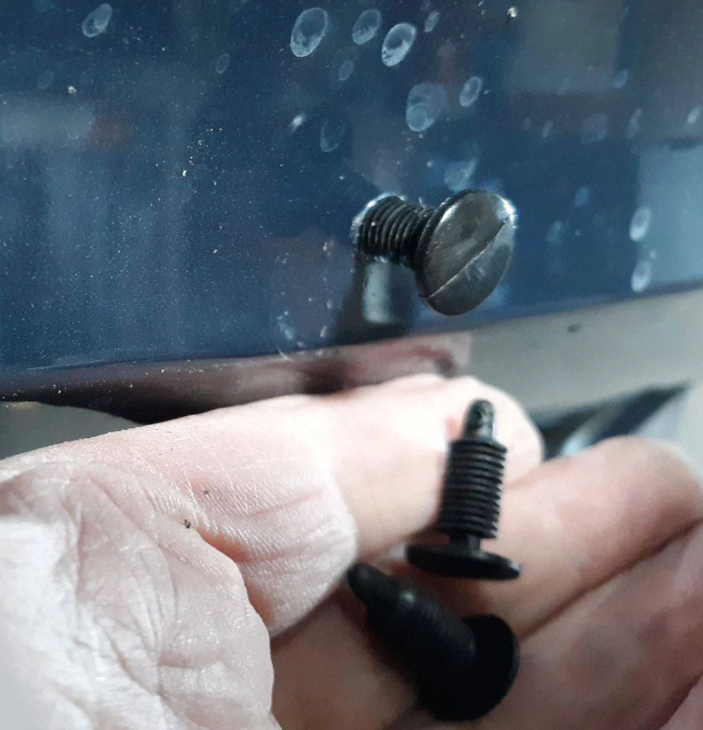

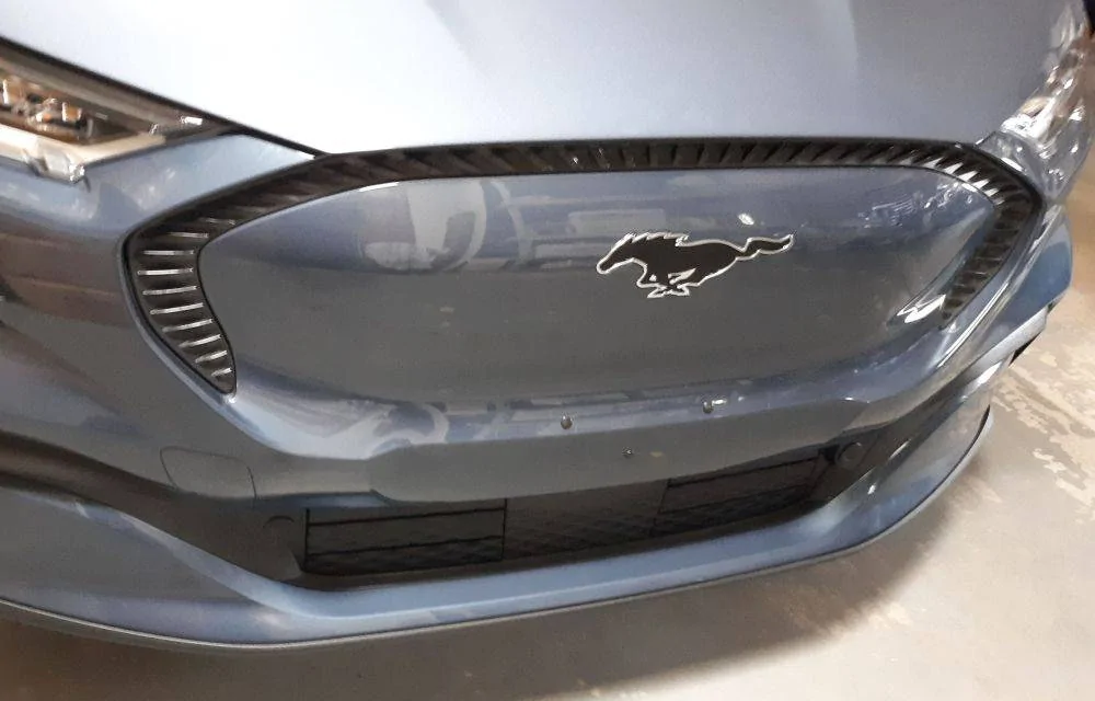

assuming you are in a state where it is allowed.... you were probably a bummed out as I was to see the Factory-installed front license plate bracket.

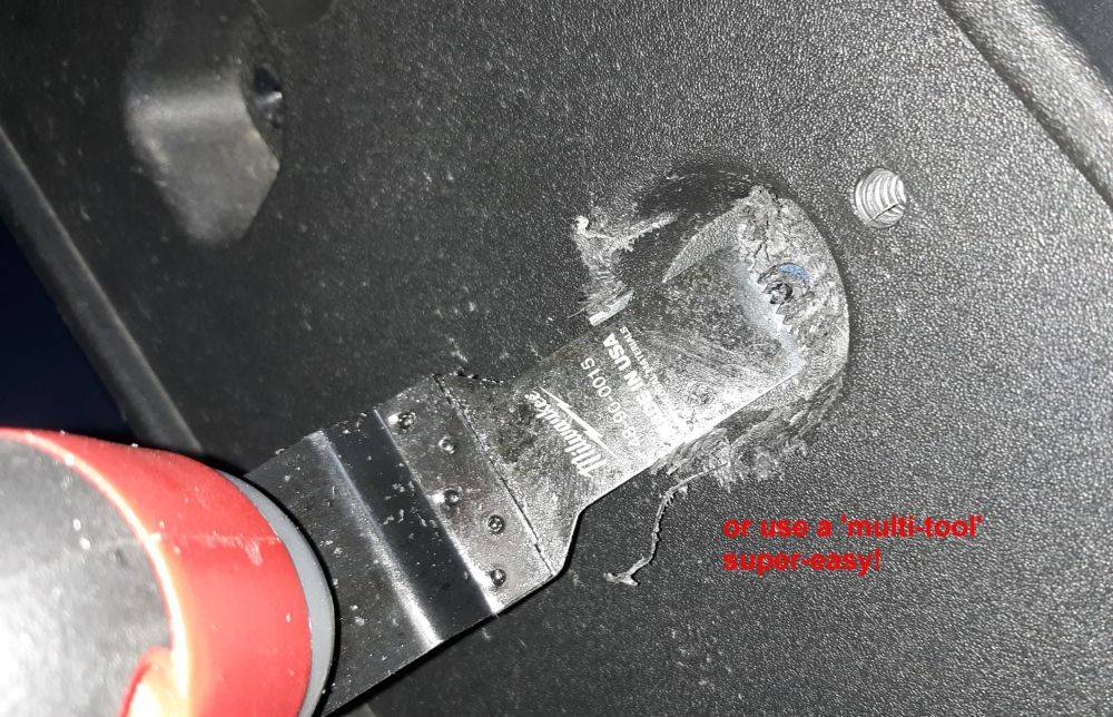

good news, is.... pretty easy to remove with either a drill, or a multi-tool.
and then you may want to find some button plugs or whatever.....

Are the two upper plugs sitting relatively flush with the curved surface? Looking into bumperplugs.com as a potential solution, since my PPF installers may want to remove the bracket.
Yes very flush, I just used standard black ones. You probably could find some flattered ones or spray with sound plastic touch-up paint that is close to your body paint color

Rivets?!?! Holy hell, I thought I was done thinking about the front bracket! :rolleyes: :mad: 🤬
This will make the PPF install more of a pain, was planning on just leaving the bracket since the damage was done but will need to remove it for the PPF install. What a PITA Ford- did the bonehead that made this decision not understand there might be a need to remove/reinstall it?
It's debatable at this point if the 3 plugs (2 would have been better) look any better than the bracket, but reinstalling it will be problematic.

The marks around the perimeter of the bracket just residue/dirt, or did you have to buff them out of the paint?
