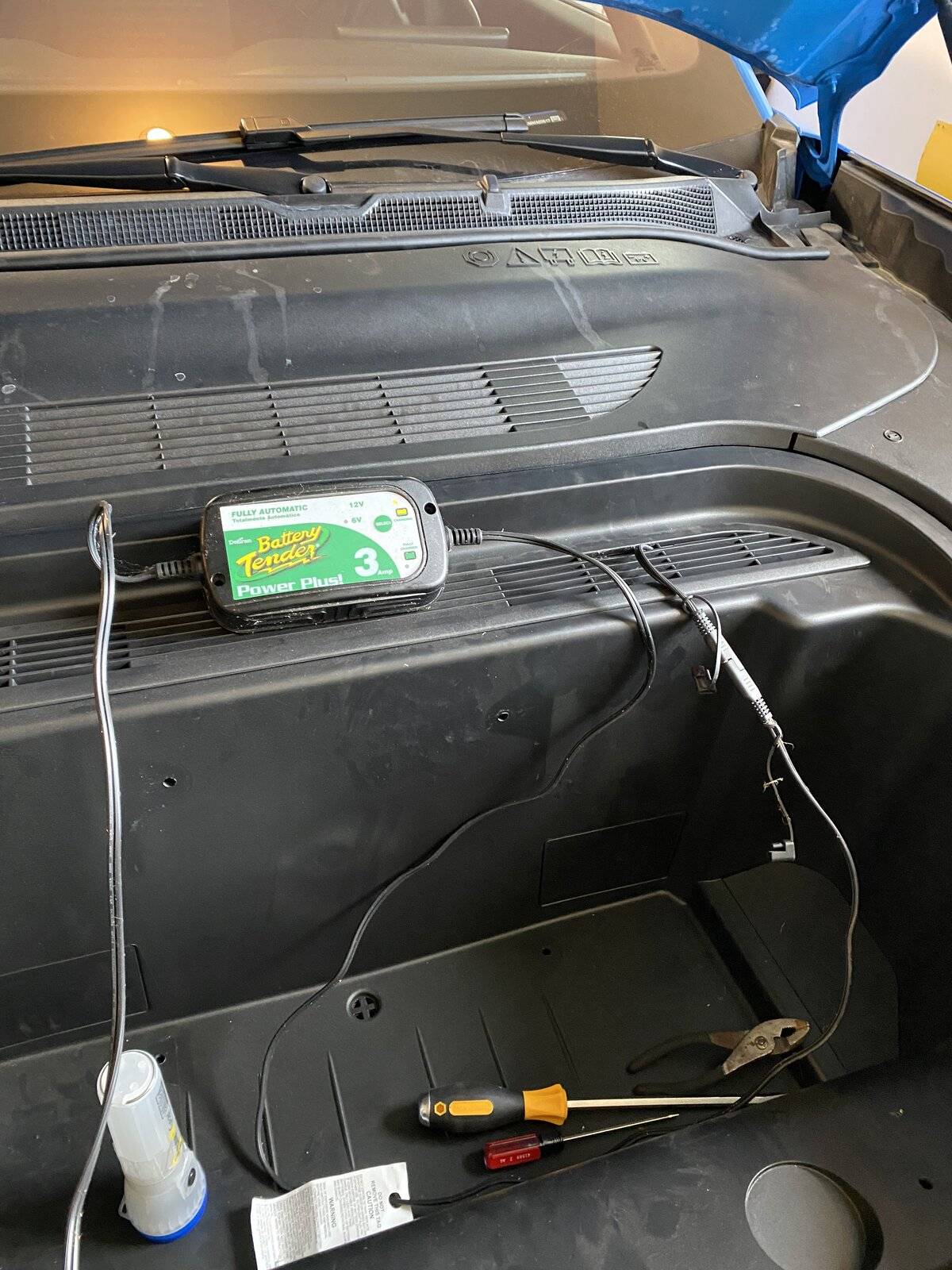

takes about ten minutes....
using a pair of stubby 'regular' screwdrivers and pliers, or an 'auto-fastener' tool to minimize damage to the (fairly soft plastic) fasteners.
You can re-install the fasteners, or get some new ones at a hardware store, to plug the holes. Or leave the extra drain holes and put some foam or Astroturf (my favorite) in the bottom of the frunk to keep cargo from sliding around and clunking when you are out there Drifting.... ;)

How easy is it just to remove the center piece so I have more space in the middle?
Woeo
Woeo
Feb 2, 2020
564
559
Fusion Energi
Have you noticed any additional road noise or issues after removing it?
It's all one piece.
Others (another?) have reported it is possible to remove the center/cross divider by removing all three, sliding the center out, then replacing the two sides. It is true that the center/cross divider can't be slid up with the side pieces in place.
Ten minutes with a Dremel tool or an x-acto blade cutting away the stop at the top might save 20 minutes removing and reinstalling the pins.

I removed the divider, and ruined a couple of the attachment devices. i tried to be super careful, but without that tool, the screwdriver method permanently deformed a couple of the attachments.
The frunk is way more usable now.
