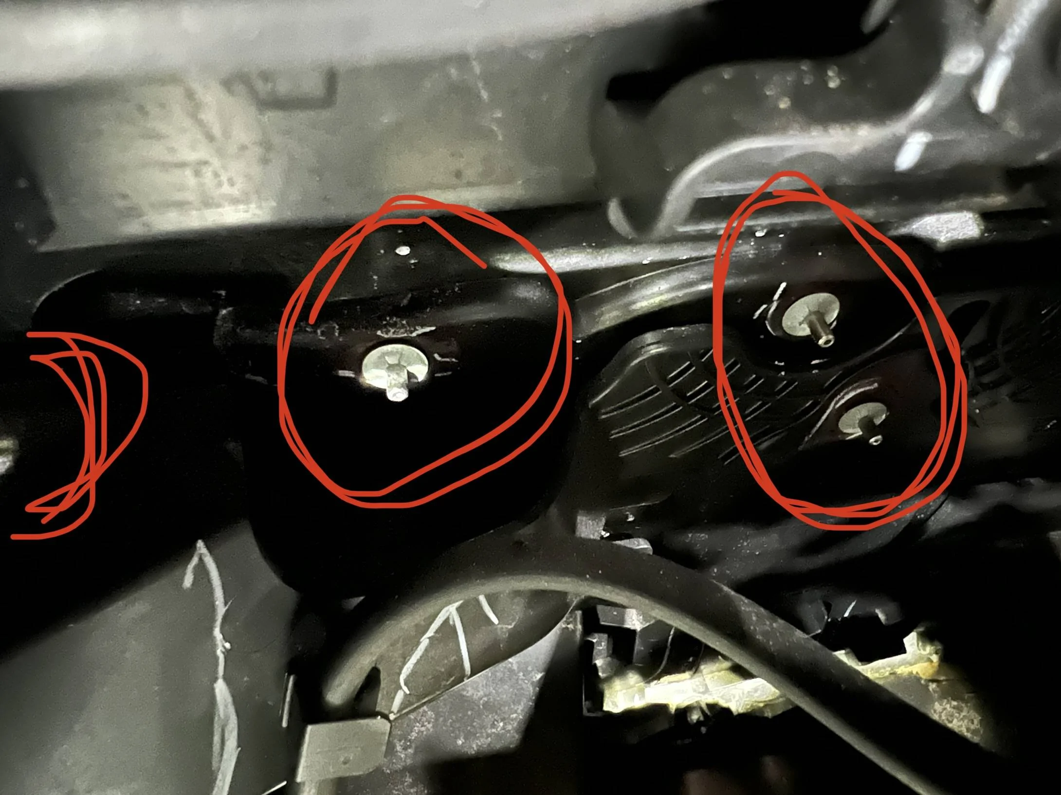

Front Pony removal:

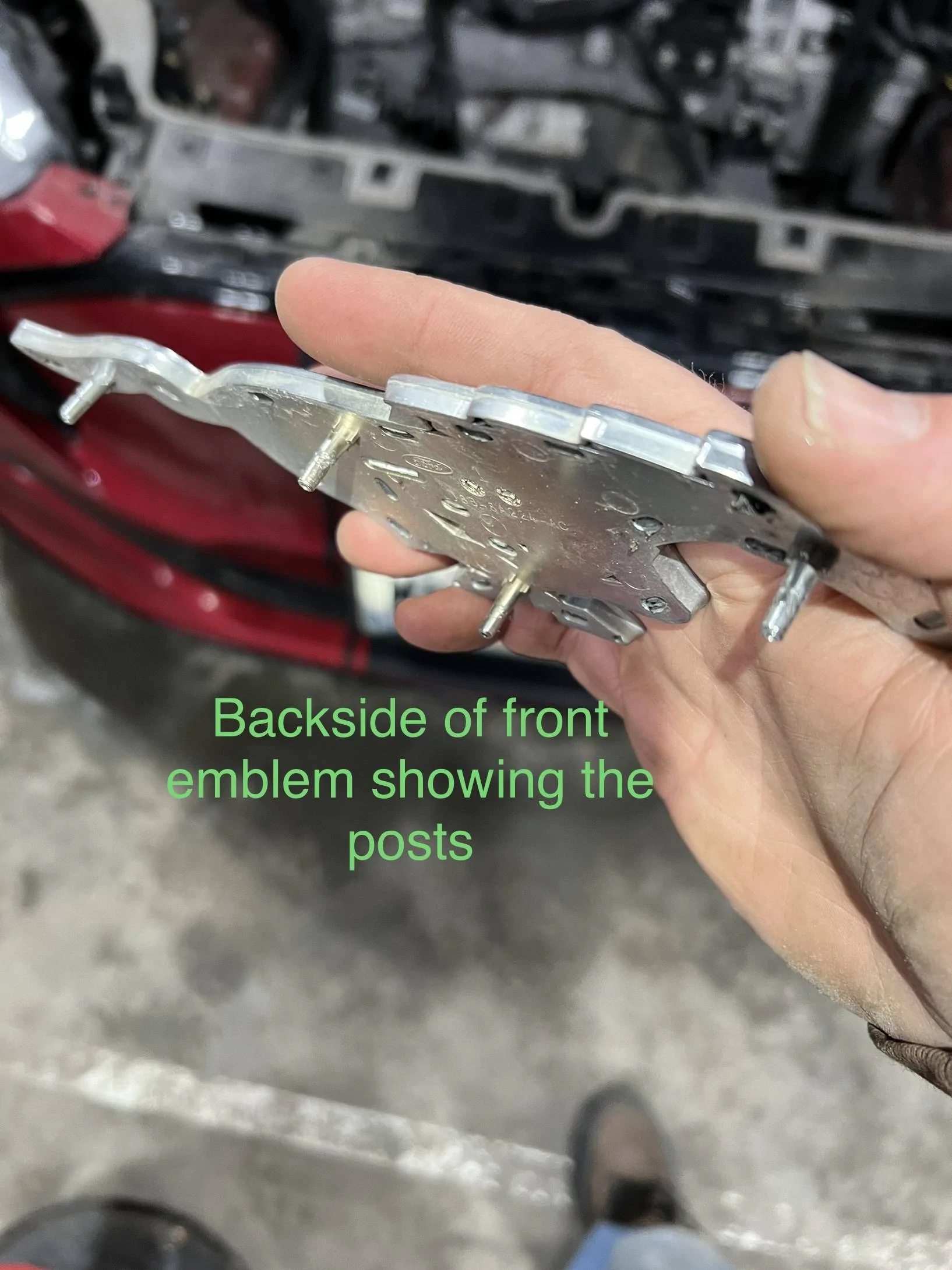

This one is a little harder as the emblem has three posts extending from the back of it that have push nuts on the back. Sorry I didn’t take a photo of them while it was off.

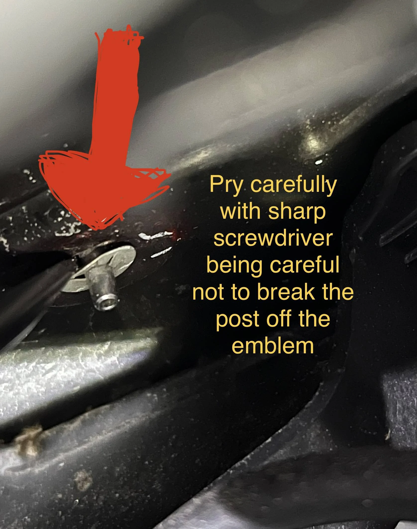

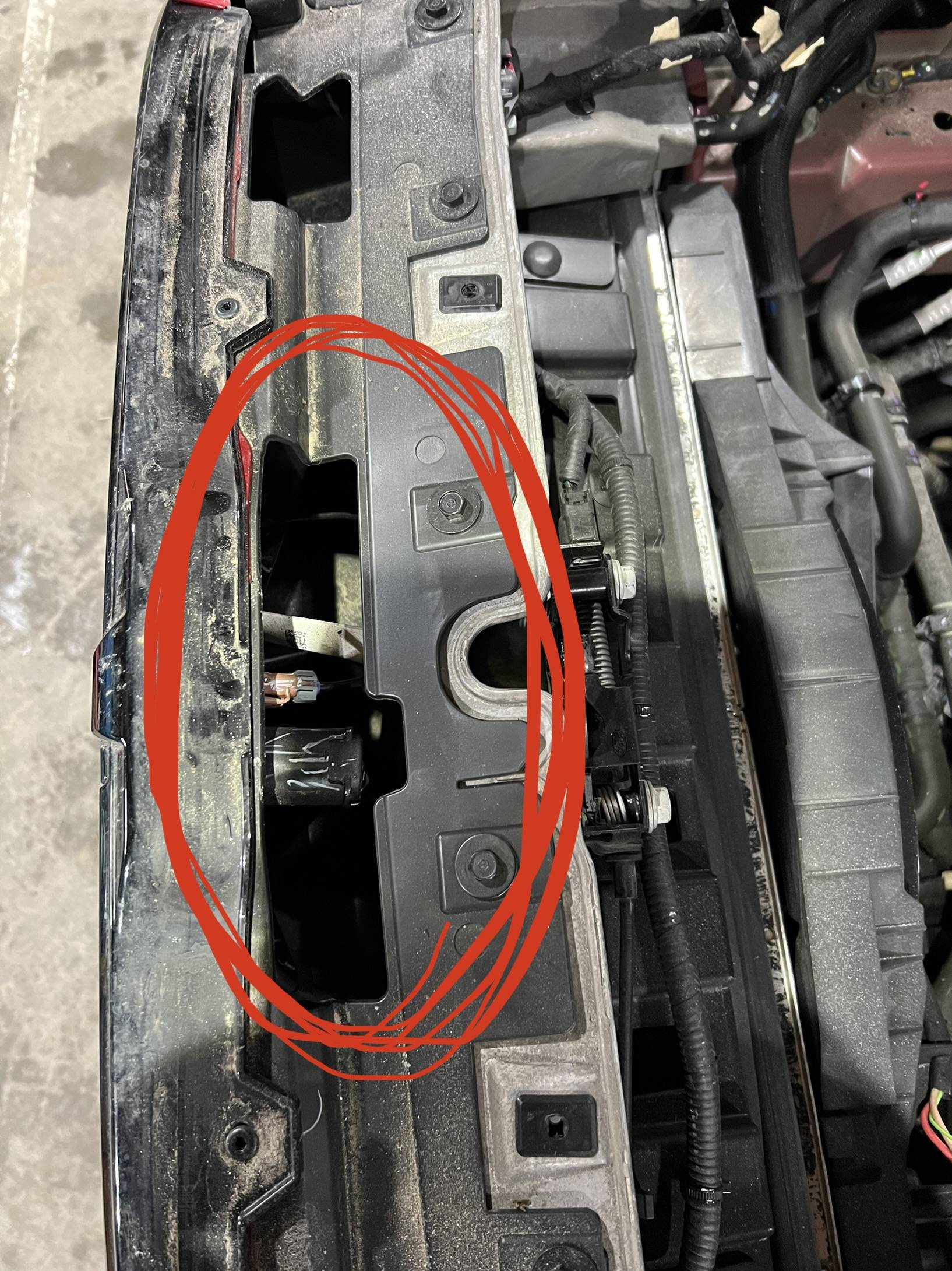

What I had to do for that was to remove the frunk and pry the push nuts off the back of the posts. With the frunk out, you can get a screwdriver or pry bar through the frunk latch opening. With the nuts jimmied off the posts, the emblem just comes right off. I broke one of the posts in doing this but there was no way I was going to get push nuts back on anyway. So it is now held on with some emblem tape.
To remove the frunk:
Screw off the frunk bump stops.
Pull the covers from around the frunk, as if you were trying to get to the battery. Pull the 5 covers highlighted in red, they pop right off with a screwdriver.
Each of the yellow dots indicated a hidden 10mm bolt to remove. The two blue dots indicate hidden torx bit bolts.
With all the bolts removed, lift the frunk slightly and disconnect the wires to the light and interior frunk release. Then the frunk will lift right out of the car.

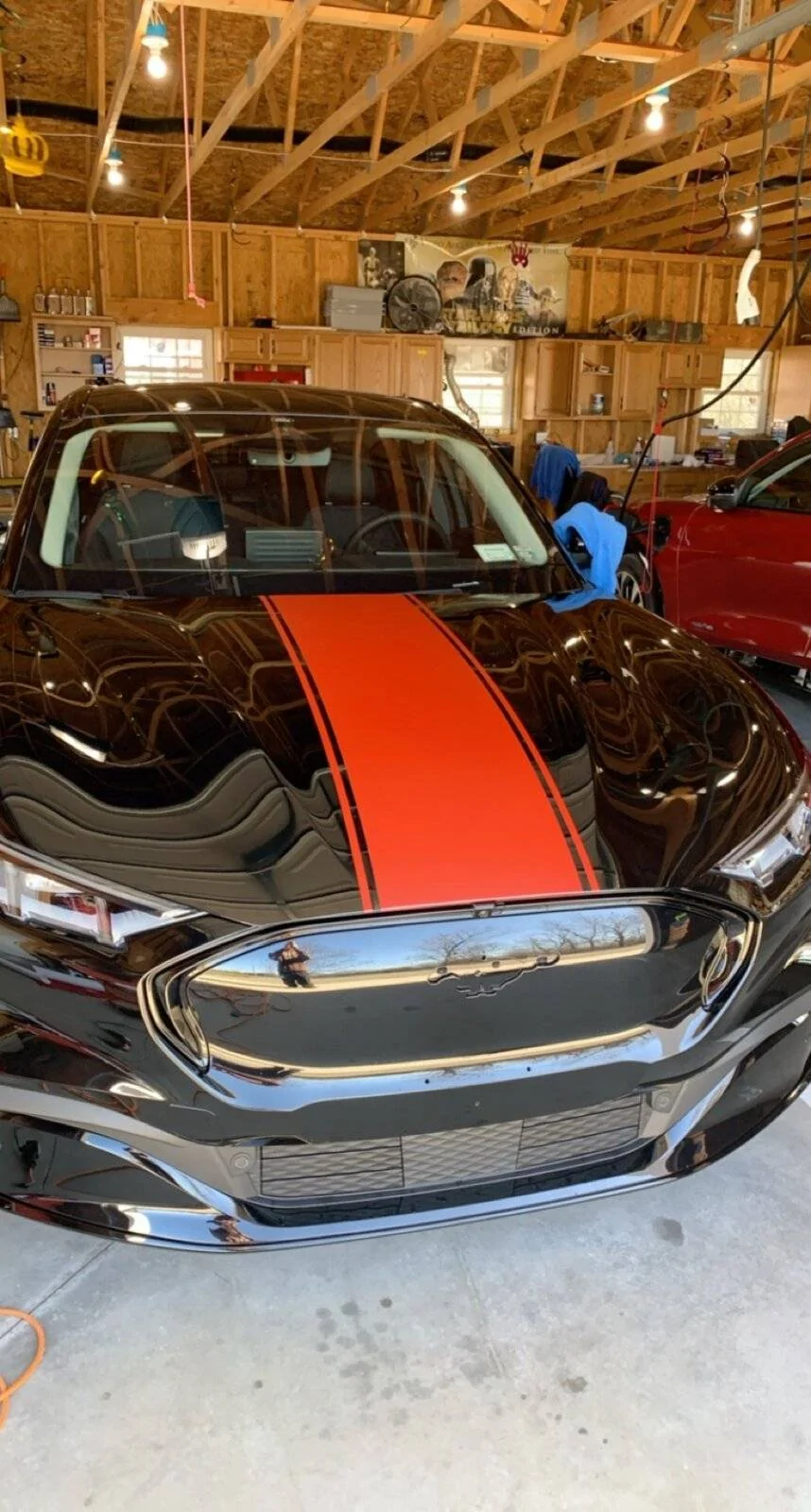

I’ve put them back on already. I only removed them to add vinyl striping. I wouldn’t think you would want to leave them off. The front is recessed into the molded plastic grill/nose area. This is the best I have of it as a work in progress.
