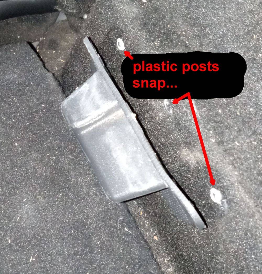

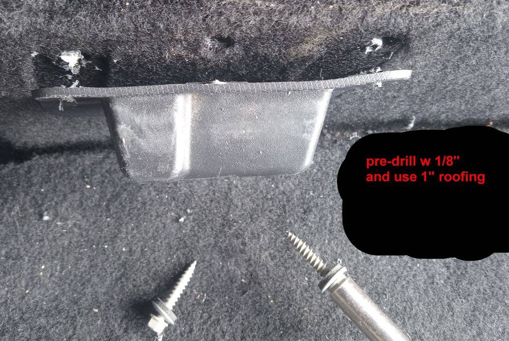

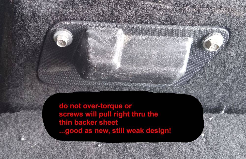

unless you are very heavy, or a very active sleeper, or in the habit of leaping into bed..... You'll probably be fine without adding bolts/screws. If you decide to do it before they break, it may be hard to hit the holes, so I'm attaching a picture so you can see the position to drill your pilot hole.
I'd suggest using a screw no more than 1" long, and don't overtighten as is is all plastic behind

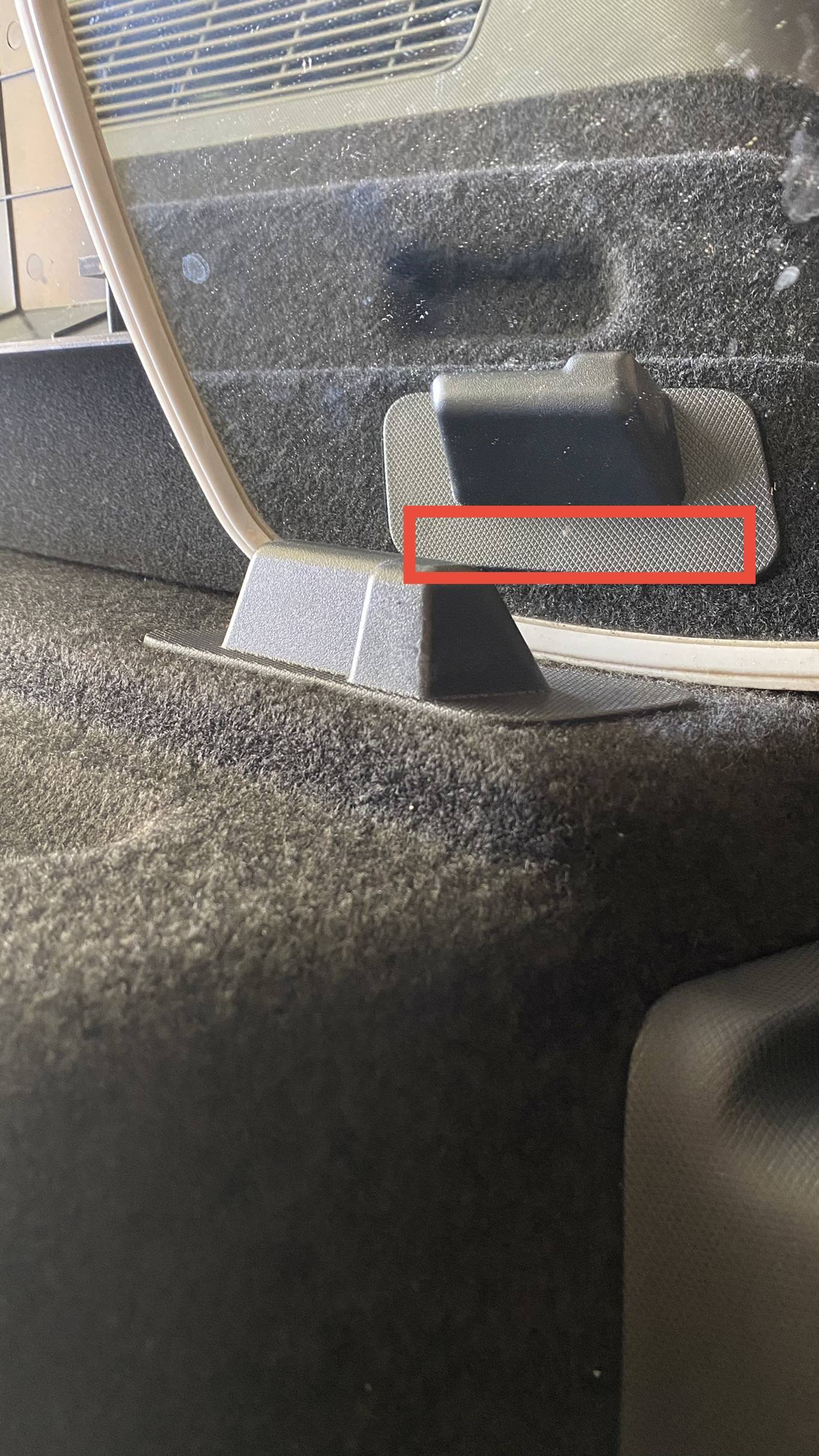

Thank you for your suggestion. it's very helpful but what in my mind is that add a couple of 1" screws in the red rectangular area and leave everything else alone, the thing is that I don't know what's behind the red square.

mechanically, you will be best off hitting the existing 'posts' at the top rather than the bottom since the load is cantilevered.... drilling thru the centers and using the plastic posts as an expansion post for metal screws. Metal screws will do a better job than plastic when it is in shear from shock loads AND hopefully be a little stronger and resist pull-out when in tension from 'regular' loads.
but if you really want to see what's behind there, you'll have to pull that panel.... which looks like it might get 'involved'.

What you said makes sense but I can’t tell where the center of the plastic post is until it breaks off. So until then I can’t do anything preventatively. The good news is even they break it looks like it’ll an easy fix.

If it knew where those plastic posts are behind that supporting piece, I could screw a screw into each one of them now, but hey if it ain’t broke don’t fix it.

you can tell pretty much where they are from my picture.... the 'center' of the rounded top corners. But, I guess I'd wait to see if they break now that you are aware of the issue.
