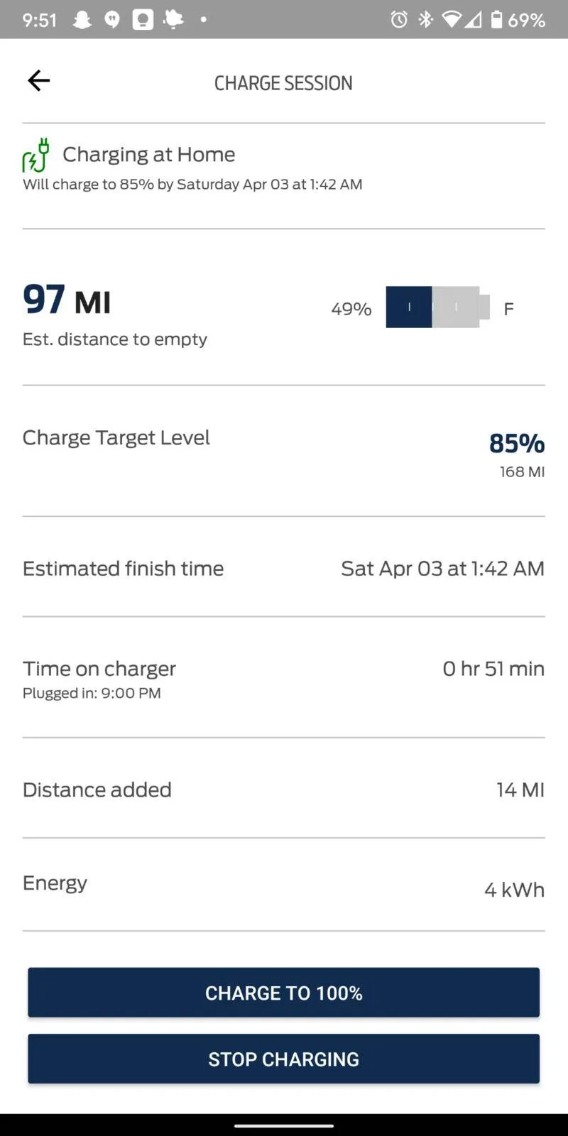

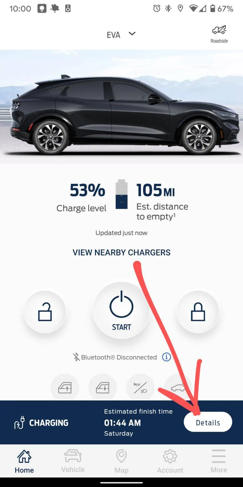

I see you're on Android. The Android folks seem to be having it easy compared to the iOS folks. Can you tell me what menus you selected to get to that screen?
Yeah, Android 11 if it matters for anybody.
Sure. Basically from any screen there is this floating notification bar at the bottom of the app that will jump right to the manage charging page. (See screenshot:)
