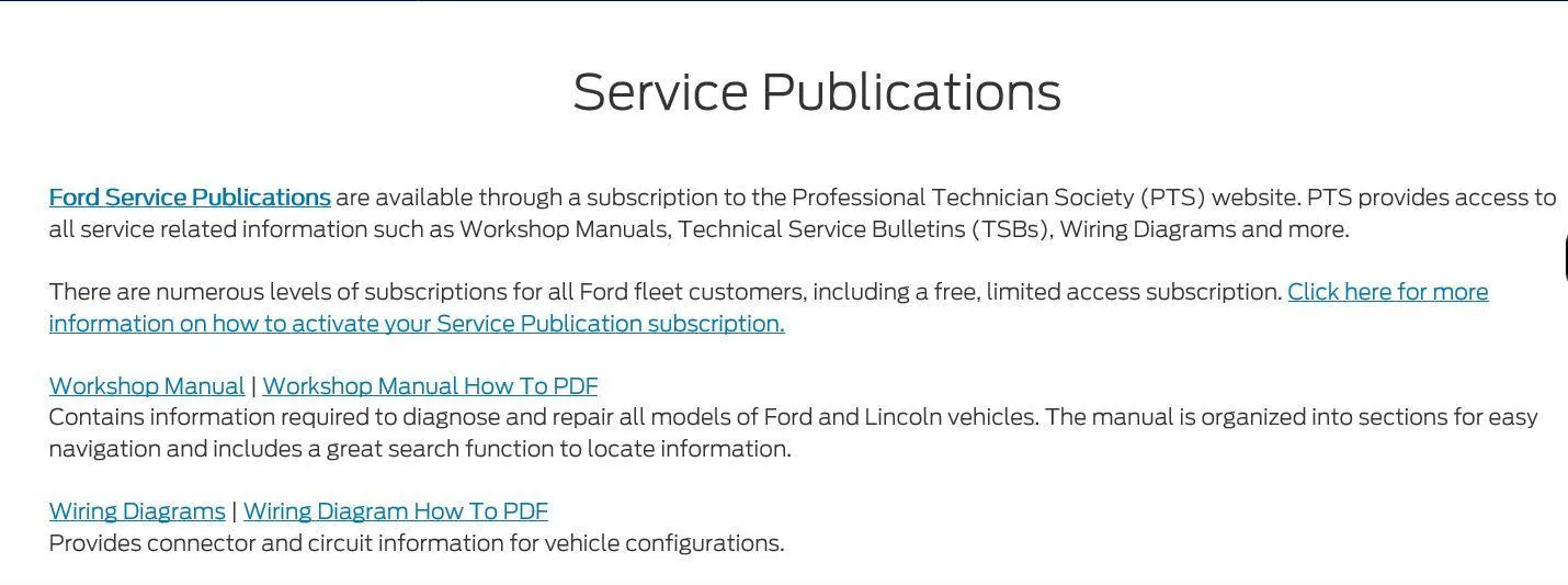

So, I got an fdrs license for the first time since October and ran all of the updates my car had (Which were many)
So for those thinking of doing the same to get blue cruise, let me share how the journey has gone so far
