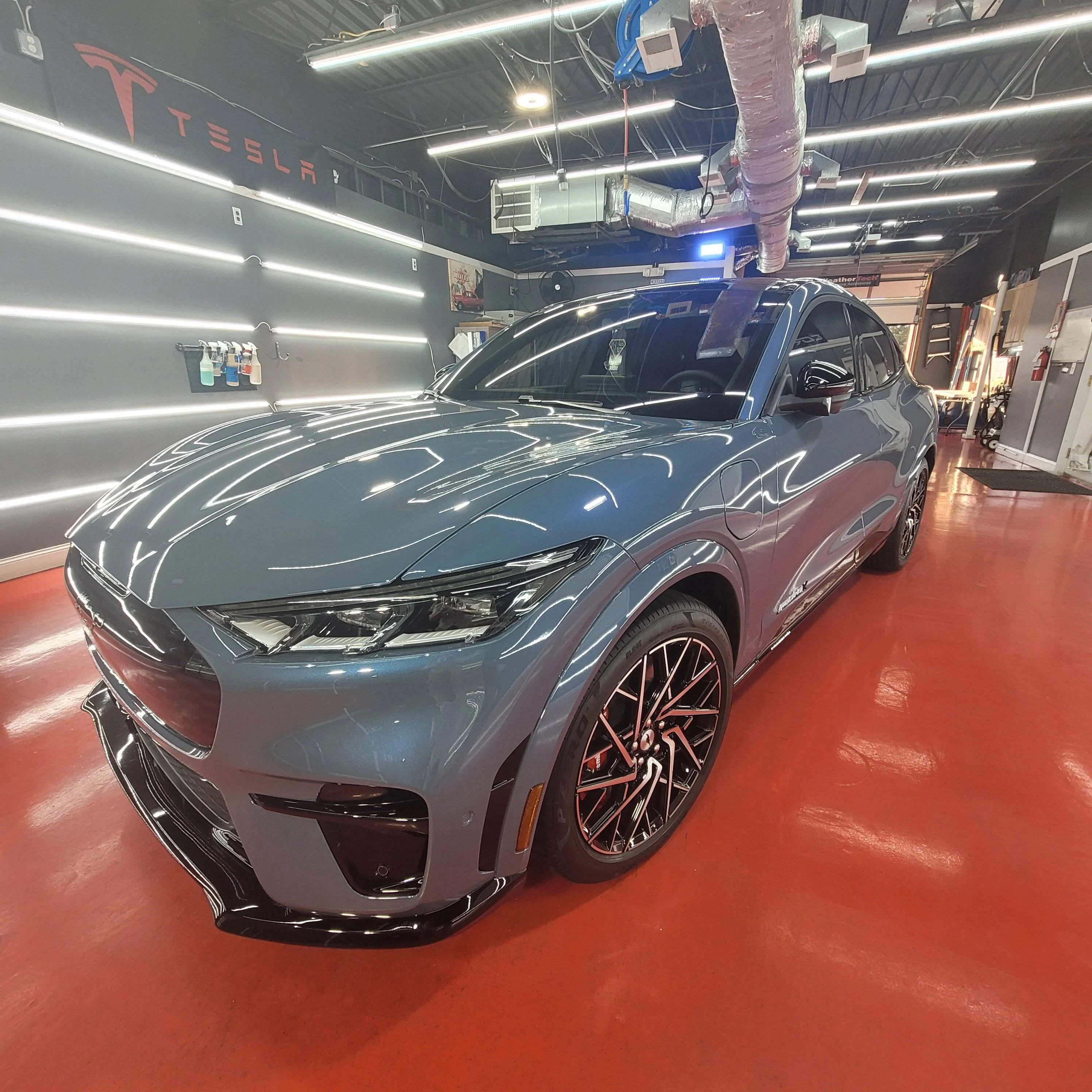

Ford Mustang Mach-E I recommend Gyeon Cancoat Evo ceramic coating after DIY applying for first time Vapor Blue Met
