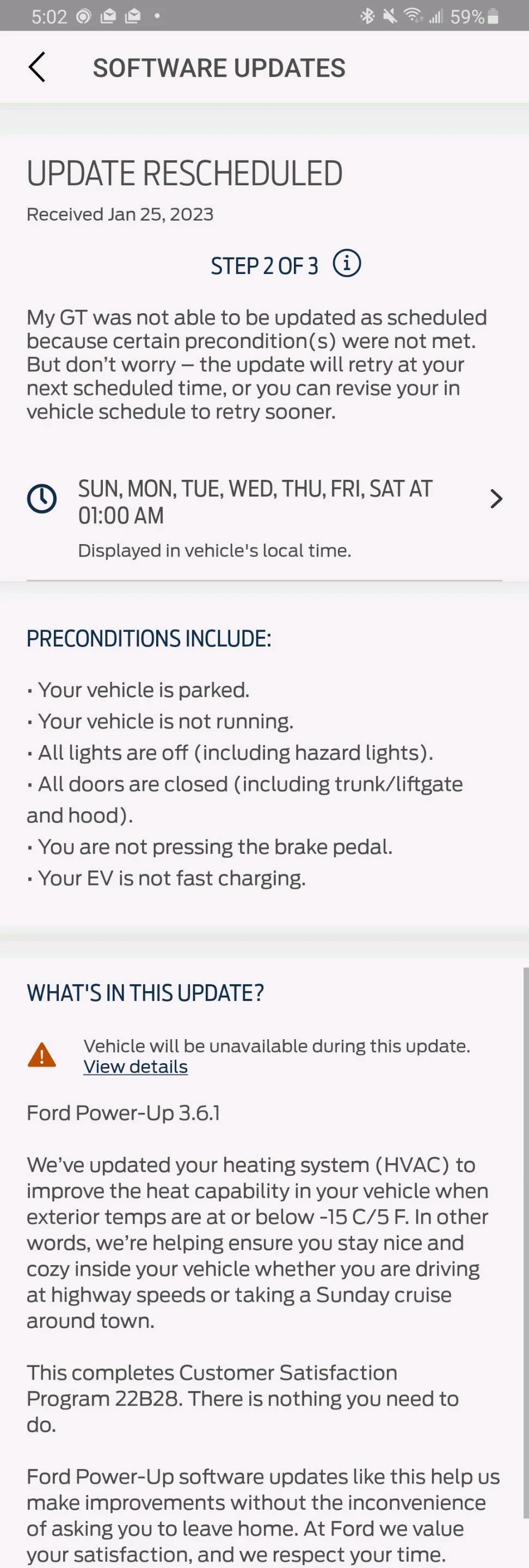

I think some of these items are coincidence. None of those prevent the update from being available and ready to apply to your car, but some of them can cause the update to fail.
I got 3.6.1 today. It was scheduled for 1 AM tomorrow but of course I didn't want to wait. I hit "apply update now" but then it failed. I got the following notice in FP which clearly explains what is required for the update to be successful. I think these requirements are consistent from update to update, although I think some updates require fewer of these conditions to be true.
Ford Mustang Mach-E If you want your Mach-E to get OTA updates - the SOC of the 12V (LVB) must be at least 80-85% Screenshot_20230125-170212_FordPass
