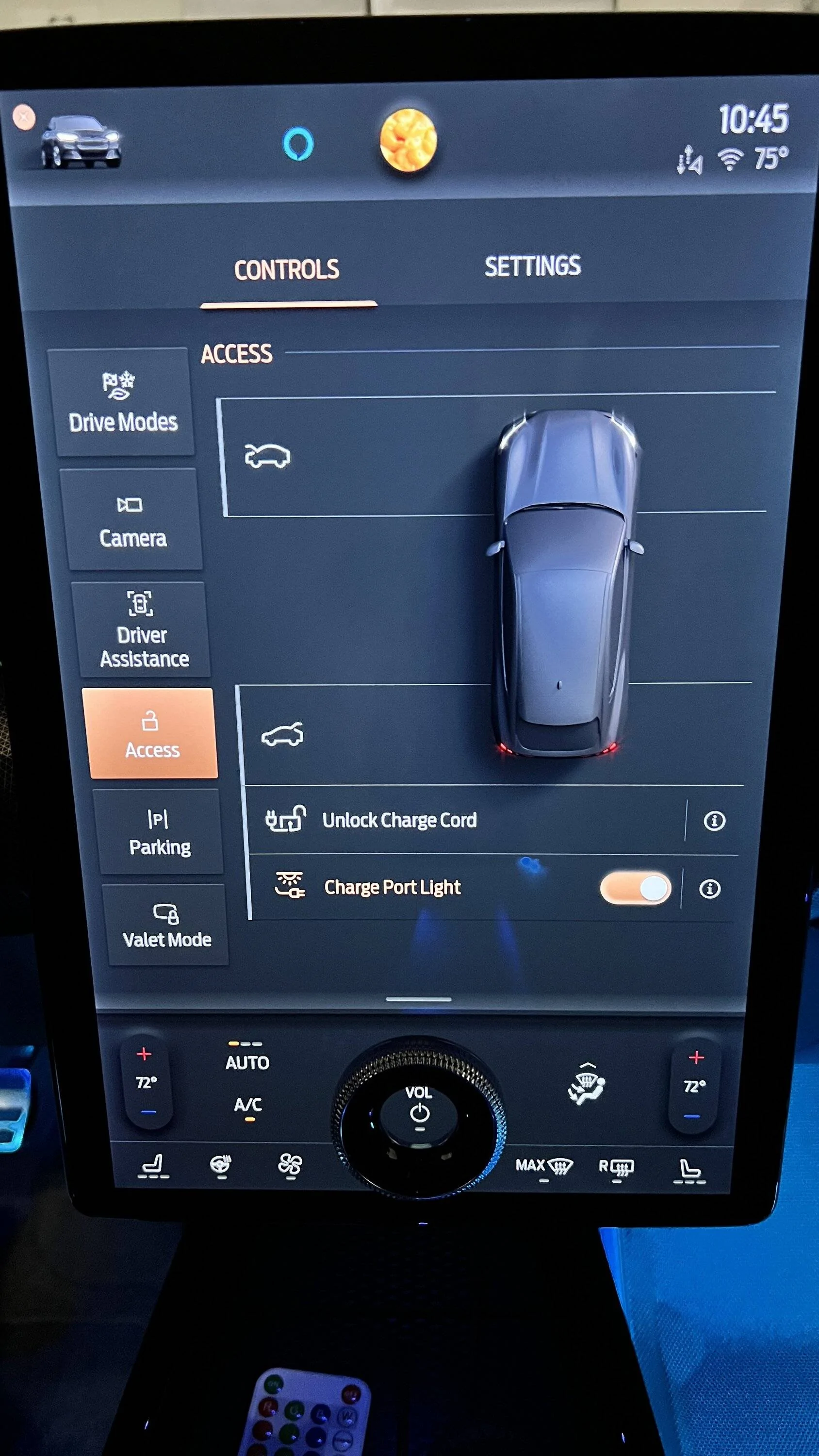

Default when you pull down car menu is at access (YAY finally):

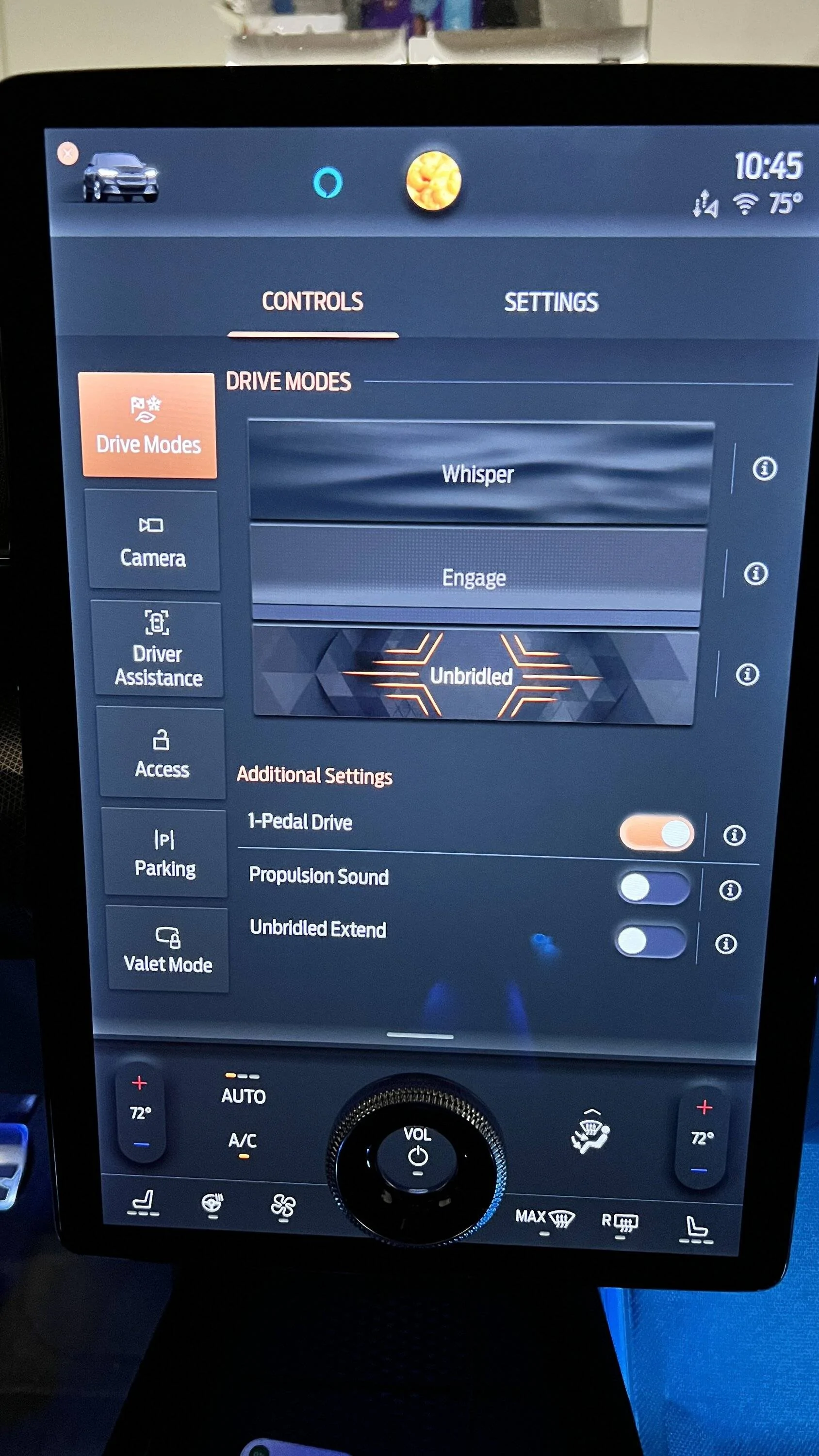

Drive modes screen seemed more compact and definitely less lag to switch modes:

- Hitting the "car" now brings you (much faster!) into access by default, not drive mode, which is hugely good. Very quick experiments in my garage but time-to-task for opening my hatch or frunk was much much better, perhaps even enough to prevent me from cutting up wires in my dash to install a physical hatch button
- Access screen seemed less tall so it didn't scroll annoyingly, and the touch target seemed to work every time (this didn't for me before, there were strange scrolling and touch target problems)
- Drive mode screen also was less cluttered in layout and was much snappier to use
