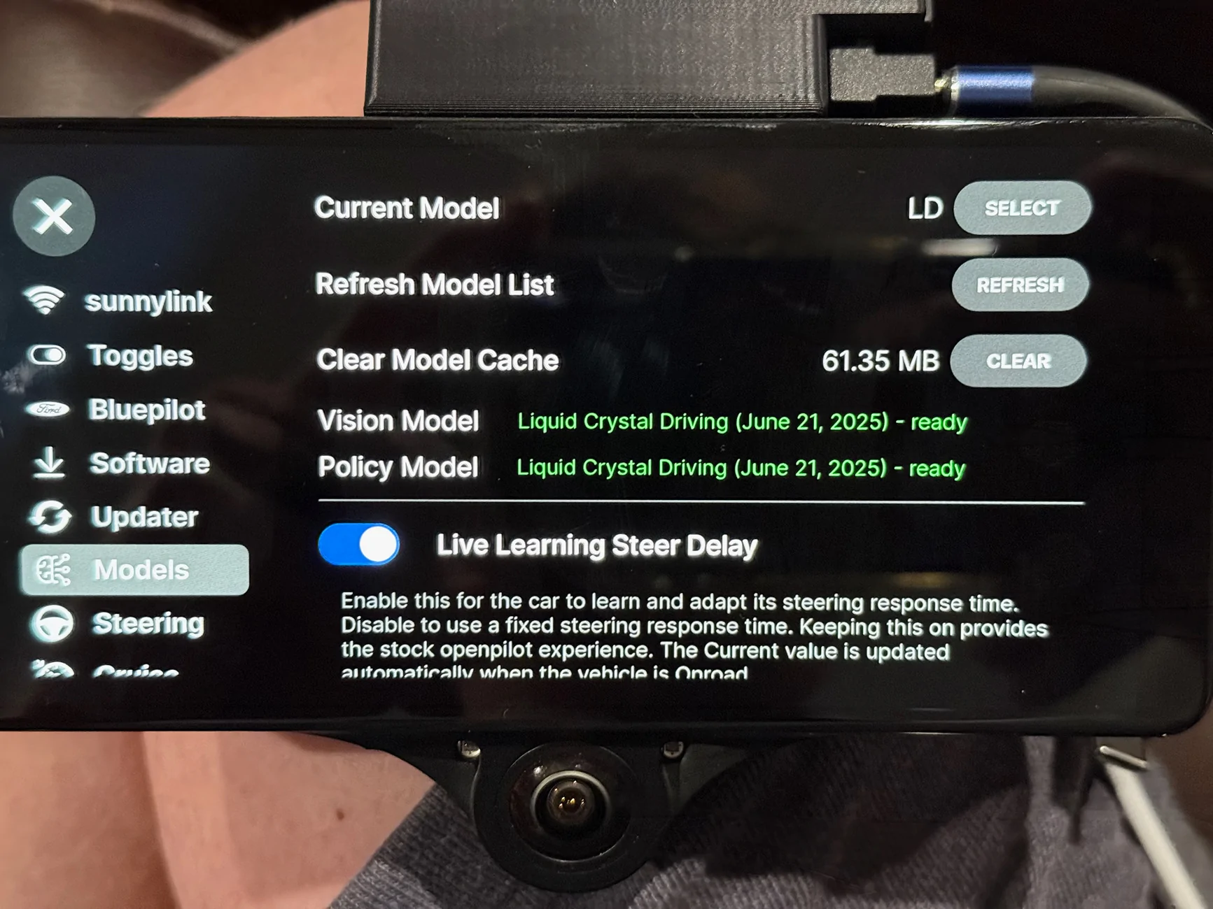

I just did my first 2 drives with 4.0 (110 miles) and it was a pretty rough go. The car ping pongs like crazy on straightaways and can barely take a curve without throwing the "turning exceeds steering limit" error. I am using the FoF Liquid Crystal model as directed.
It's hard for me to make out what is what in the settings so I'm not sure how to tune it (or if it's even tunable). Is it suggested to just go back to 2.1? I really like the UI improvements but 4.0 makes the comma unusable for me.

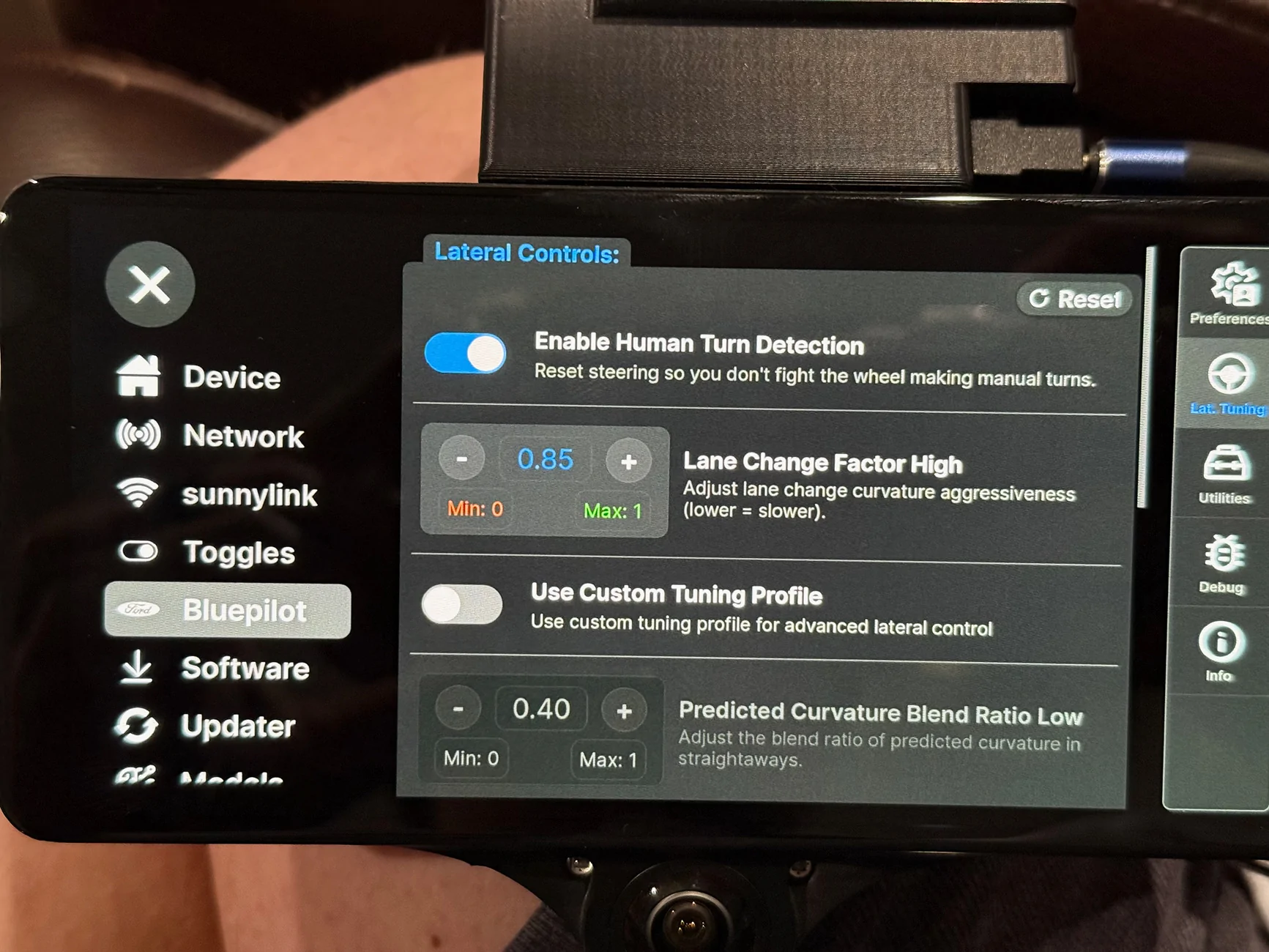

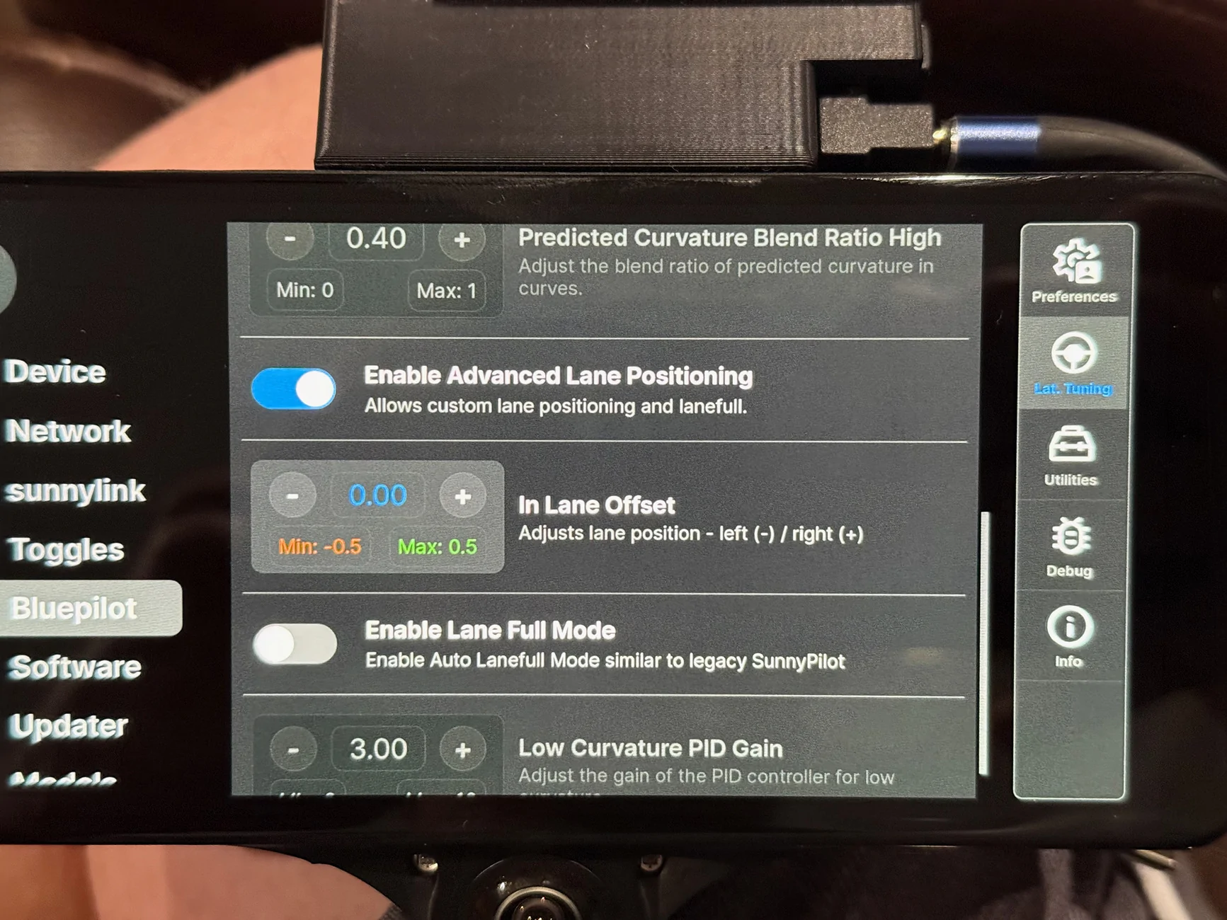

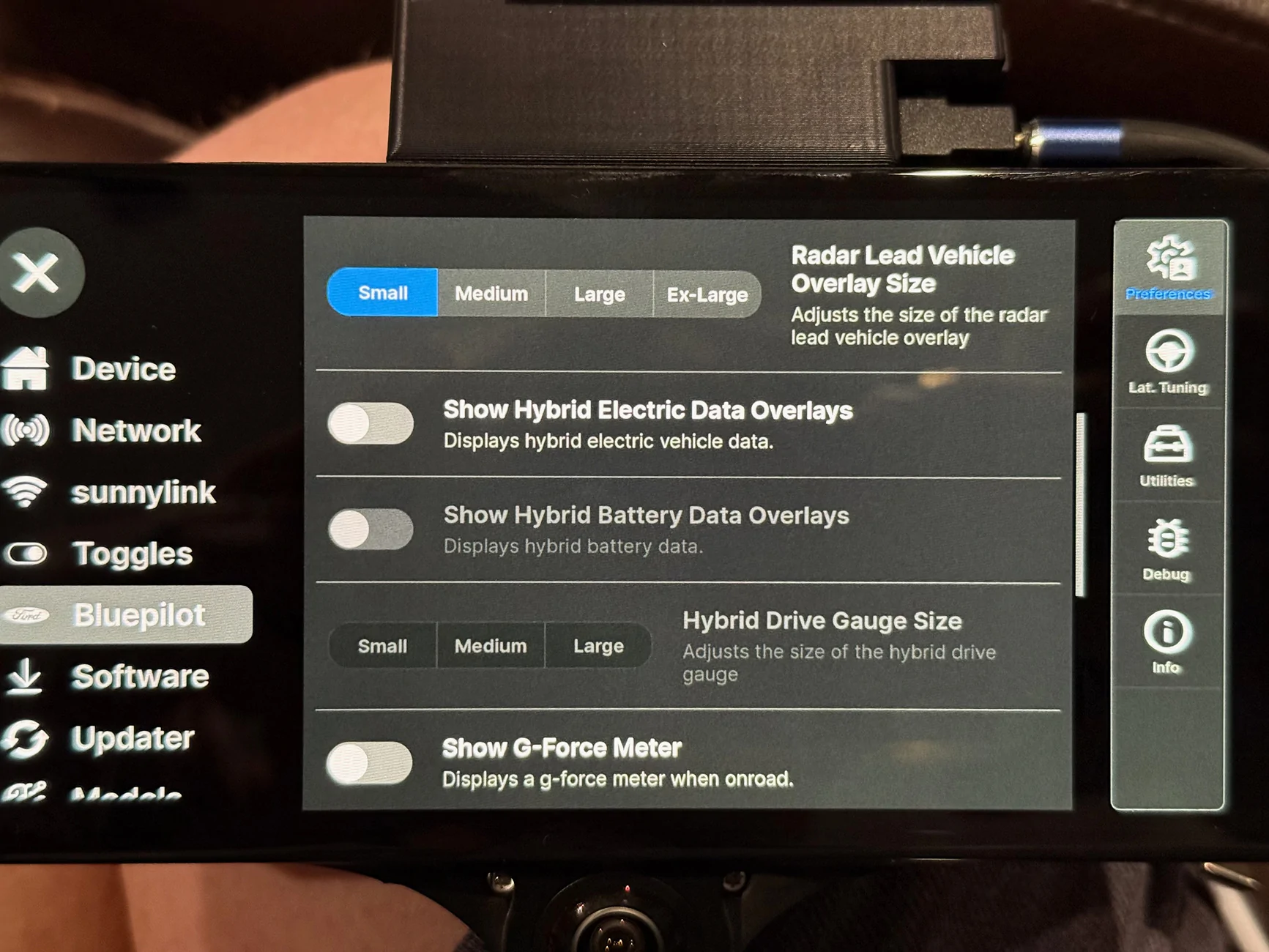

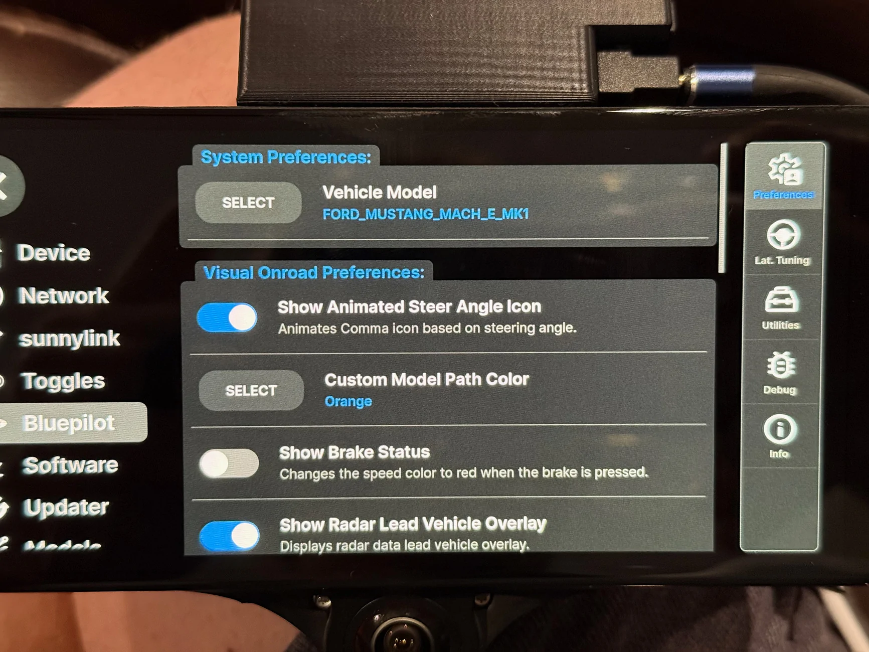

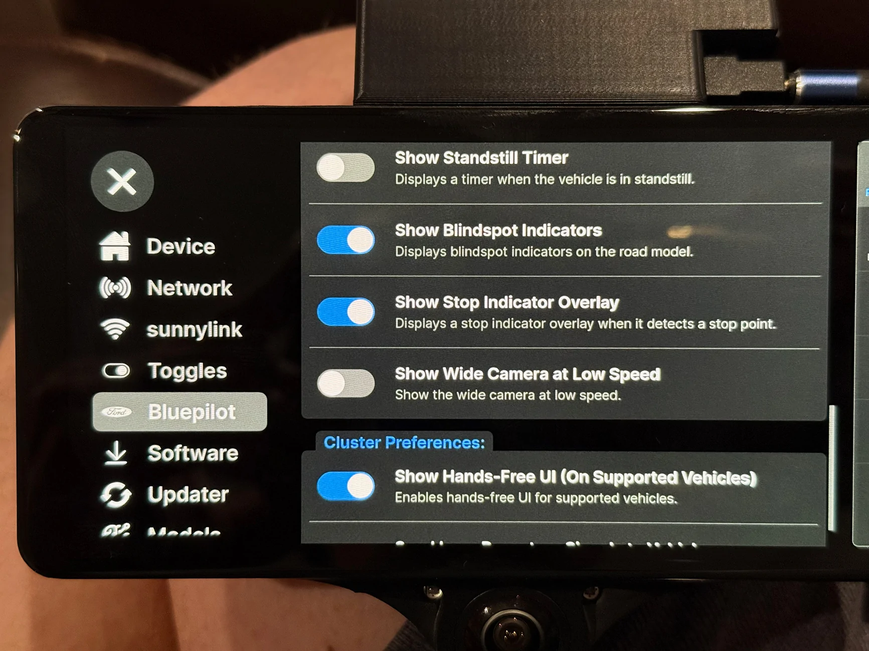

I've attached the photos of my settings. All of my settings are default except I changed model path color to orange and I turned on the settings that make it look like bluecruise.

turn off advanced lane positioning. Let’s see how things change.
Will do, I'll report back tomorrow morning after my drive to work. I'm not able to test it out tonight.

Glad you are able to recreate what I am seeing. Turning off the advanced lane positioning setting did help a bit this morning on my drive to work. I was able to take slightly sharper curves but it did still give me a bunch of the "turning exceeds steering limit" warnings that I never did get on bp-2.1. The ping ponging on straightaways did seem better too but not completely gone. I don't know if this is related but the comma kept freaking out and throwing "radar error: restart the car". It would make a ton of noise then just randomly go away, then come back again in 10 minutes, then go away.
