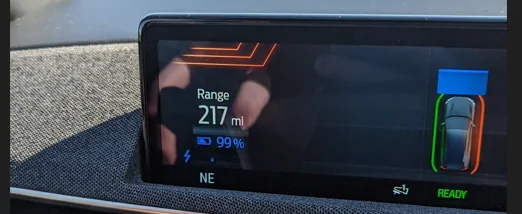

A couple of us who have intelligent range enabled have noticed a bug with range numbers. I figured I would post it here even though I have also notified the EAP team of my findings so that others with the same issue have a place to talk about it.
What happens:
You charge to 100% - It has to be 100%
Range on the car shows a higher number
You drive 100 feet
Range drops by 30-50 miles
You continue your drive in disappointment
Note: This adjustment happens without in vehicle route planning. Additionally, the temperatures in my region are not fluctuating and no other environmental variables are shifting from day to day. Lastly, we have only seen this happen at 100% charge, all other charge numbers are unaffected.
Examples:
From my experience yesterday:
100 % = 247mi
99.9% = 217mi
From @benk016 experience today:
100% = 260
99.9% = 214
