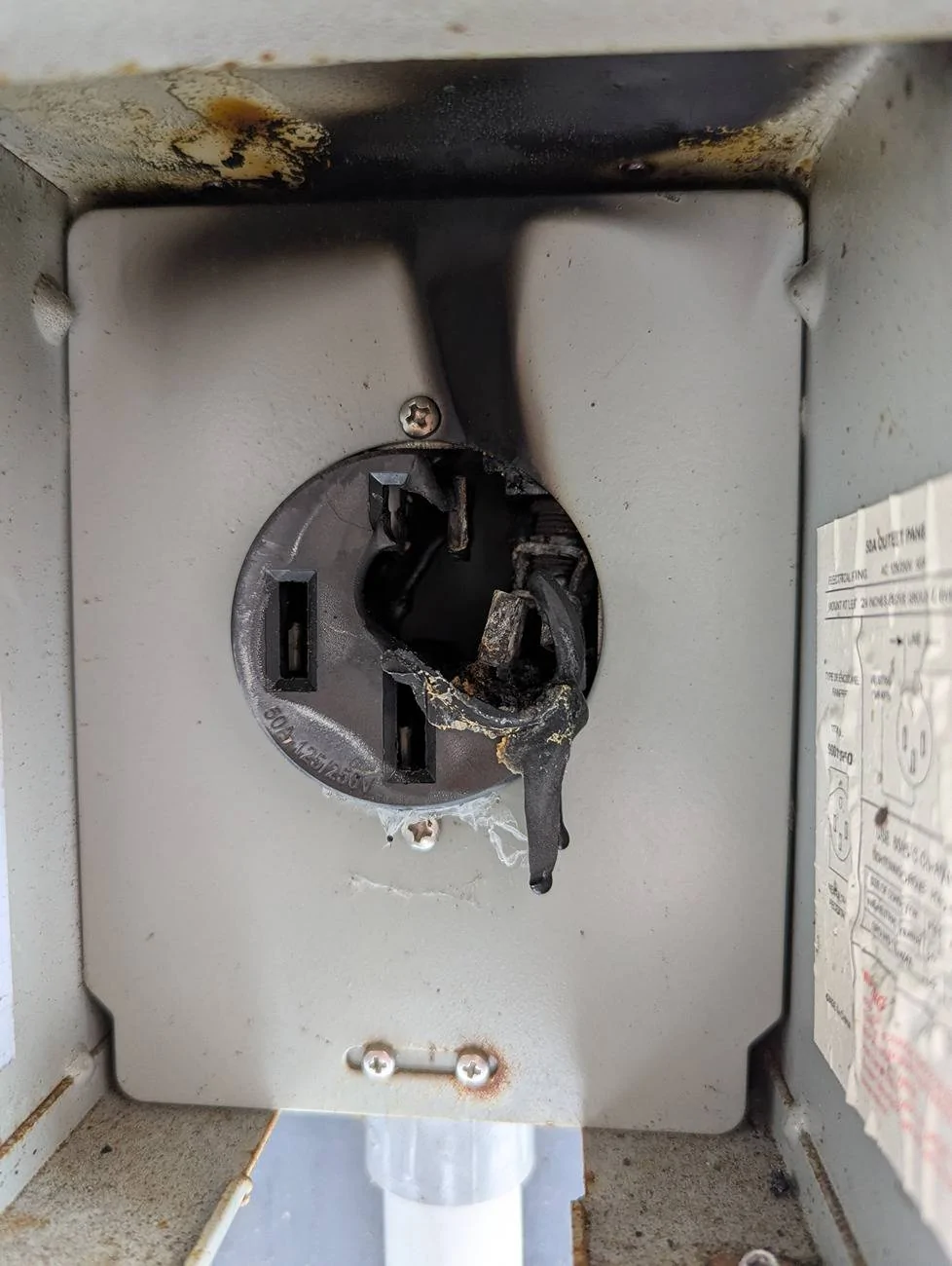

Inside of the EVSE looks ok, but the plug is toast. The plug has snow on it because it was outside of the NEMA 14-50 enclosure overnight.

Secondarily to this, I noticed that our Grizzl-E's status light was no longer on. Took a look at the NEMA 14-50 outlet and found THIS. Could the MME do this??? I have not yet opened up the Grizzl-E to see if the insides are intact. This did NOT trip the circuit breaker.
That was caused by using a cheap outlet. You’ll need a new outlet and cord. Bad electrical can cause charge faults.
