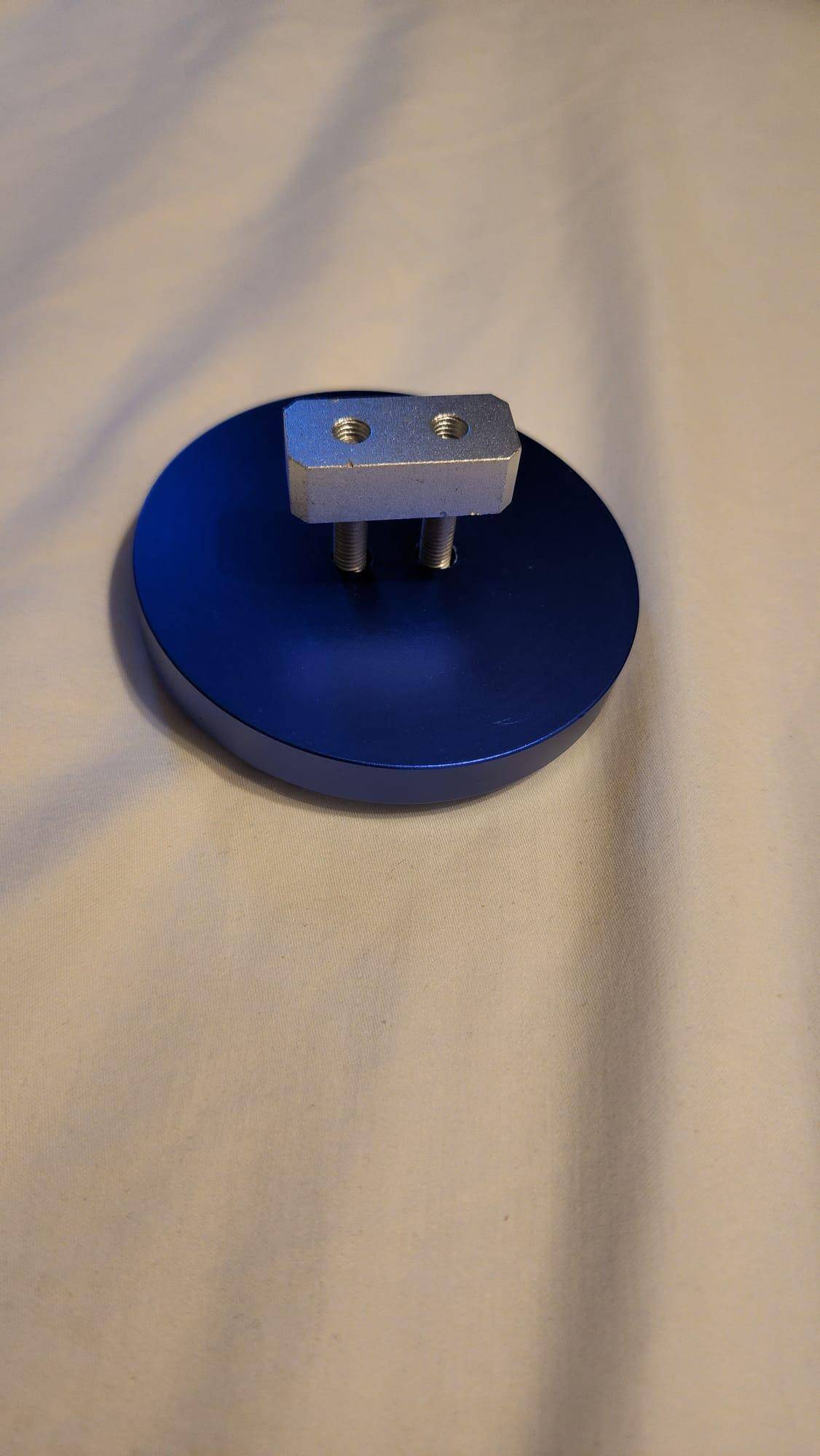

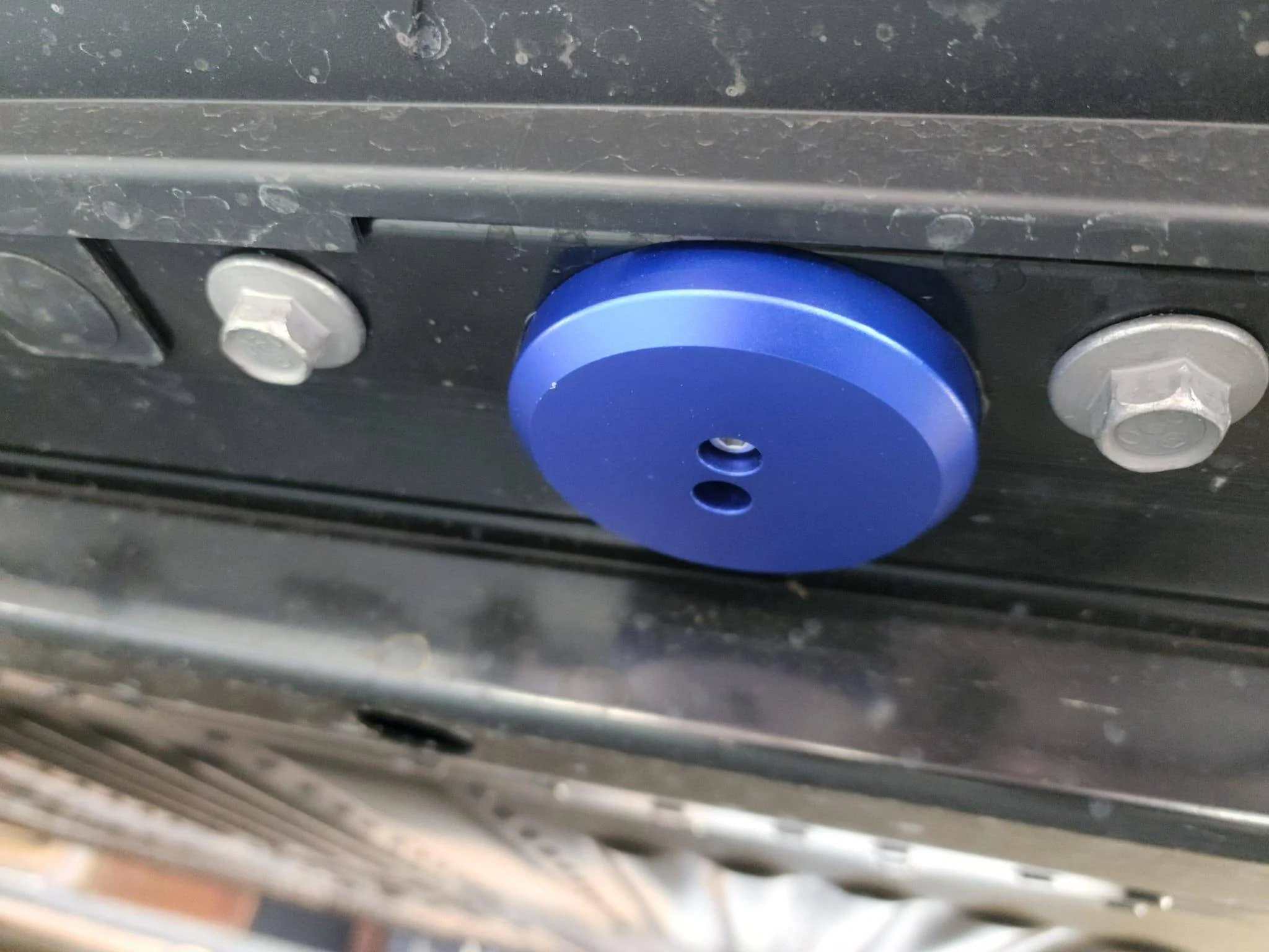

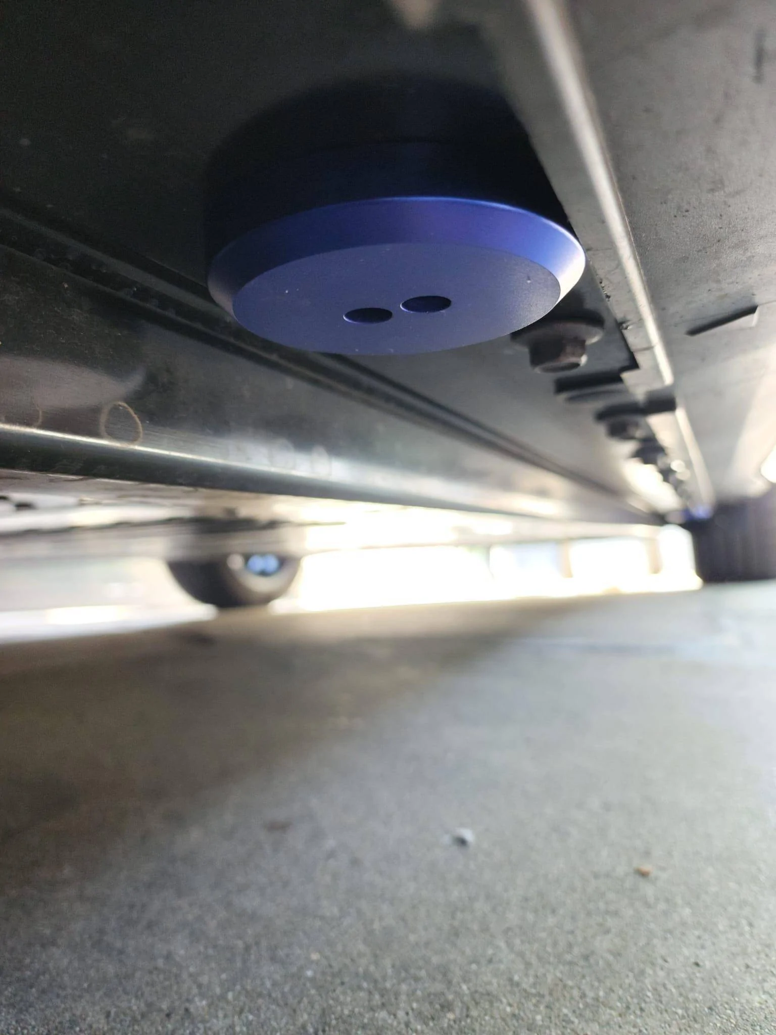

i use these corvette pads. due to how the holes area are, i can only use 1 screw just so i can shift it over to the side more. I did add some goop automotive glue to help secure it down. so far no issues, but i have only jacked it once, and not like we do much under these cars compare to ICE

Is there any reason that you couldn't drill and tap the other hole

Didn't want to drill. Figured i wouldn't really get under car much, and only jack it when changing tires.

Just installed, this worked great! Before I got my car I saw these online and was hoping this would work, and then I found your post confirming.

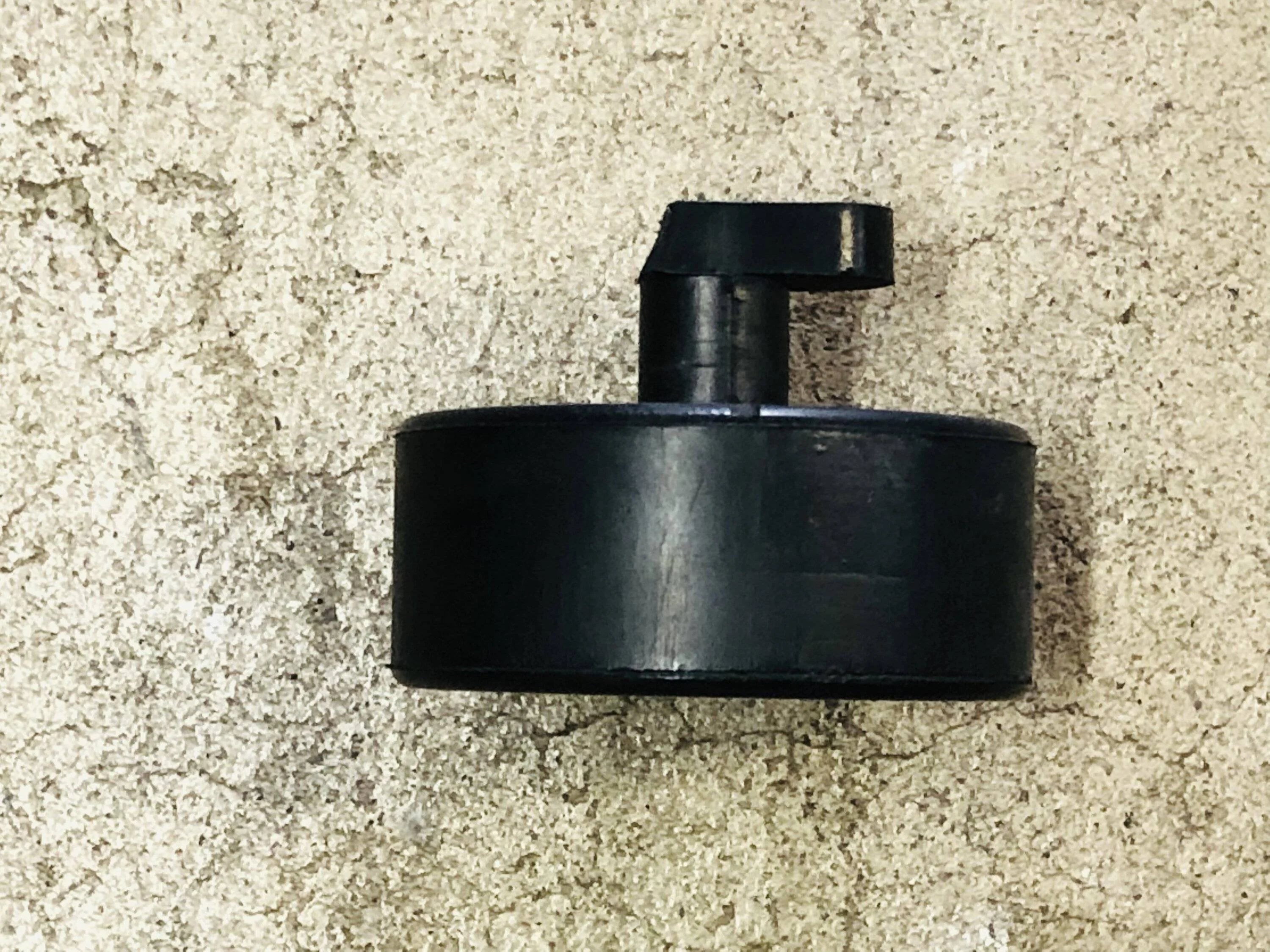

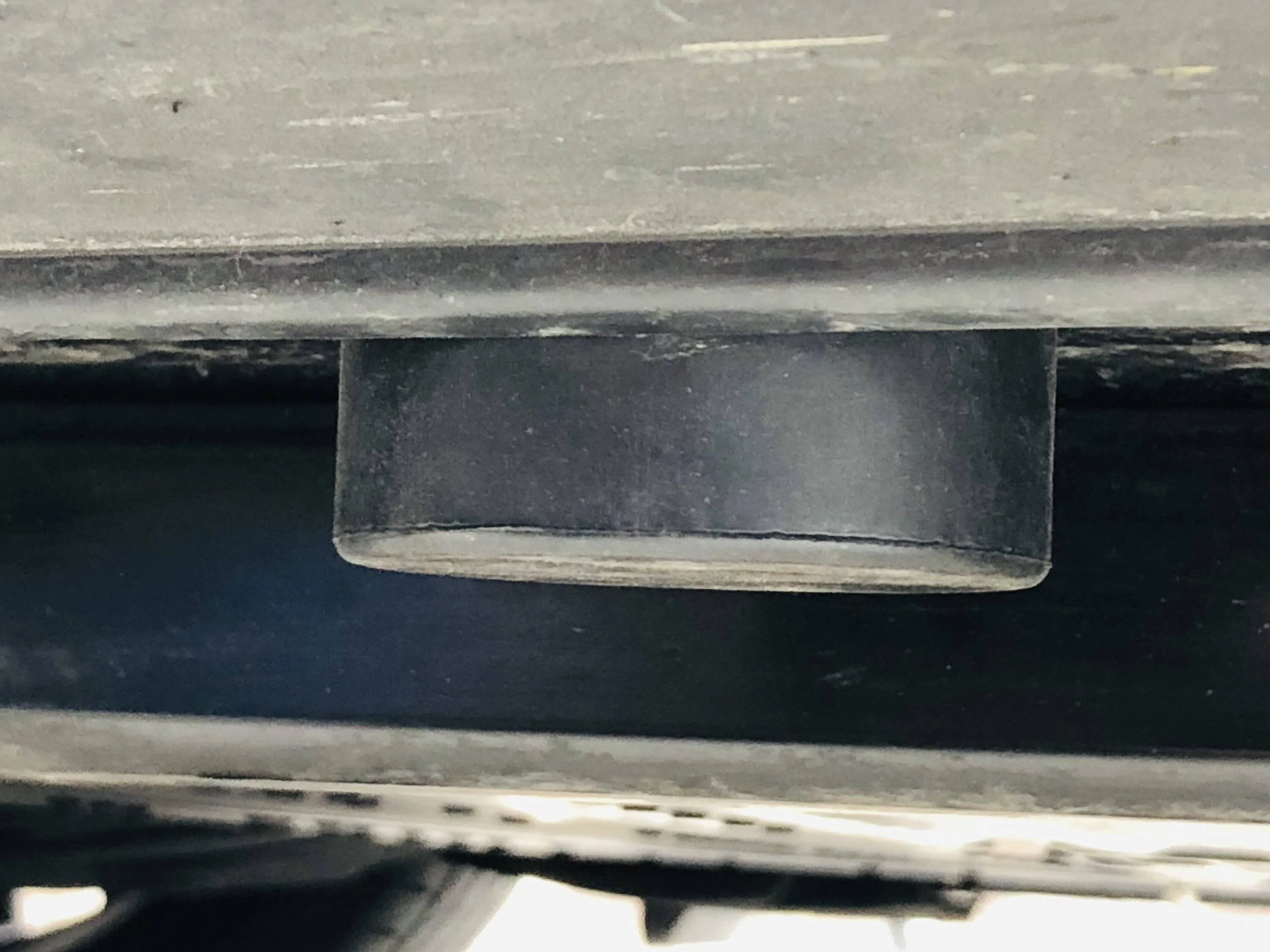

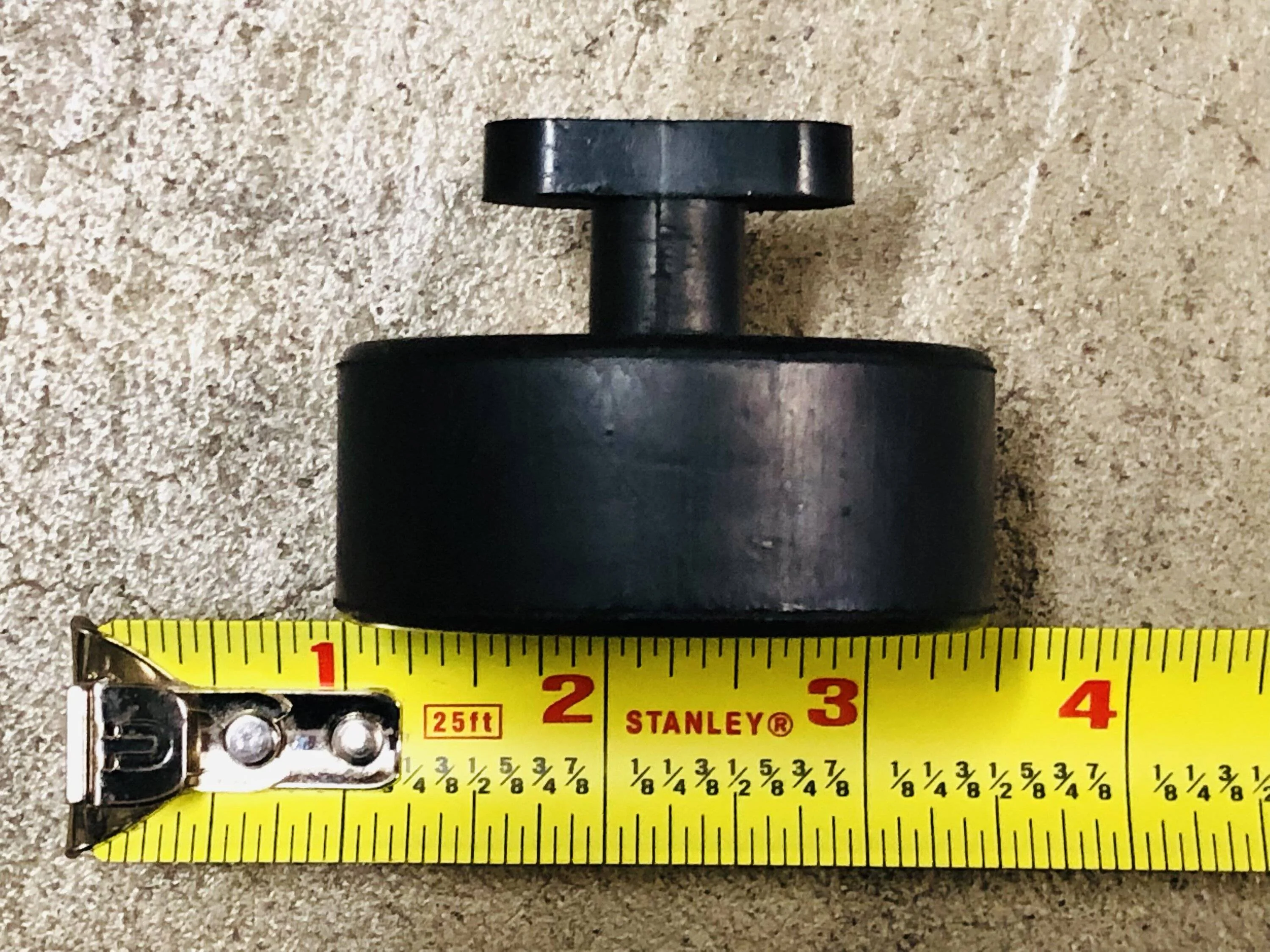

I am using modified rubber Corvette pads. They don’t stay on permanently. I keep them in a bag under the cargo floor. 😊🐩
Ford Mustang Mach-E Jack Pads for the Mach E? 8D27DD81-F87A-405F-AE4D-50ED47E9AB00
Ford Mustang Mach-E Jack Pads for the Mach E? 568518BC-8B2F-41F3-A9E4-FAB5809CCAD1
Ford Mustang Mach-E Jack Pads for the Mach E? 4E7E576A-A639-460D-8CE2-5AF1F0C14C4D

Where did you get them Amazon?
edit: I see several on Amazon , are they sturdy enough for the weight of the car. MME is much heavier than Vette or Porsche

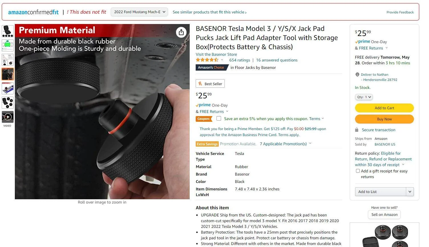

I used the ones that fit the Tesla and were on this thread. You need to cut them a bit to fit between the rails. Getting in the holes on the front of the car is very tight but the rear holes went right into place. You can lube them or just cut the peg a bit with a knife so they fit in the holes. I chose the latter and they fit in great. I have had them in for months and they are still there and holding firm.

I really only jack the car up twice and no problems so far.
