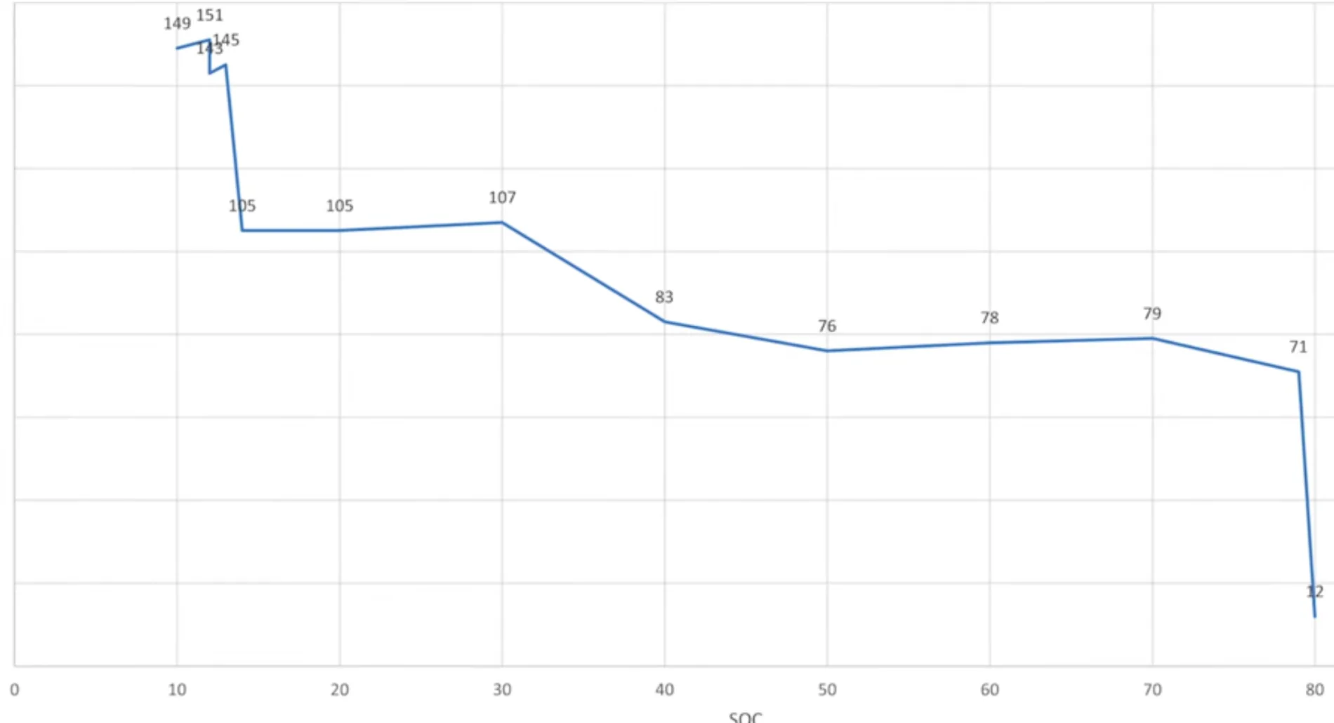

I understand. And I was not referring to P&C in this case - Kyle was not using it too. It just that even without P&C when charging is uninterrupted, the charging curve is close to being unacceptable - for 88kWh battery to be charged most of the time at 75kWh? It just not competitive and humiliating - there is no way the car will be widely accepted with that kind of charging curve.

Ah, I didn't realize what the "issues" you were describing were. Yes, they need to add battery preconditioning, but "most of the time at 75 kW" (assuming you didn't mean kWh) is not normal behavior either. Happily the Mach-E's current markets are entering summer now, giving them time to fix this before winter.
When the battery is warm, I don't see 75 kW at all. The 80% cliff hits at ~80 kW.

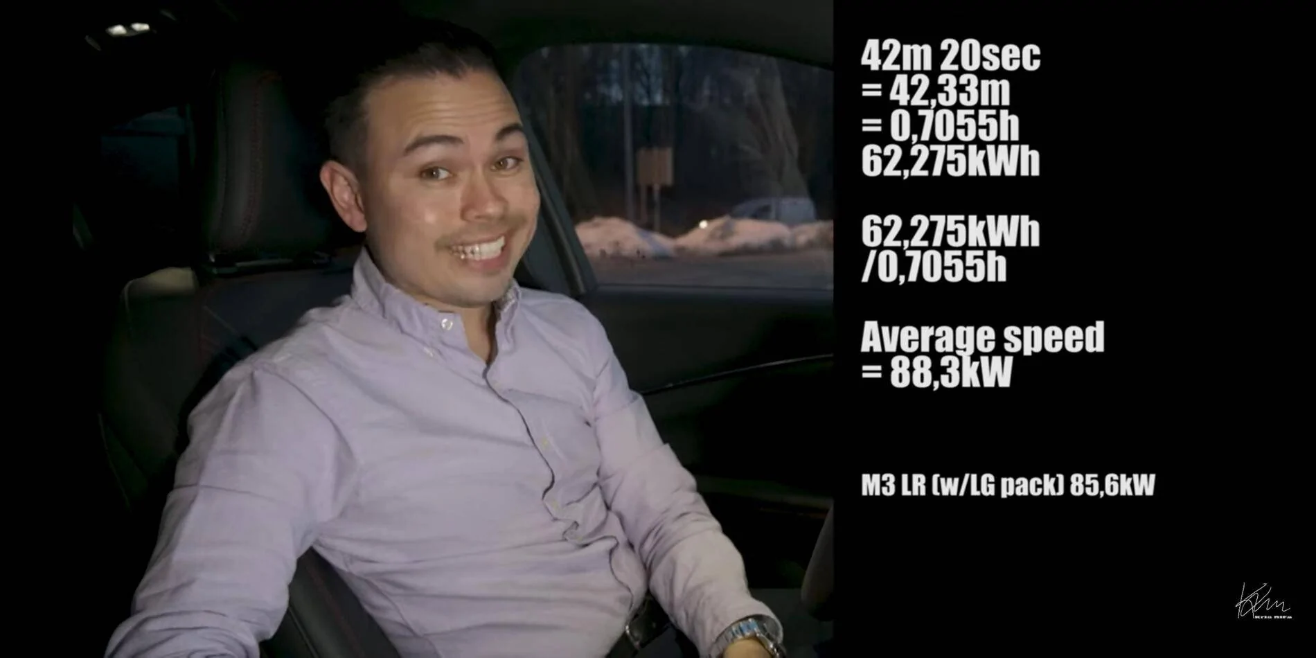

Kris Rifa in Norway had a good analysis of the charging profile. Going from 8% to 78% in 42m 20s with average power of 88.3kW.
From what I've learned, it goes from 150kW->100kW->80kW on basically a timer system to 80%.
On paper at least, it seems to me on a road trip with the right charger spacing, you can maximize your road time by going from 100% down to 40-50%, recharge for ~20 minutes to get back to 80%, then drive down to 10-20% before taking a 30-40min break to get back to 80% again.
100% -> 40% = 150 miles
20 minute recharge
80% -> 10% = 150 miles
40 minute recharge
