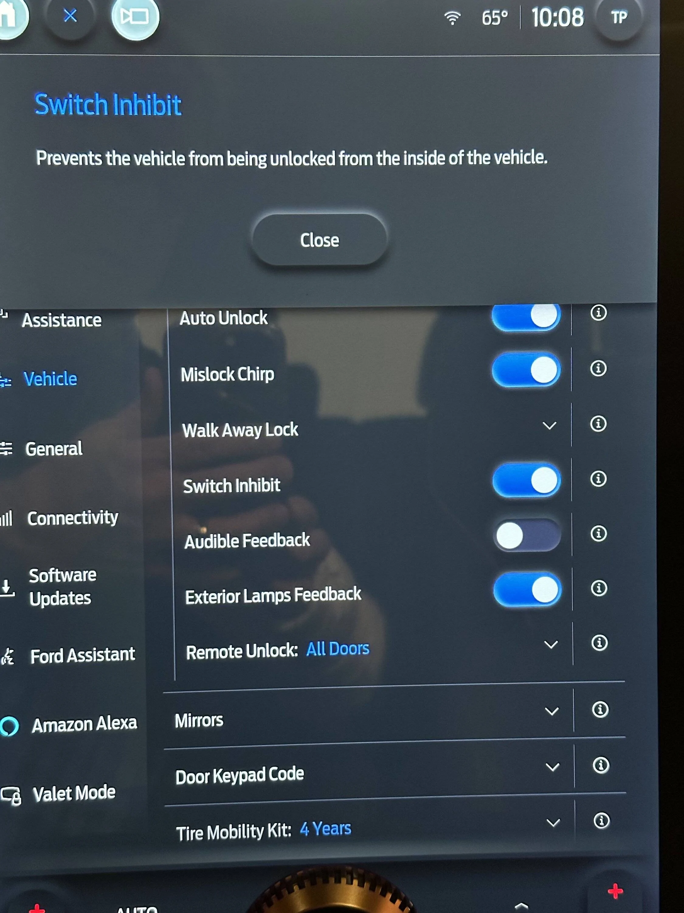

There is a setting called Switch Inhibit to prevent the doors from being opened from the inside when the car is locked externally. If you were either using Paak and it failed, or a fob and the battery died, such a scenario is theoretically possible. And of course eventually the motion sensors kicked in and caused the alarm.
Ford Mustang Mach-E Locked-In IMG_8546
(Admittedly I'm grasping at straws)
Oh, and there is no mention of it in the 2022 Mach E manual ?

Yeah, Switch Inhibit just disables the power door lock button. Pulling the rear door handle twice should still manually unlock the door. But that won’t override the child lock if it’s enabled. That doesn’t explain the alarm going off though. Must have been a combination of things.

Hmm, never heard of Switch Inhibit...interesting. I keep learning new things about this possessive car. But I did yank on those door handles like a maniac, and nothing. All four were locked. I'd just enabled Paak for the first time two hours earlier so maybe this was the issue after all.
Kinda a silly feature then. I had thought the purpose was to make it more difficult for steal the car (or stuff in the car) since breaking a window wouldn't give access to opening the doors, but I guess not...
