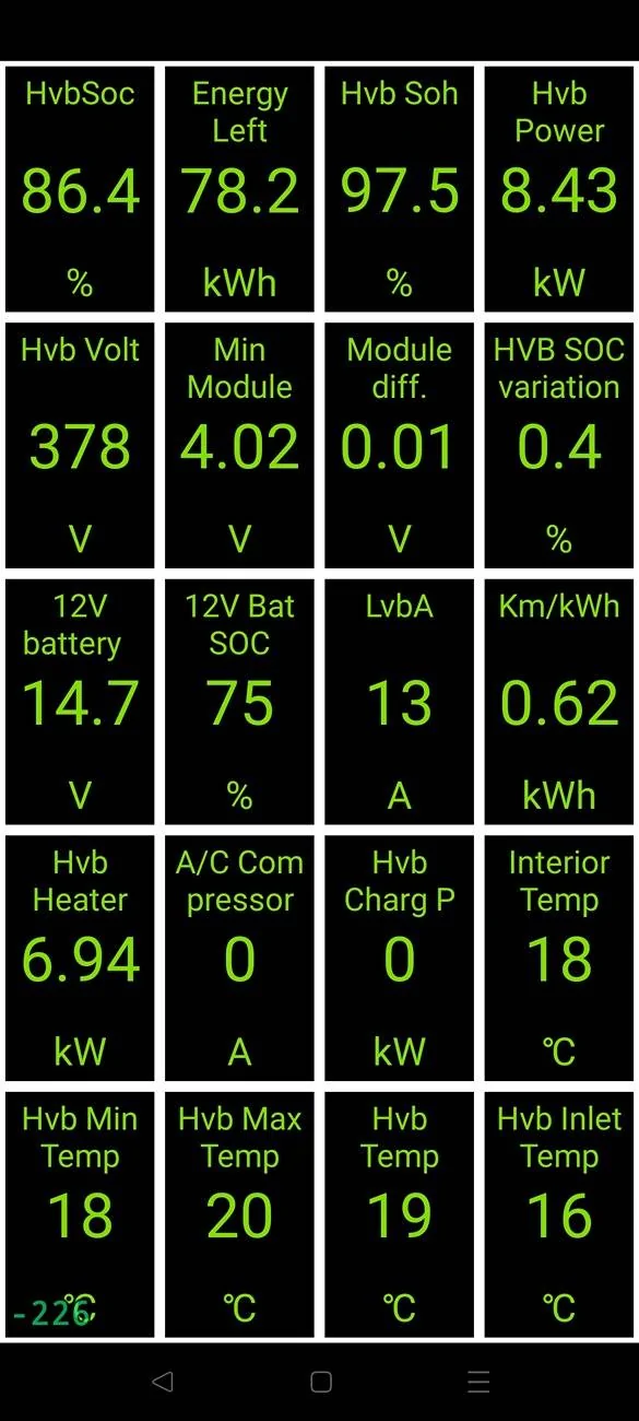

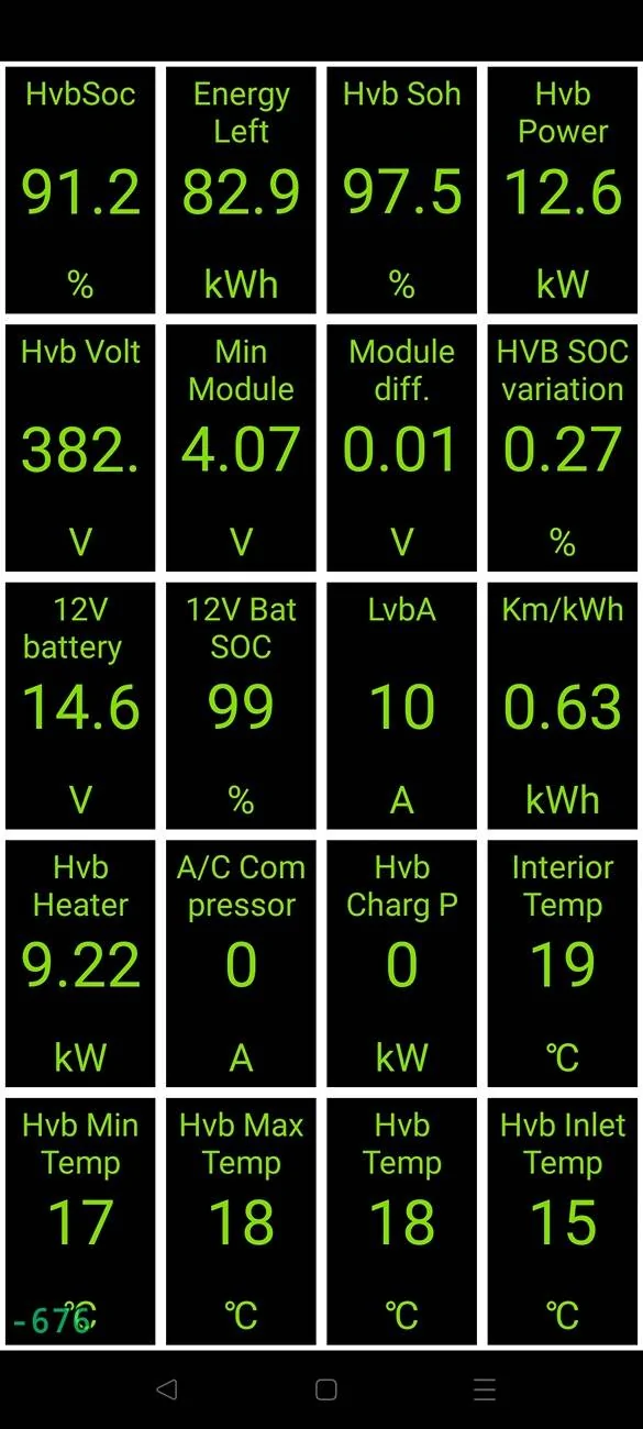

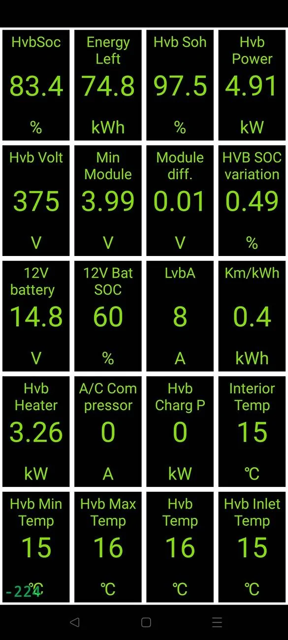

This is a day between.
Had to use an external charger to get LVB up to 99%. So it goes down fast, and it will make the LVB battery bad in record time

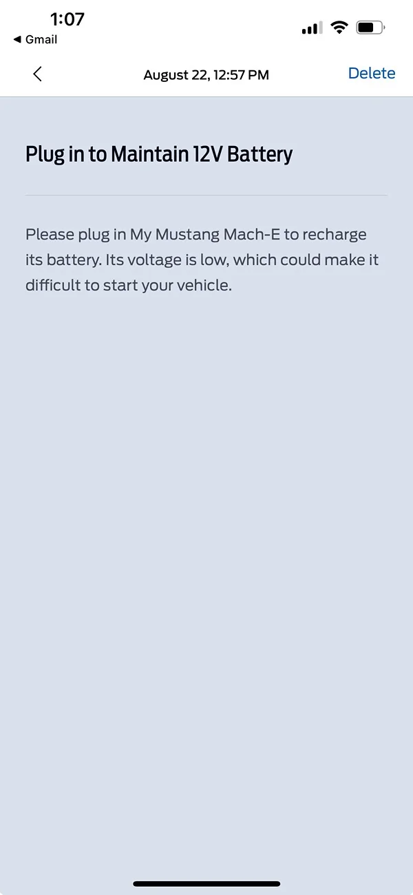

I have a 2021 MME with 38,000 miles. I plug it into my home level 2 charger whenever I am not using the car. I get this error message about once a week, so often that I now ignor it. I have brought the car to the dealer about 5 times now and asked them to look into this. Each time they say they did a software upgrade to fix it, then I get the same message a day or two later.
I love the car and it runs great, but these messages are a bit anoying. Does anyone know how to fix this?
