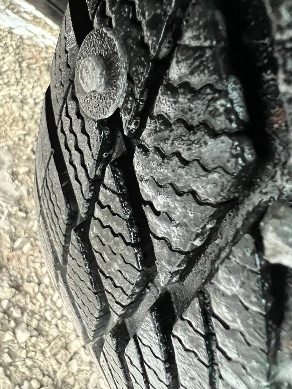

I definitely got a warning at 19 PSI this morning. And it wasn’t because it was 9° F in the garage. Though that did make plugging this more difficult.
Ouch....at least you were in the garage at that temperature.
