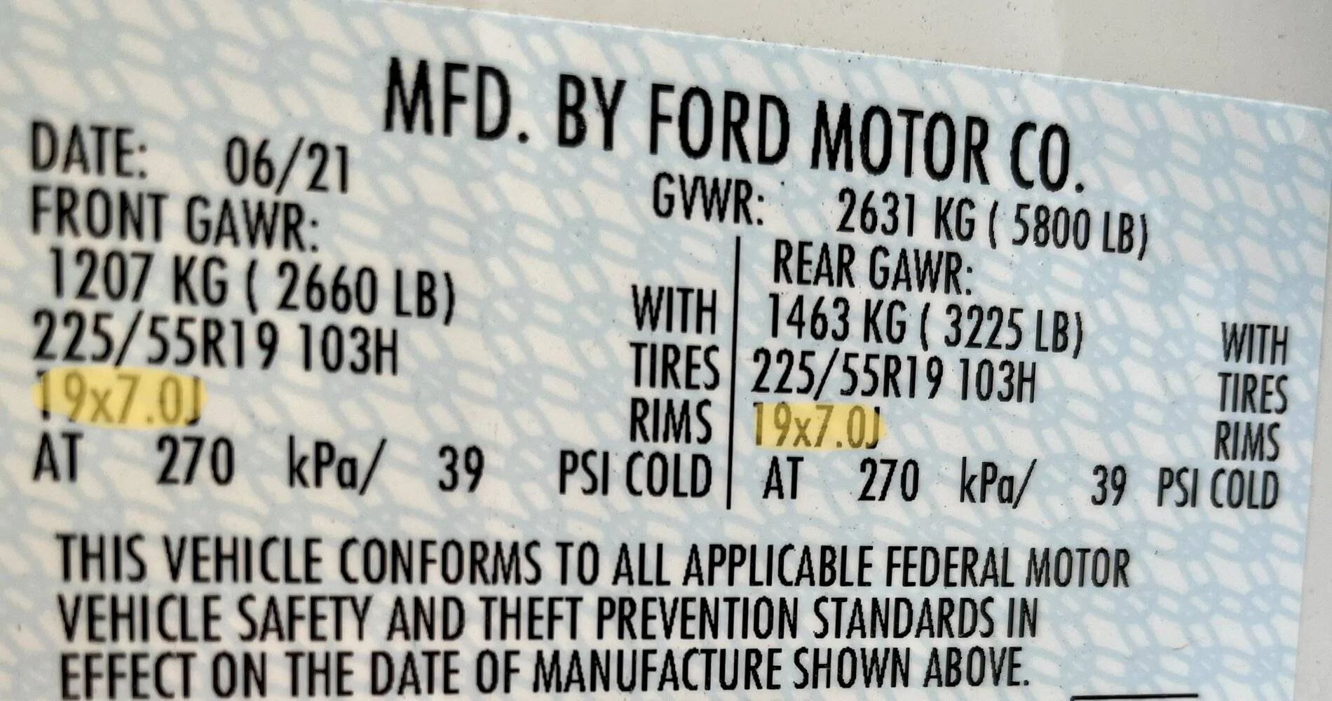

For the Select, Premium and Rt1, the answer is easy - the door stickers clearly shows a 7.0” rim. Here is my sticker from a Premium AWD:
Ford Mustang Mach-E Mach-E 2021/22 Wheel Sizes, Bolt Patterns, Offset, Center Bore, Load Rating, GVWR [Table] 070C2D67-6A29-4C1B-B969-8F40704DED29
For the GT and GTPE, I’m going off of various literature from Ford showing the 8.0” rim width, but I don’t think we have a measurement or a door sticker or otherwise 100% proof yet. I’m also still waiting to learn the offsets of the GT and GTPE wheels.

You're awesome, thank you! The door sticker, of course. Not just for tire psi
