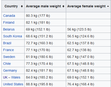

I put together a pretty basic acceleration model and was able to match the Ford target of 0-60 mph with 1 ft roll out by adjusting the test mass just slightly. See attached. The modeling of a higher performance GT model gets a bit tricky due to traction and traction control. Has the curb weight of the GT been published?
Edit: I have added the calculations for the RWD here
