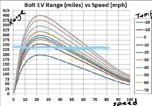

Here's an interesting chart that is a great visualization of how speed and temperature affect the range of a BEV.
This is for a pre-2020 Bolt with an EPA range of 238, 3.9kWh/mile.
Very good, thank you!
