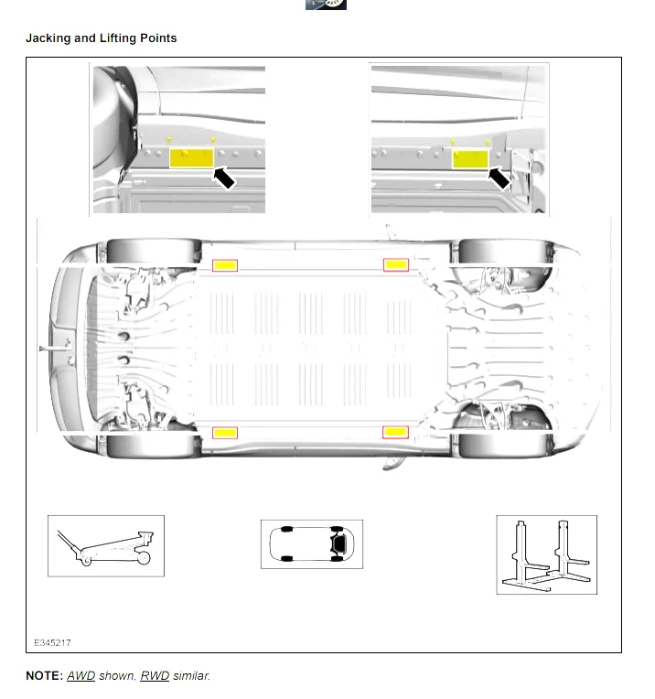

Jack up at the appropriate jack point:

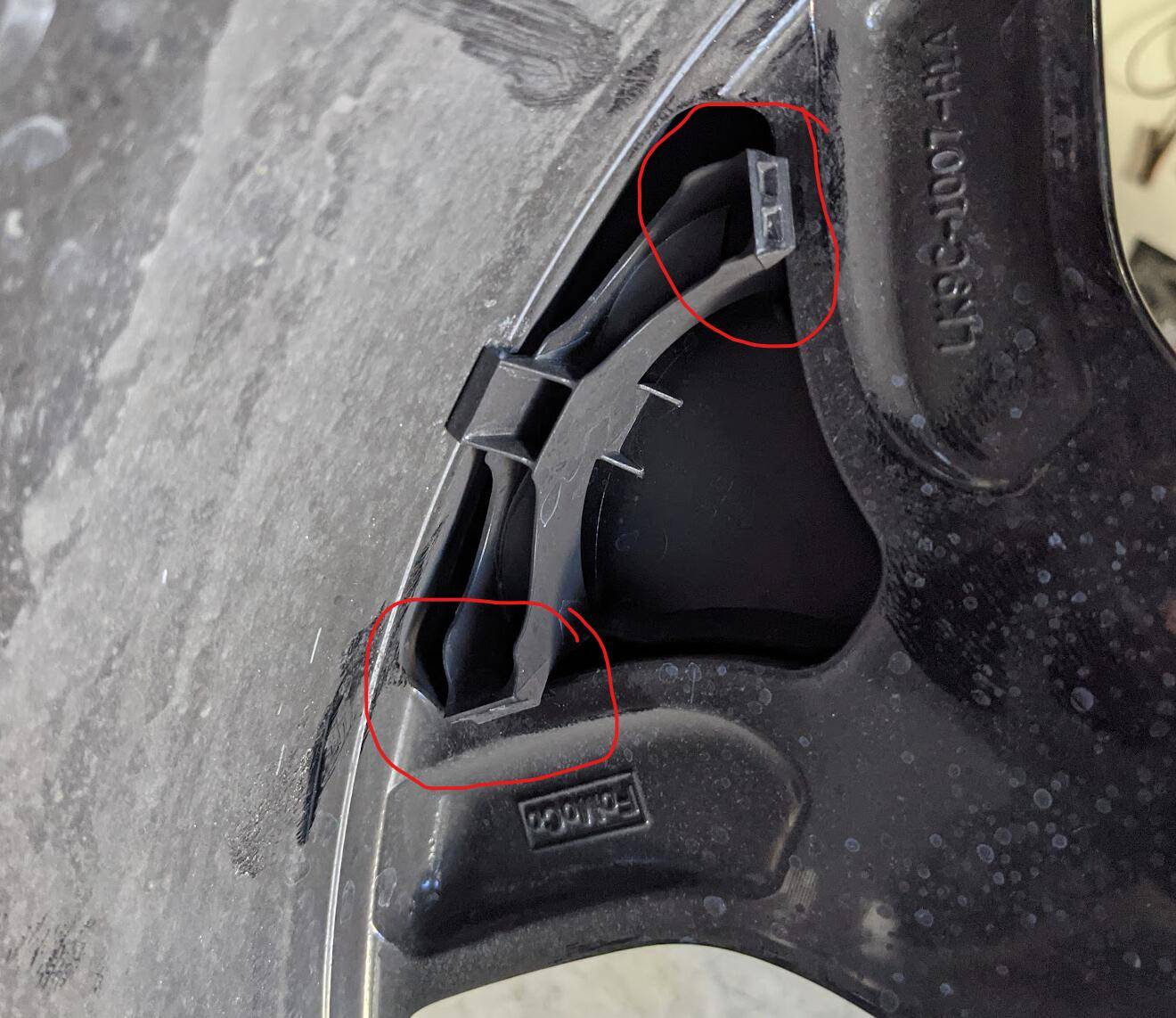

Cover is best removed from the back. Each fin of the aero cover has 3 plastic clips. DO NOT USE TOOLS. Likely to break or damage the finish of the wheel. Take your thumbs on the side clips and gently push each one in to pop the fins loose. Then the whole cover just pops off from center cap.

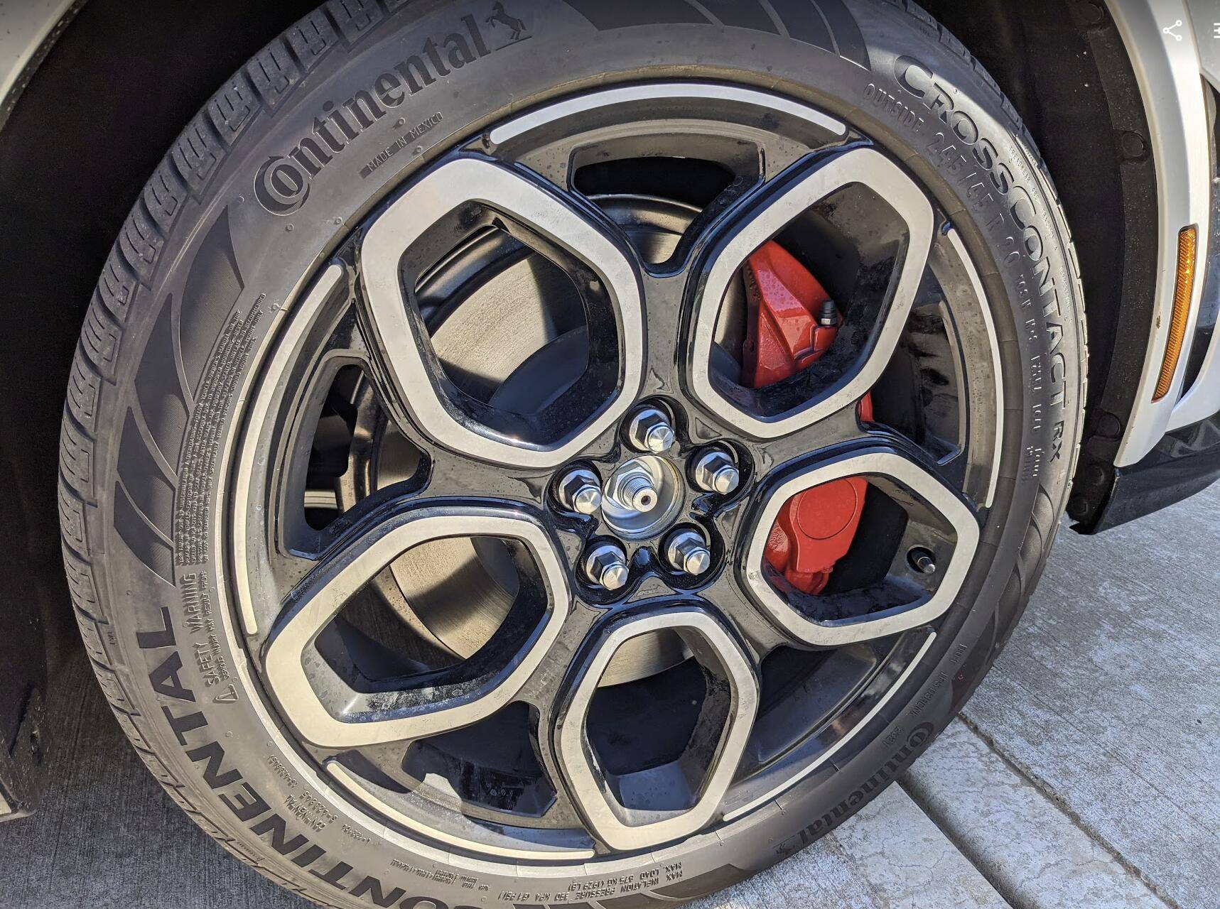

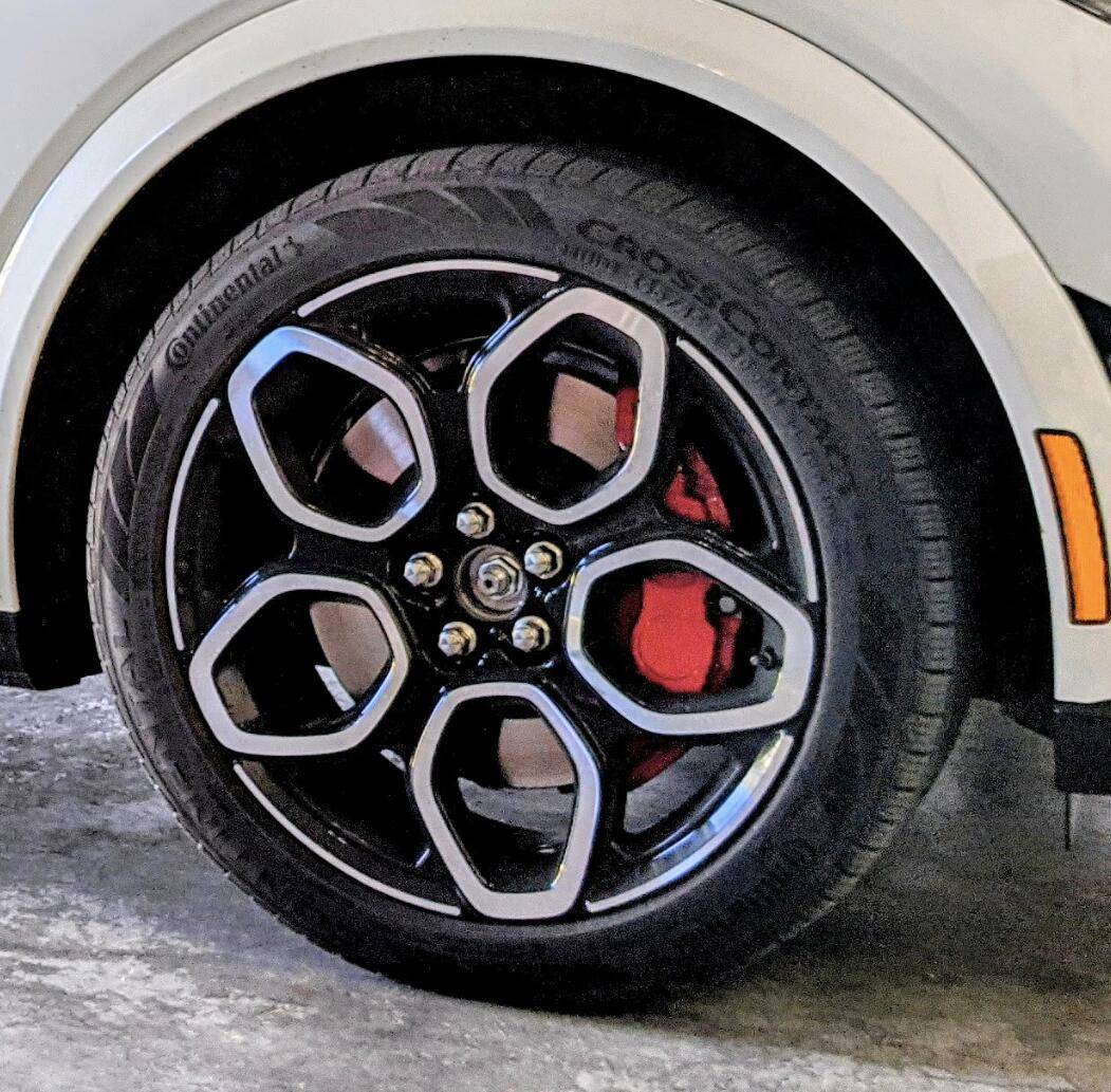

With cover, for comparison
Center bore size: 63.4mm

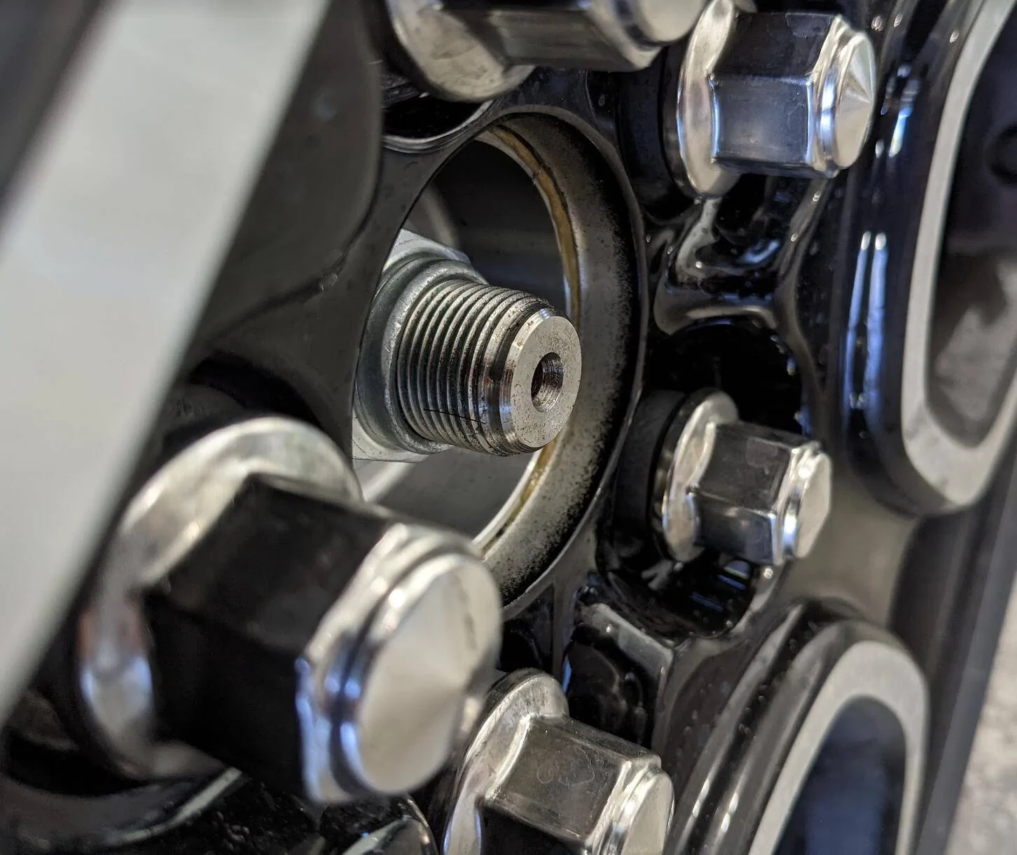

The issue with the Center cap will be there needs to be 5 or so MM more depth to the cap than conventional as the Axle pushes out past the wheel. The hub also pushes further into the wheel than conventionally so the ID of the center cap may need to be specific to this wheel. Going to be tough to find a compatible match.
