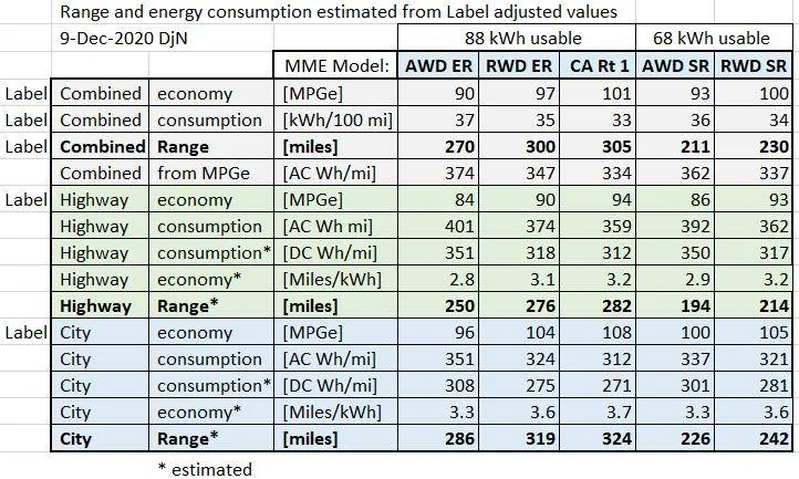

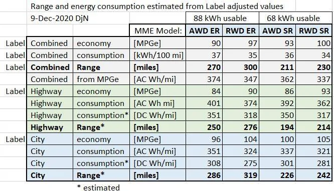

MPGe is AC energy from the grid to recharge the vehicle including parasitic energy losses, and is based on 33.7 AC kWh/Gal equiv.
Range is determined by the DC energy available from the battery system (also including other vehicle parasitic power demands).
The relationship between the battery DC energy discharged and the AC energy recharge is referred to as the charging efficiency, and can be estimated or derived from test data.
See also https://www.macheforum.com/site/thr...aled-in-window-sticker.2064/page-3#post-60907
Edit 12 Dec 2020
Added California Rt 1 sticker information, and also economy in Miles/kWh.
