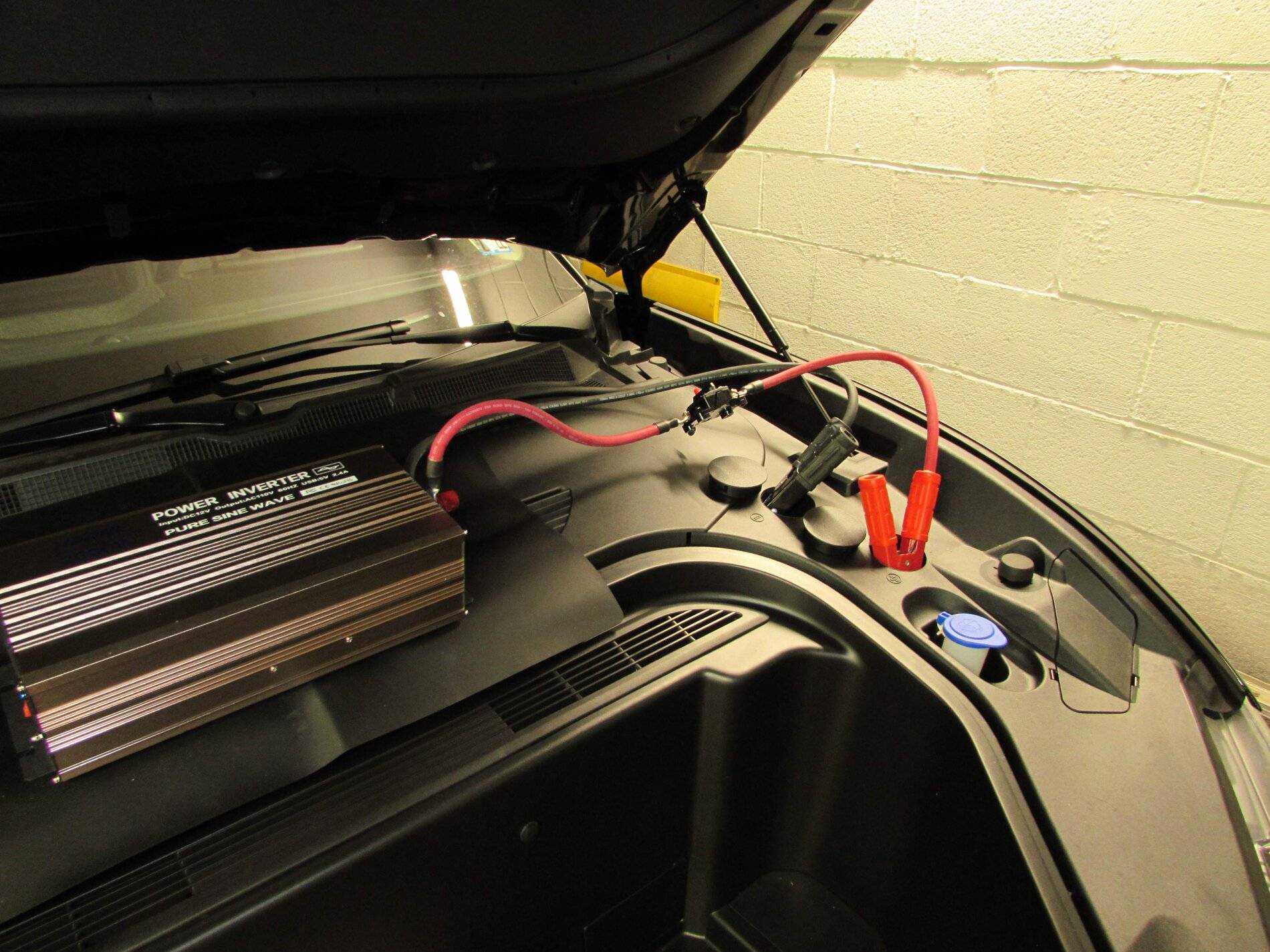

I just installed a small transfer panel to switch a few critical circuits, i.e., furnace, refrigerator, Wi-Fi, TiVo, TV. These pull a maximum of about 1500 watts continuous. The Mach-e provides power from its LVB via a 2000 watt inverter. The HVB keeps the LVB charged while the car is totally off. Coincidently, we had a two hour power failure last evening which interrupted our TV viewing for only 10 minutes...the time it took to plug-in inverter, etc.
Inverter System Equipment Costs:
$360.39 Huntkey 30 Amp 6 Circuits Transfer Kit
$190.01 XWJNE 2000W Power Inverter 12V to 110V Pure Sine Wave
$ 70.98 2awg wiring; 150 amp switched inline fuse
$ 13.77 Linkstyle 1000A Pure Copper Jumper Cables Boost Clamps
$ 8.92 Camco (55165) Heavy Duty RV Dogbone Electrical Adapter
Available 50' 600w (14amp) Heavy Duty Extension Cord
$644.17
