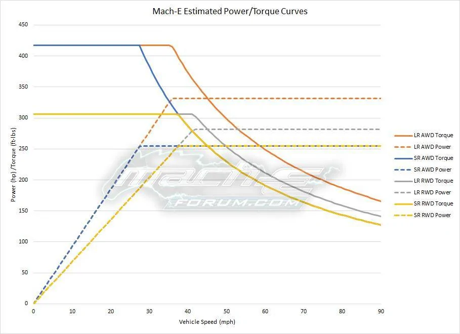

Updated with good explanation and graph by @Scufflegrit
I graphed the info we know. It assumes flat torque until the peak power is reached, and then it assumes power remains constant. This is oversimplification, but we don't know the motor efficiency curves or whether the motor power drops above a certain speed.
The vehicle speed in the graph uses the tire size we've seen on the Premium, and then I estimated the gear reduction (Ford provided a range in one of their interviews). Around town at low speeds the AWD's will be the liveliest independent of battery. At highways speeds though the battery choice comes into play and is probably due to the additional current that can be supplied by the larger battery. The standard range models probably won't be too exciting on the highway.
