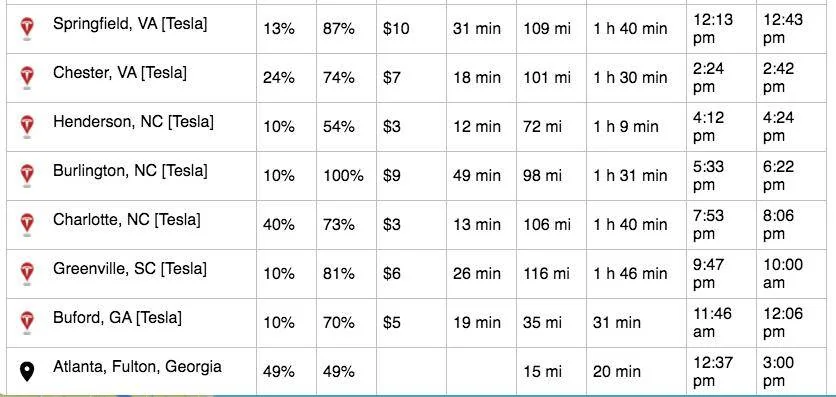

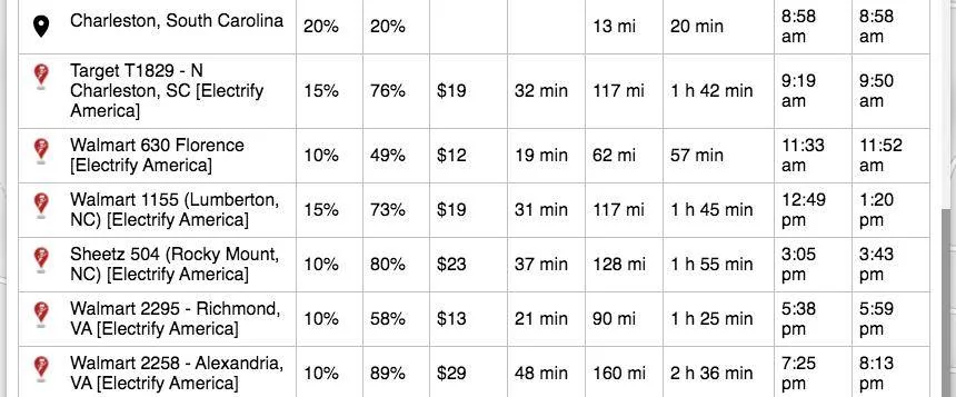

Hmm, your analysis doesn't seem right and I think your suspicions are off base for a few reasons.Theoretically, yes. You've run the last 3 legs down to 10% battery, which is ideal for squeezing more recharging miles in faster. But finding charging stations at those points along the route might be tough. I suspect most routes won't have stations spaced so well, thus stops with 20% or 30% left will be more necessary. Which could mean adding an additional stop, and taking longer to charge since you can't get down into that sweet spot of the charge curve as often (where it charges fastest).
Plus the more charging stops you add, the more likely they won't all be right on the interstate. Might have to add an extra 10 minutes each way off the interstate to get to that EA station at a suburban Walmart.
And of course you need to make sure there's a charger at your destination (preferably L2 overnight) to get up to 100% for the return trip where you repeat it all again.
I'm not trying to nitpick it per se, but a lot of routes are going to be less than that ideal. I suspect that 1:15 of extra time could easily grow to 2:30 on a less perfect route.
