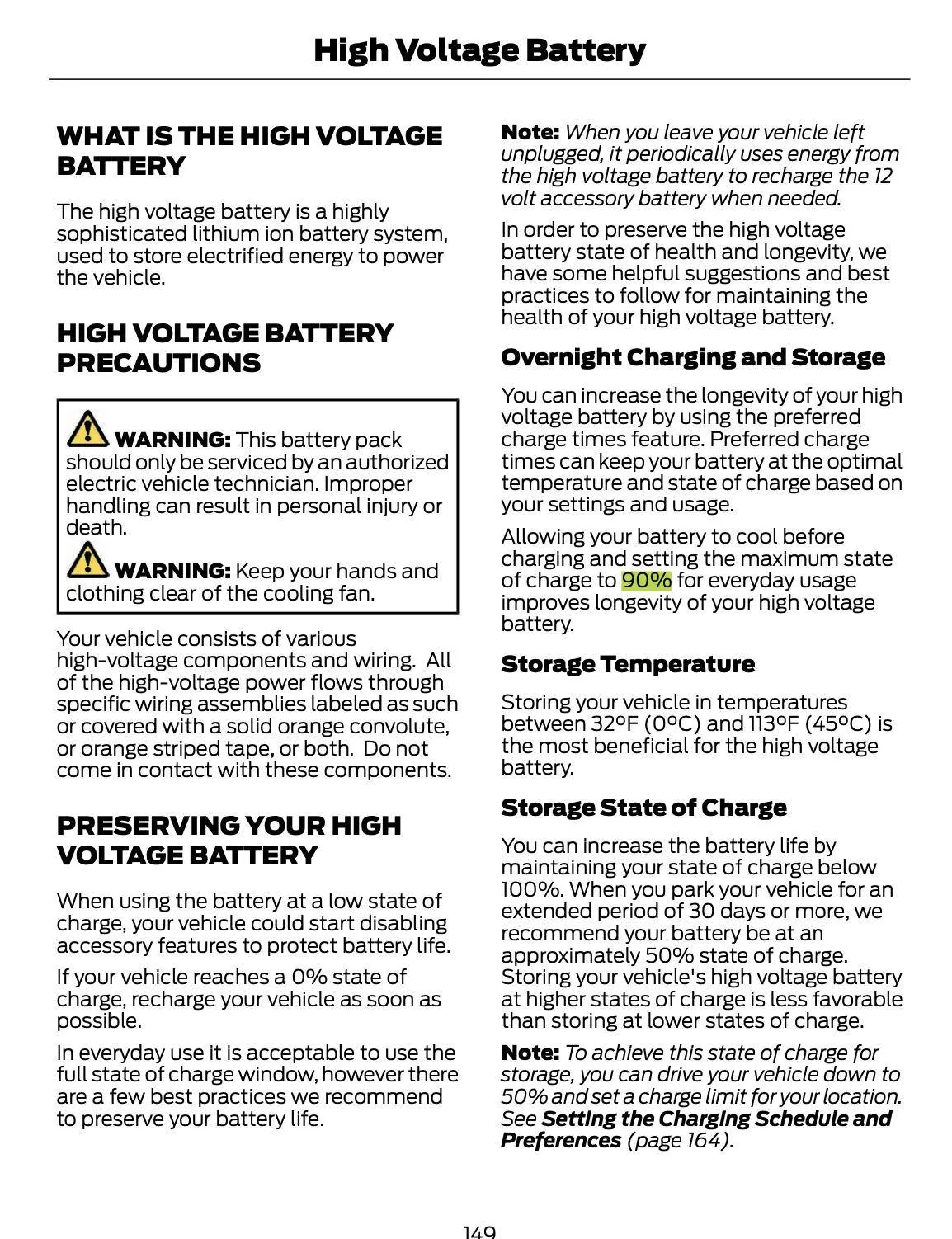

I'm pretty sure the battery packs have enviro cooling internally.... AND they are fine anywhere below 120 deg F. Unless you've seen some warnings for charging at temps over 100 deg f? Most chargers I know of have temp sensors in the battery case, and will reduce current if temps are too high.Because summers in Arizona (Phoenix) are HOT. So I would want to wait until it's below a 100°.
