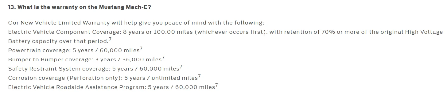

I have a 13 Leaf, and charge at home most of the time. I decided to keep it at 110V slow charge to prolong battery life. The miles added overnight are enough to keep me on the road for my daily commute (yes some of us still have to go to work) and local errands. I usually stay between 20% and 80% charge. For my MME I plan to do the same, keep it in the middle most of the time. Only go up to 90%+ the night before a road trip. If you do not need the higher rate of charging, why do it. Slower charging generates less heat and stress on the battery, and could lead to longer life. We really do not know everything about the battery with this being a totally new car from Ford, so why not play it safe. Save the fast charging for when needed on road trips. I know some of you will have longer commutes or different daily needs and may need to add more miles overnight, you will have to decide what works best for your MME battery.
Here is the warranty from Ford.com
Ford Mustang Mach-E Many recent posts about installing the fastest charger and why this might not be the best approach? Screenshot (42)
If there is a problem with using a charger and your battery starts to degenerate it is covered by the Ford warranty and will be replaced.
While true, losing something like 25% or 28% (short of the warranty replacement) would be a serious disappointment. Thus part of why some want to try and minimize the degradation.
