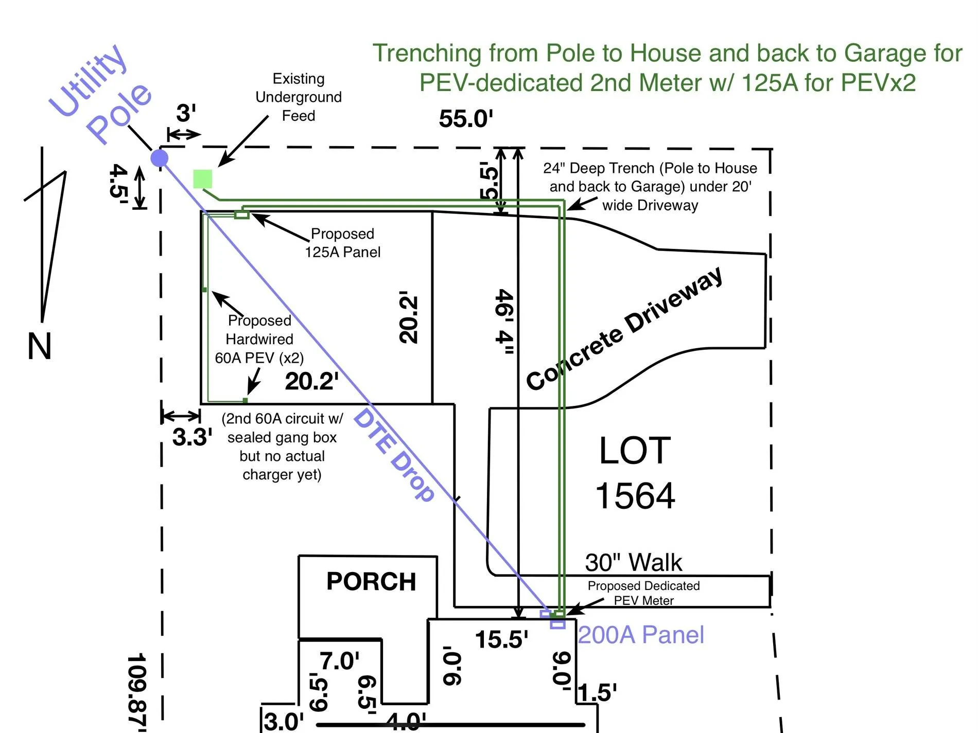

We had to revert to a plan which involves burying a new, higher capacity, line to the house and back to the garage to allow for the PEV meter to be placed on the house right next to the existing meter. Because of the trenching, our new electrician said it was too big of a job. I offered to do the trenching and he was fine with it at first, but then told me a week later that he was too busy for such a complicated job. :-(((((
I am now on my third electrician. But at least we appear to have gotten the "story" straight about what is allowed and why.
We are having a HUGE expense to do the trenching, plus a big upheaval to our back yard and cement driveway, plus the ugliness of a second meter on the house.
This mess is ultimately due to the COMPLETELY ARBITRARY rule on DTE's part that a second service to the same residential property has to be billed as commercial, even though there is no commercial enterprise on the property. :-(((((
Were it not for that arbitrary rule, this would have been a simple installation of a new meter on the garage + the dedicated PEV meter, plus the PEV circuit.
So, while we're at it, we're having two PEV circuits installed, and we're laying conduit so that our phone and internet utilities can also be buried.
