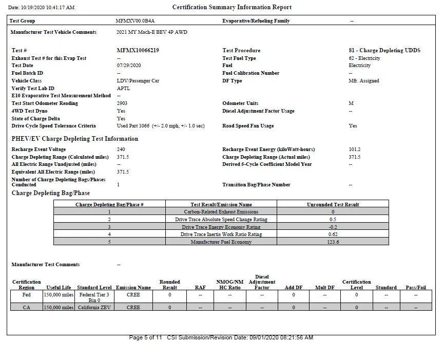

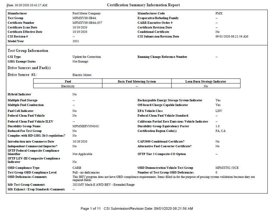

All vehicles have emissions certification posted by EPA, even zero emissions vehicles.
Today I finally found the Mach-E certificate summary information (CSI) posted (see links below).
There are two Mach-E vehicles posted; AWD ER and RWD ER.
This data is the unadjusted City/UDDS and Highway/HWFET range
derived from a single test, the SAE J1634 Multi-Cycle Test (MCT).
The data does not look to too promising.
1. All-Wheel Drive Extended Range Mach-E
2. Rear-Wheel Drive Extended Range Mach-E

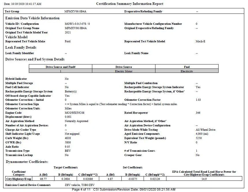

The certificate also has the road load and test mass information;
The Mach-E is not too svelte at 14.9 road load hp (at 50 mph).
Ford Mustang Mach-E Mileage for Extended Range Mach-E Models Revealed in EPA Emissions Certifications MachEAWDer_pg1
Ford Mustang Mach-E Mileage for Extended Range Mach-E Models Revealed in EPA Emissions Certifications MachEAWDer_pg4
Ford Mustang Mach-E Mileage for Extended Range Mach-E Models Revealed in EPA Emissions Certifications MachEAWDer_pg5
Ford Mustang Mach-E Mileage for Extended Range Mach-E Models Revealed in EPA Emissions Certifications MachEAWDer_pg6
Today I finally found the certificate summary information (CSI) posted at
https://iaspub.epa.gov/otaqpub/
https://iaspub.epa.gov/otaqpub/display_file.jsp?docid=51317&flag=1
(please let me know if this link works - not sure since its search result)
There are two vehicles posted; AWD ER and RWD ER.

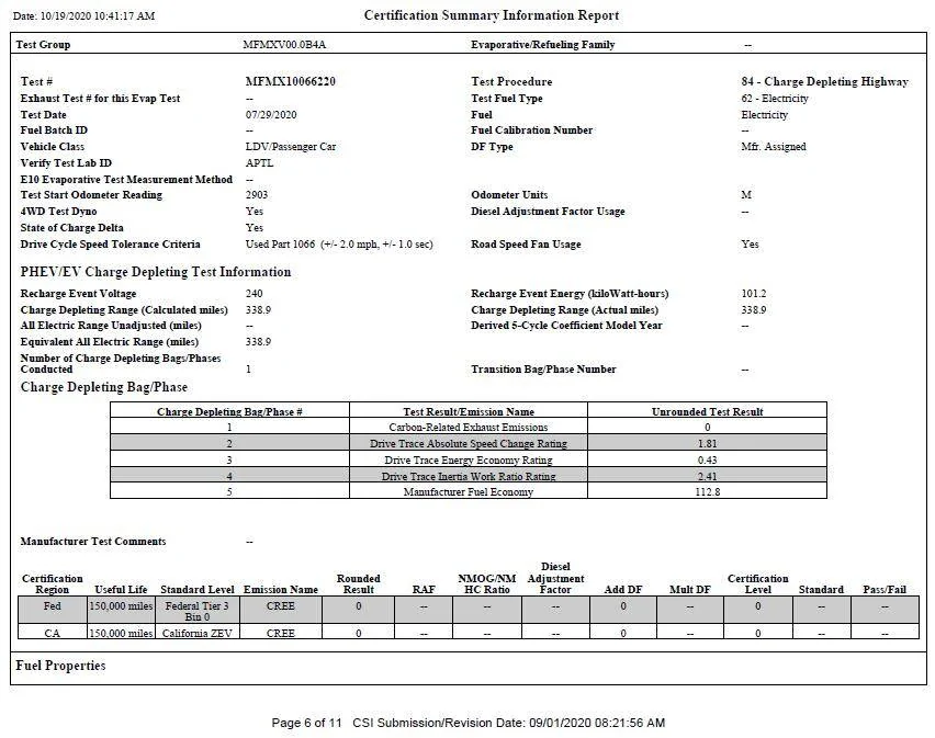

For AWD ER, UDDS unadjusted range = 371.5 miles, Hwy = 338.9 miles
The unadjusted combined range is then 0.55*371.5 + 0.45*338.9 = 356.8 miles
The adjusted, label range is expected to be 0.7 * 356.8 = 249.8 miles = 250 miles (rounded).
So not 270 miles as expected.
I will post the info for the RWD ER is just a bit.

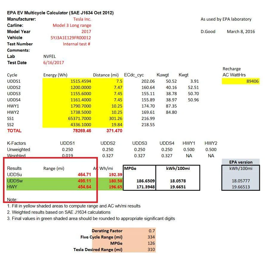

What's the unadjusted combined range of Mach E competitors? I'd be curious about Model 3 LR AWD, Model Y LR AWD, Kona, Niro, Bolt.
From that list, I've only ever seen the Model 3 LR, and the test is old, before the release of firmware which improved efficiency.
Ford Mustang Mach-E Mileage for Extended Range Mach-E Models Revealed in EPA Emissions Certifications EPAM3LR
