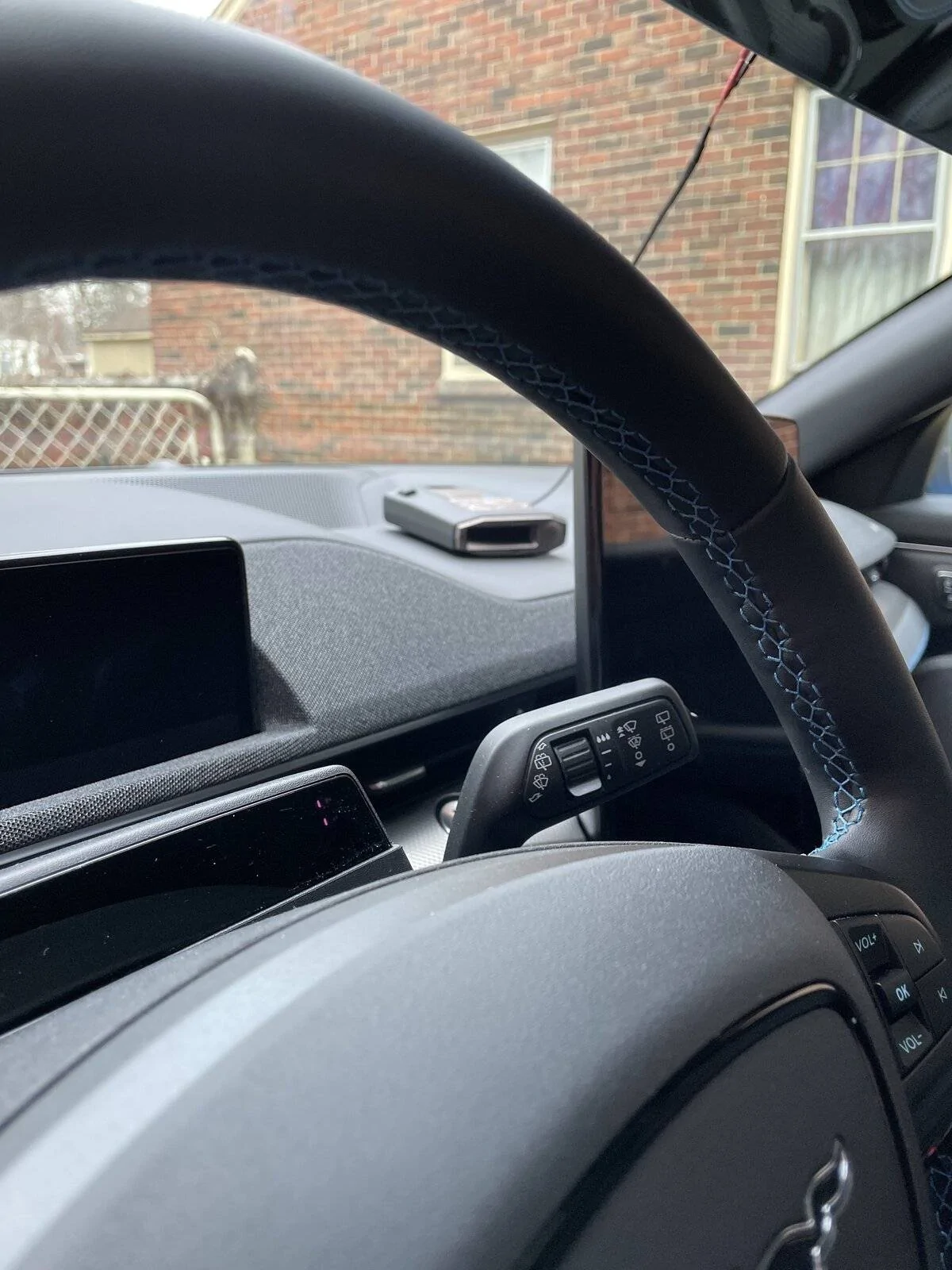

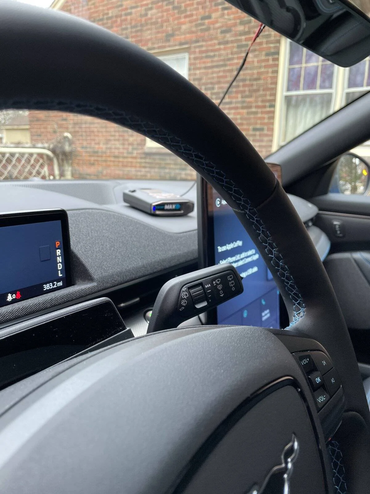

I'm using the windshid suction mount that was included with my DFR9. I have it pushed up to where the black dots are. The suction cups are as partially under the headliner to the edge of the glass. So far it's been working. I haven't ordered a universal visor mount yet. Thanks for reminding. me because I doubt the cups will hold up in cold weather. I'll order the universal mount tonight before I get sidetracked again.

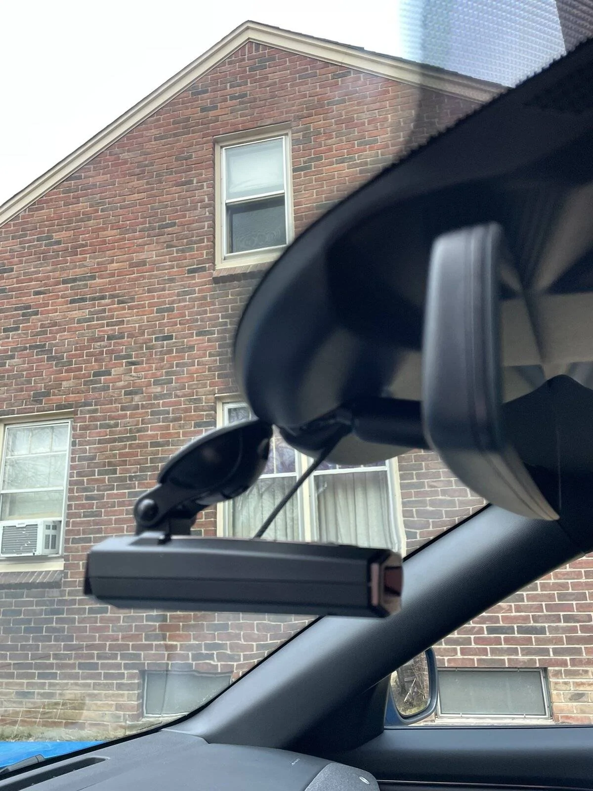

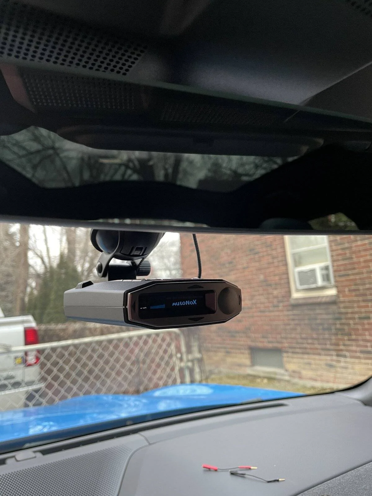

Please let me know if you've figured this out yet. I was thinking the same thing; if we can get it into the headliner it would be perfect. I can't use the OEM suction cup mount because the angle doesn't allow the detector to lock in, so it just slides off when I accelerate..which is all the time. haha
I received the mount. It does. fit under the head liner, but it's. thin metal and has to be beefed up with.something like thin foam to keep it's secured in the head liner.

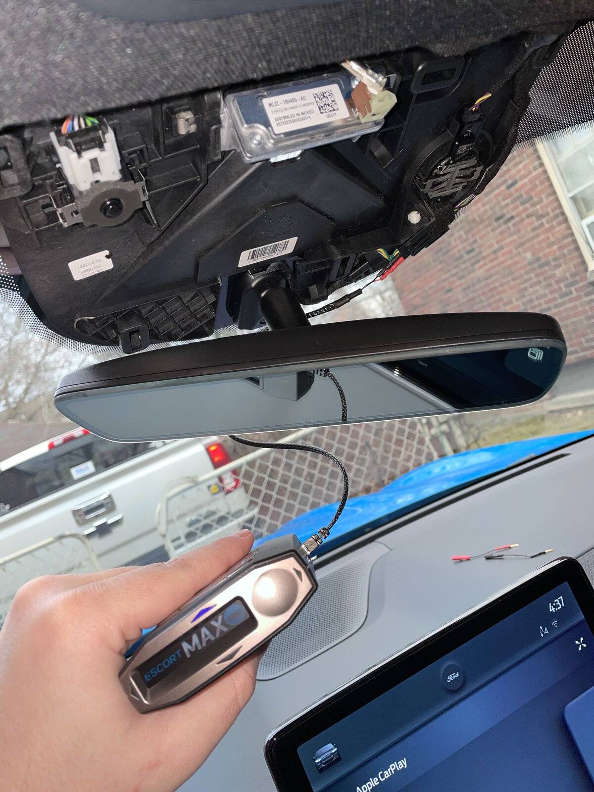

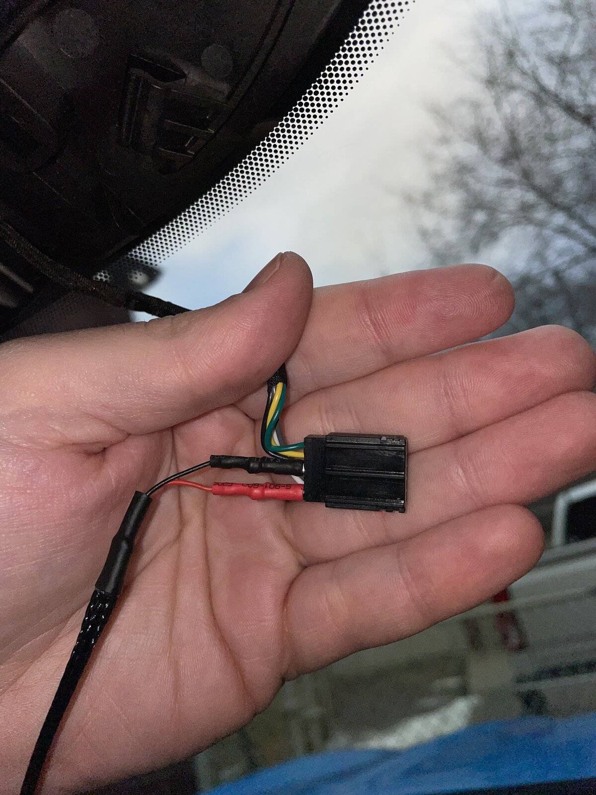

I decided to venture and do this without any help or wiring diagrams. I couldn't find ANY resources online for any reference. I managed to figure it out and I took photos along the way to help others that may be wanting to do the same.
I've done many mirror taps in the past, but this one was a bit intimidating, not knowing where to tap because of all the unusually color coded wires, and all the tech involved in this piece.
PLEASE PLEASE be VERY careful removing the plastic housing. I don't want to be responsible for anyone breaking this piece. Be gentle and take your time.

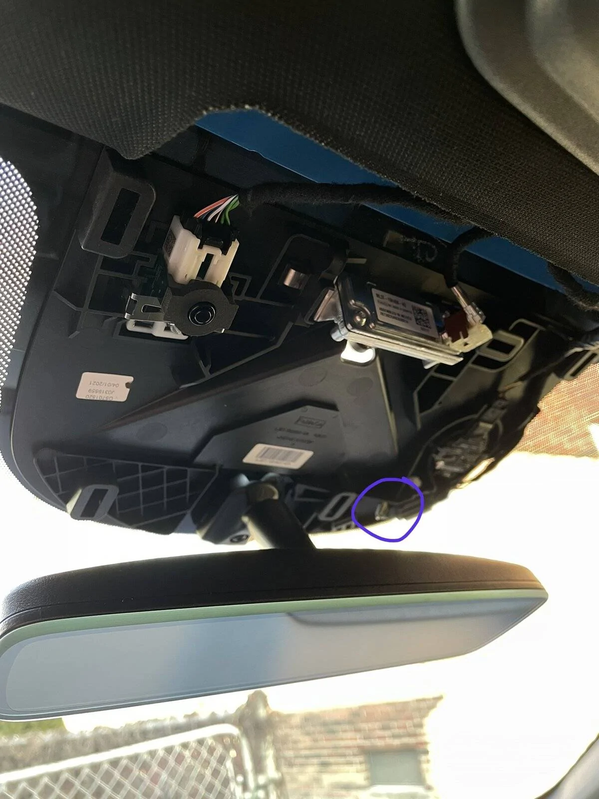

Circled is the terminal that you will be using removing and tapping into. The release is on the top, towards the windshield.

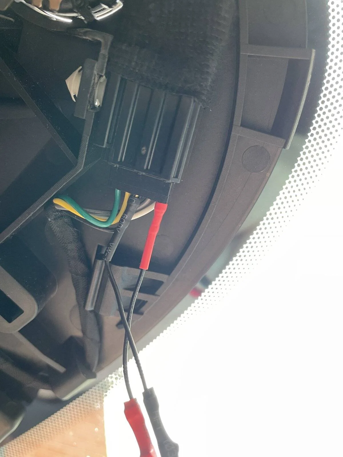

Testing the taps:

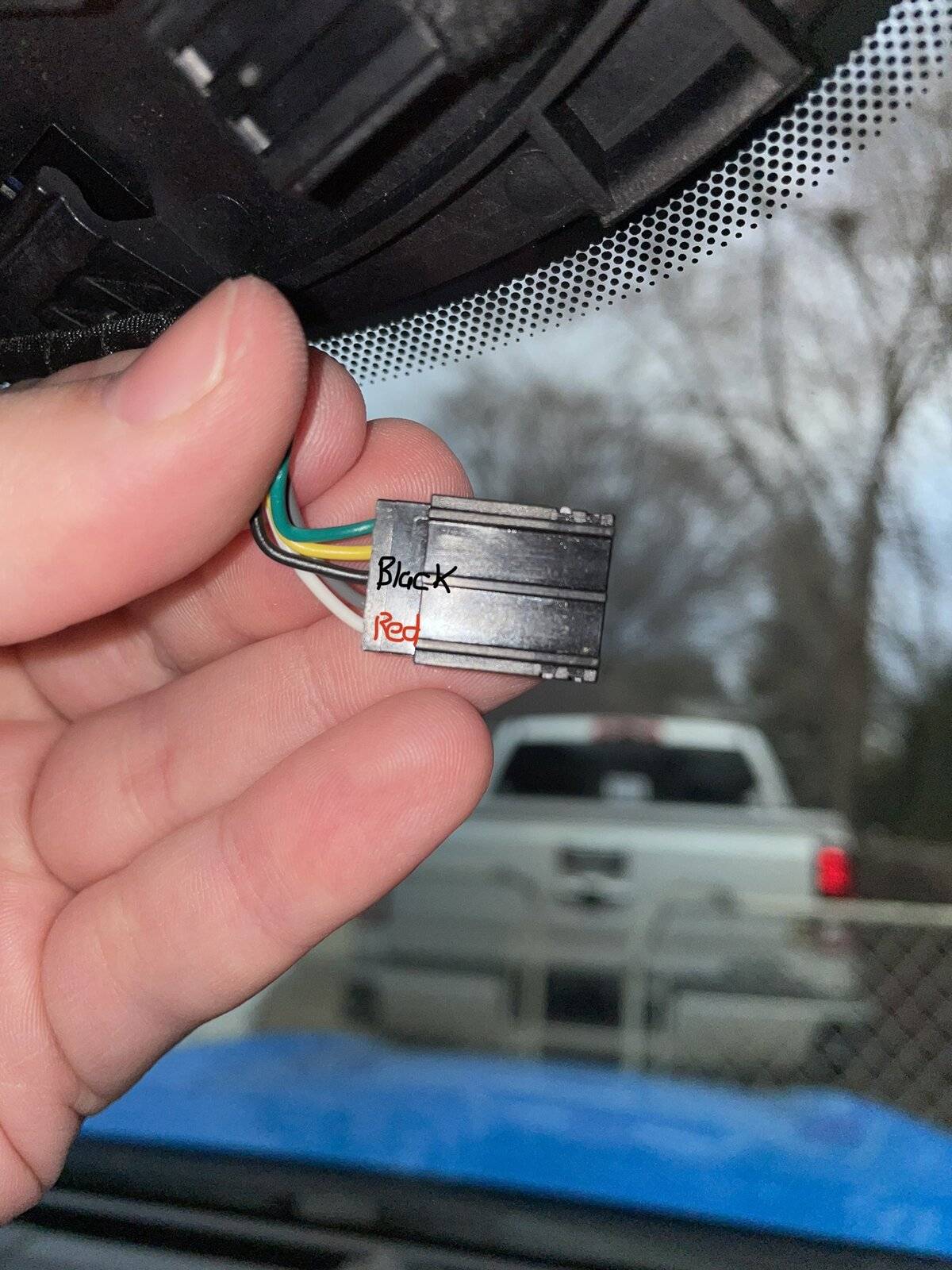

The Black Wire is the neutral/ground. Connect the Black tap wire to this. The White Wire is the 12v switched lead. Connect the Red tap wire to this.
This is what it looks like tapped:
Testing:
Vehicle off:
Vehicle on:
Complete!
Thank you so much!! This worked like a charm. I used the blend mount kit.
