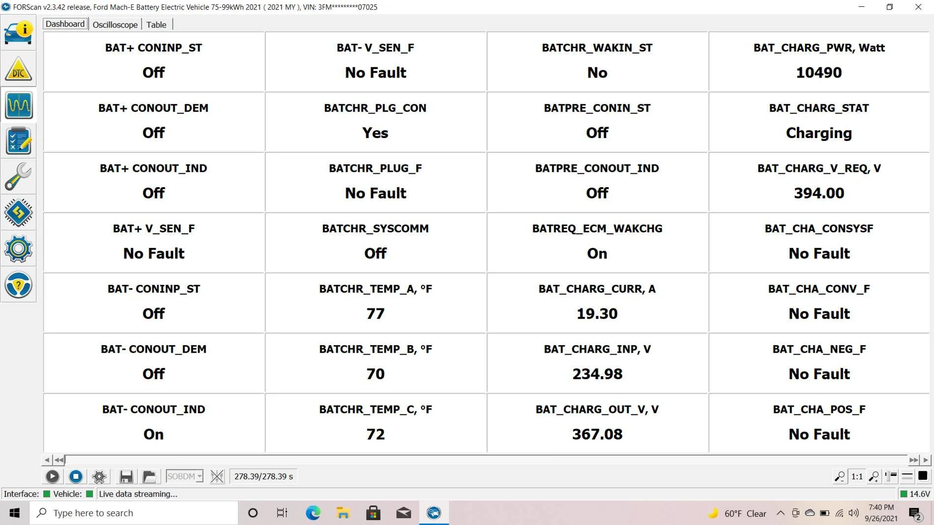

Here is a sample look at a "Dashboard" look at L2 charging (47A) on the SOBDM module:

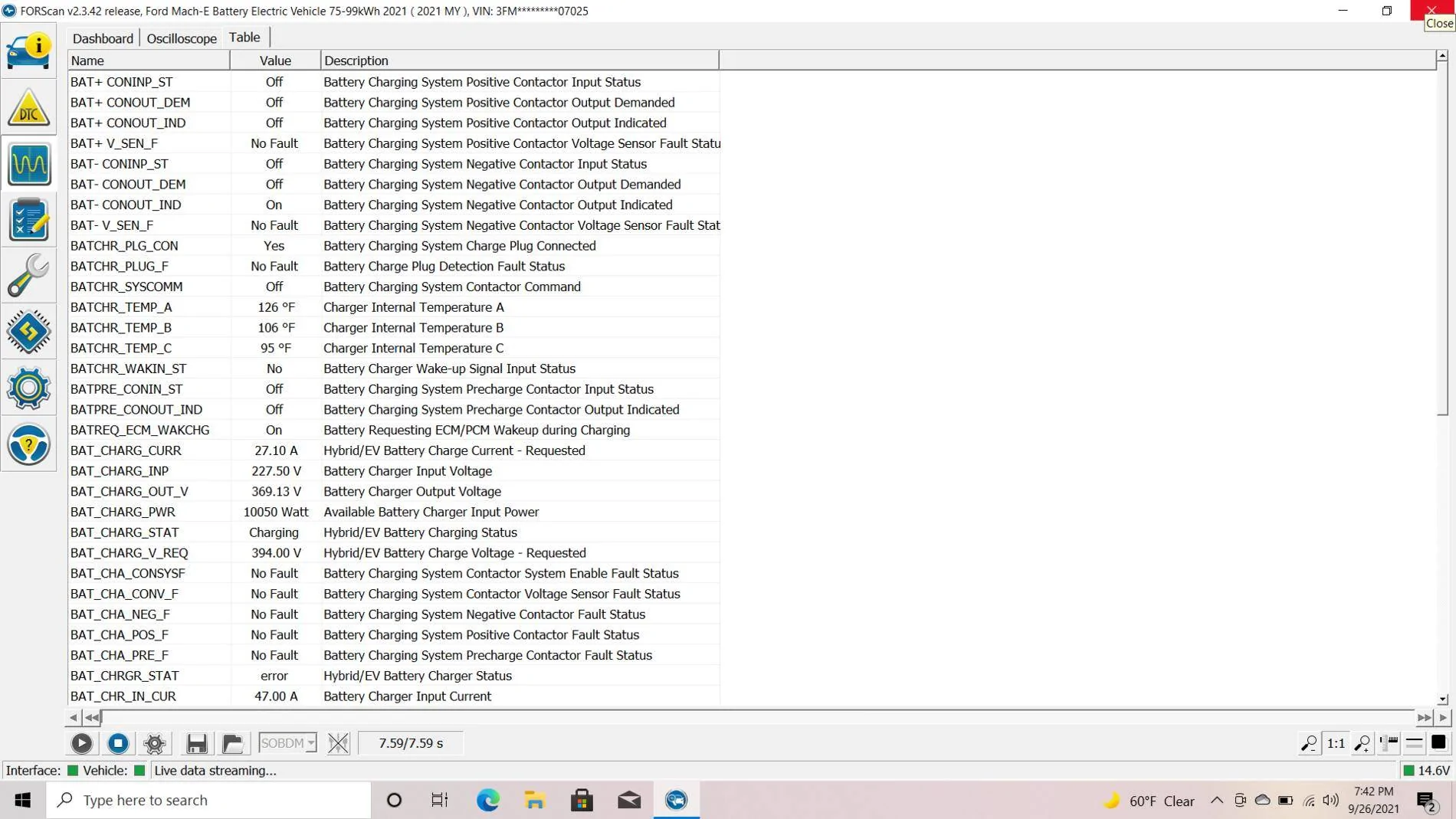

Same as above using the "Table" view:

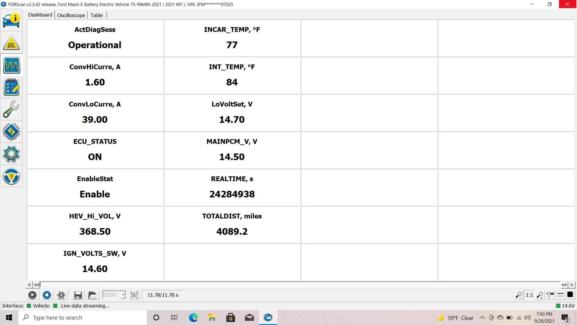

Table view of the DCDC converter module:

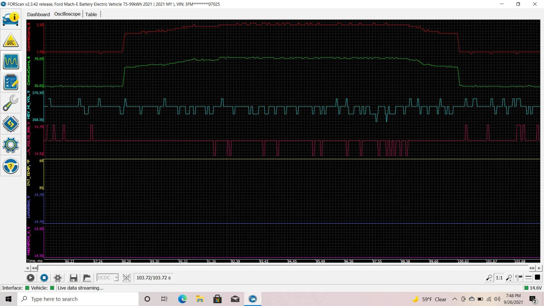

Oscilloscope view, bump in current caused by turning on then off both defroster buttons:

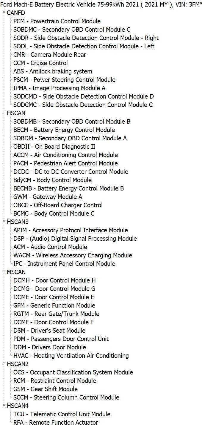

This list of modules is what's supposed to come up in FORScan. But with the Mongoose I only get the modules under CANFD and HSCAN. Nothing else. Any other Mongoose owners notice this, or have a work around? No combination of settings in FORScan seems to change anything

I recently started diving into forscan using my mongoose plus. But I recently discovered that MS CAN modules are not accessible to FORscan using the mongoose. I know that it can access these modules, given that FDRS does so with no issues.
I've tried messing around with settings to no avail. Has anyone had luck with FORscan+mongoose?
MS CAN is on a different set of pins in the DLC, the Mongoose probably doesn't have those connected. You need something like an OBDLink MX+ that can access both. In the old days we used to modify adapters and add a switch to change the pins over from HS to MS CAN.
