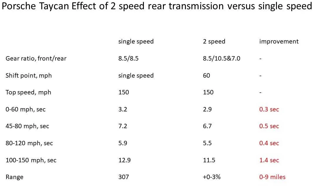

Introduce 2-speed transmission like in Taycan?
I’d love to see what they’re doing with the drive curves. I don’t think they’re anywhere near the real limit of what the car can actually do. They need a Strip mode, and to let it eat when in that mode.
