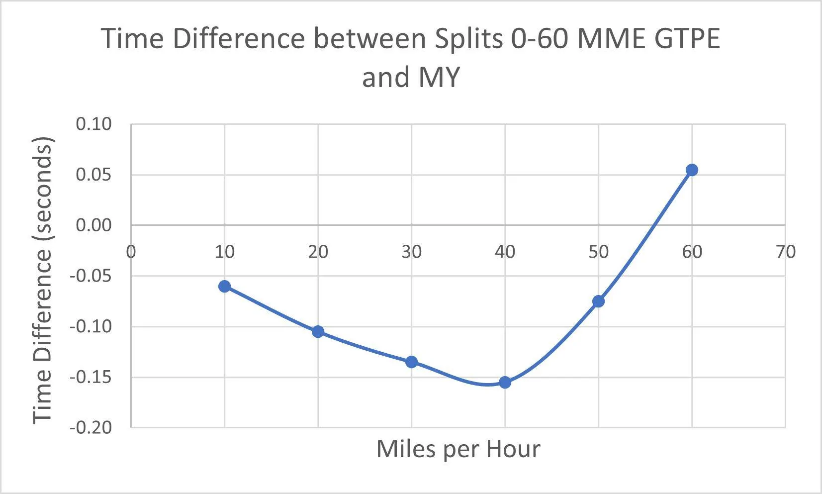

These data come from a different forum, but they support your observation that the acceleration of the MME relative to the Tesla MY decreases at or before 40 mph. Just to add my 2 cents into the discussion about the MME GTPE losing acceleration at higher speeds, I averaged the GTPE 0-60 splits from pages 1 and 59, and compared them to the Model Y splits on page 60. I graphed the difference in time (0-10, 0-20, etc) versus speed. The graph shows clearly that the GTPE accelerates faster than the MY from 0-40 but then loses relative acceleration at 40 MPH (or a little earlier). It is so dramatic that it has to be software, not hardware causing this.

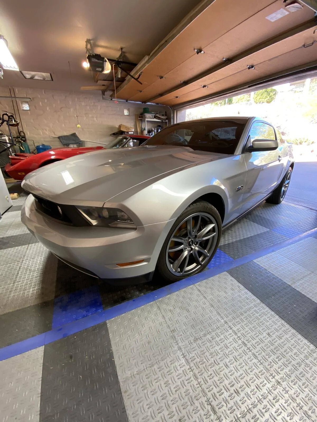

There are many ICE cars that will outperform BEV's at the higher speeds with repeatable performance. A few years back, a new P100D was embarrassed on a 80-top speed by a garden variety 2011 Mustang GT Brembo with a 3.55 rear. The Tesla, to be fair had already completed some 1/4 mile runs on a warm day-nothing could touch it from a standing start ONCE or TWICE! Later on a closed course, from about 80 on, the Mustang pulled away. We chatted later and the Tesla owner was surprised at how fast a coyote mustang was! I believe the Porsche engineers have solved both the high end speed problems (2 speed) and the repeatability problems with their battery architecture and management systems. I am curious to see what Lucid will bring to the table as they definitely have the battery tech from Formula E and the original designer of the Model S.

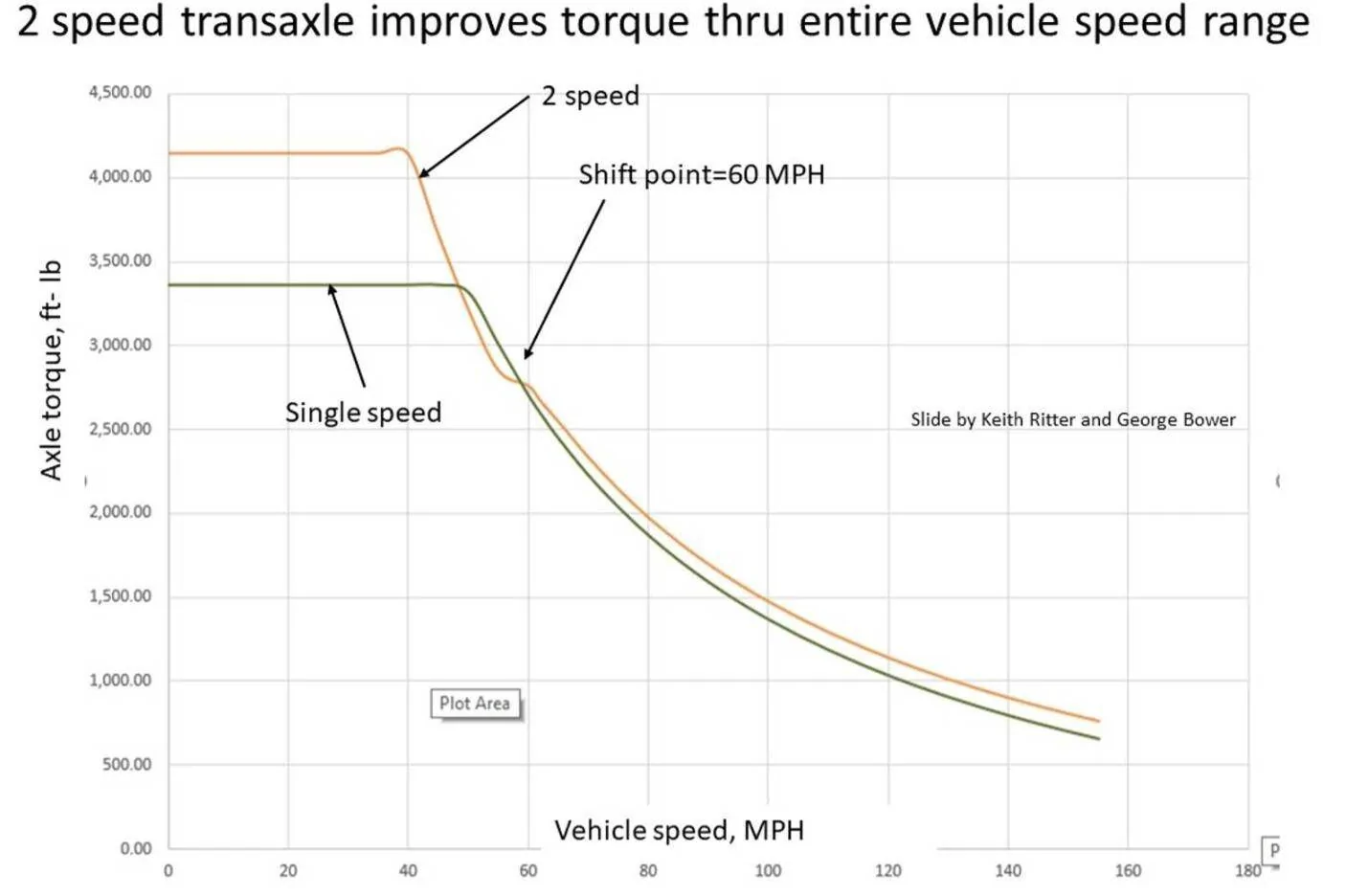

It looks like a minor advantage for a significantly higher cost.
Ford Mustang Mach-E More Mach-E GT 1/4 mile track results 1631389204202
Not Porsche, Ford. I’d love to get access to the speed ramp and max speed parameters in the drives on the Mach-E.
I feel like Ford was so concerned about protecting durability that they were extremely cautious with the way they tuned every new thing on these cars. From charging curves to drive performance curves.
Ah yes. But you’re forgetting that the Taycan 4S significantly overperforms it’s crap EPA range rating of 203 miles in highway tests by Edmunds and CD. In fact, Edmunds got like 323 miles. Owners that drive these on the autobahn in the Fatherland are no doubt happy.
https://www.edmunds.com/car-news/electric-car-range-and-consumption-epa-vs-edmunds.html
Meanwhile the Tesla S achieved only 10 miles more than the Taycan Turbo S in CD’s 75 mph highway testing. Even though the S P100D is/was EPA rated for about 134 more miles.
https://www.google.com/amp/s/www.ca...an-turbo-s-vs-2020-tesla-model-s-performance/
So, the acceleration advantage of the 2-speed may not payoff until 120+mph or whatever but it does help highway cruising efficiency. As Porsche stated it would.

Why software??? Completely different manufacturers using completely different engine and drive train hardware.

Because, the motor is capable of well over 110 mph and it will make whatever torque it needs to get to speed. It is clearly being told by the software to not keep accelerating at max power.
