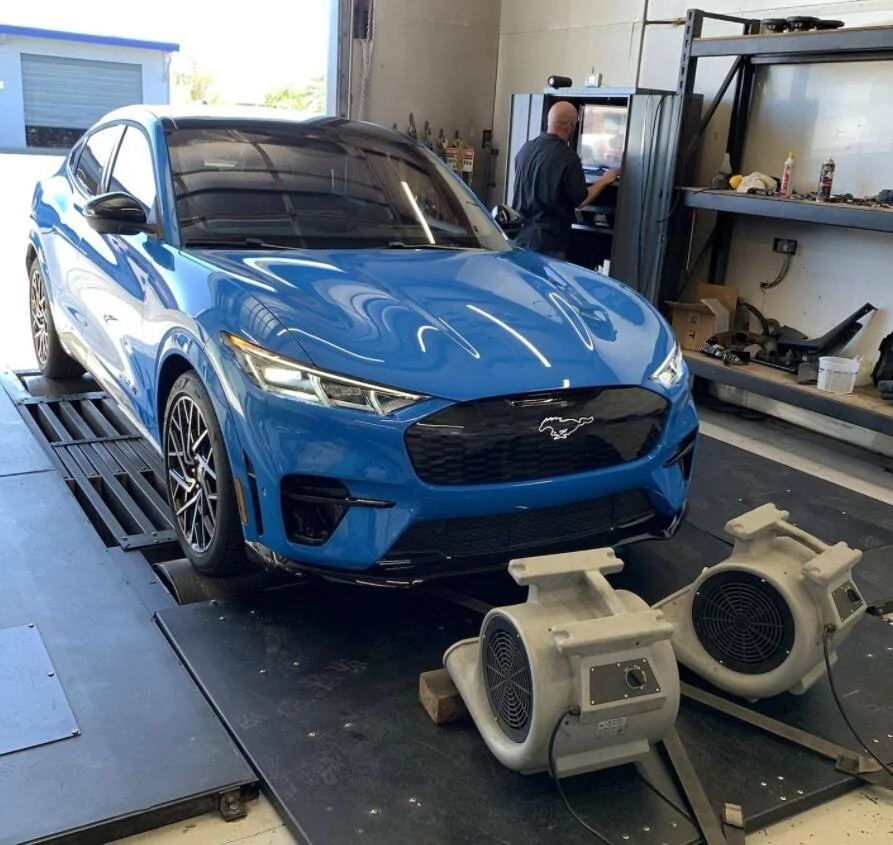

So what was the end result with the dyno? Could you get it to work?
Both the shop owner and I got a little spooked the second time the GT tried to drive itself off the rollers. I wasn't behind the wheel but he said it was still the collision avoidance triggering despite all of it being turned off through the menu.
I had considered turning off the advance trac (I'm used to doing this having dyno'd my GT500 where of course you have to) but didn't think it would help so didn't try it, and I had already left the shop by the time people started suggesting it. I don't think he turned it off on his own but actually don't know for sure.
Also considered putting it in Unbridled Extend figuring that would disable all that crap, but I actually don't really care that much how much power it makes in Extend other from an academic perspective.
He said to come back if I figured out how to make it safe but seeing it dart to the right while on the rollers... Not sure I want to tempt fate again. I may try and swing by today just to talk to the guy some more. We'll see.

Dang…. And we were so close to at least unraveling the mystery!
Maybe @trutolife27 can chime in? He did the first and possibly only dyno.

Thanks for being the guinea pig @Frankie Keep us posted if ya return, ill see about trying myself
Wonder how helpful the fans actually are for the EVs? If those being right out front are also causing issue... Though, the shop wall 30ft away would prob also apply then too if it thinks its going 70mph. Hoping the full advance trac off will do the trick ?
It isn't just the fans being there, that's the first thing we checked (by getting rid of them).
My guess is the fans aren't really necessary during a ~10 second pull but you should put them in front of the vents for cooldown afterwards, but I'm far from an expert that's just a guess.
