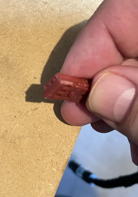

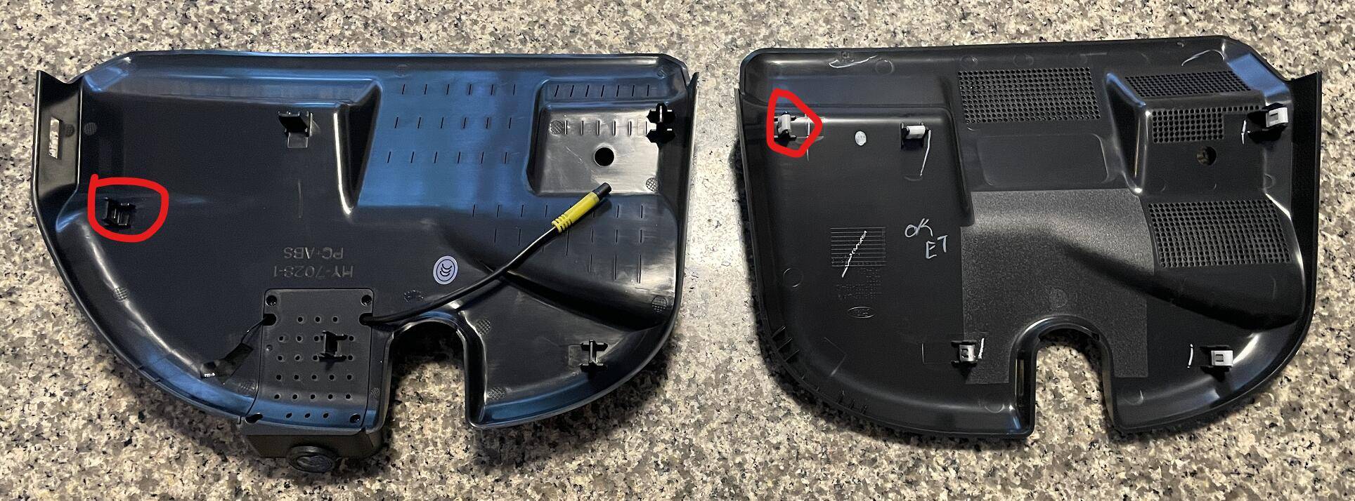

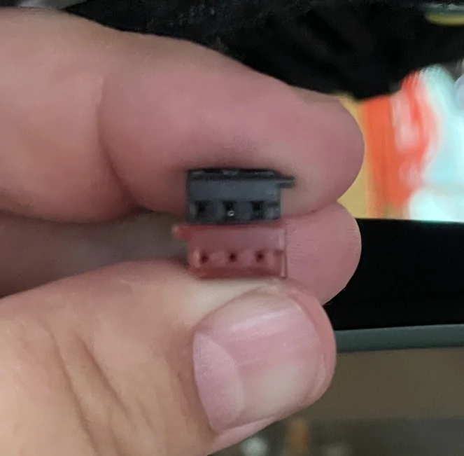

Another issue was that the plug for the pass-through that pulls power from the rain sensor had a little plastic tab on the wrong side.
Ford Mustang Mach-E My Journey with FITCAMX (Dash Cam with OEM look) 1662924366219
I trimmed that tab off, and I was able to get it to fit.
Ford Mustang Mach-E My Journey with FITCAMX (Dash Cam with OEM look) 1662924588650

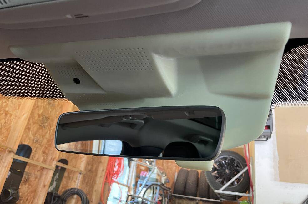

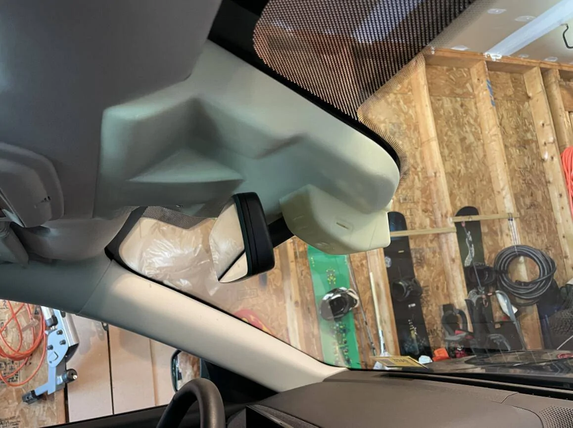

Although it wasn't a perfect fit, I installed the Chinese version and confirmed that it functioned as expected.

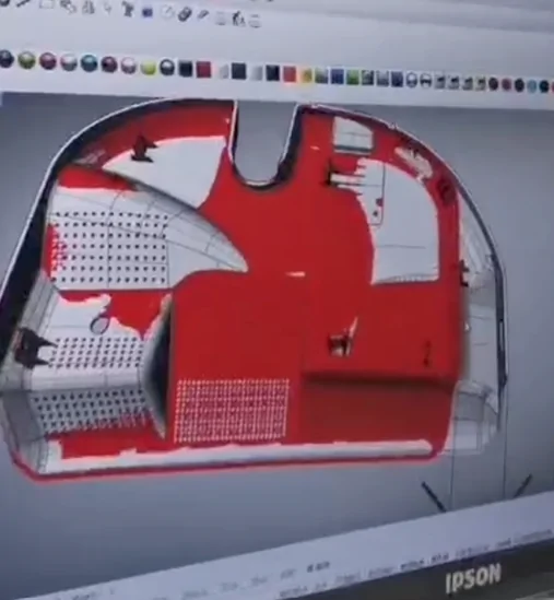

With the digital scan, they were able to create a new model and 3D print a prototype for me to try. The color was horrible, but the fit was much better. Here's the new prototype next to the Chinese one:
Ford Mustang Mach-E My Journey with FITCAMX (Dash Cam with OEM look) 1662925625562

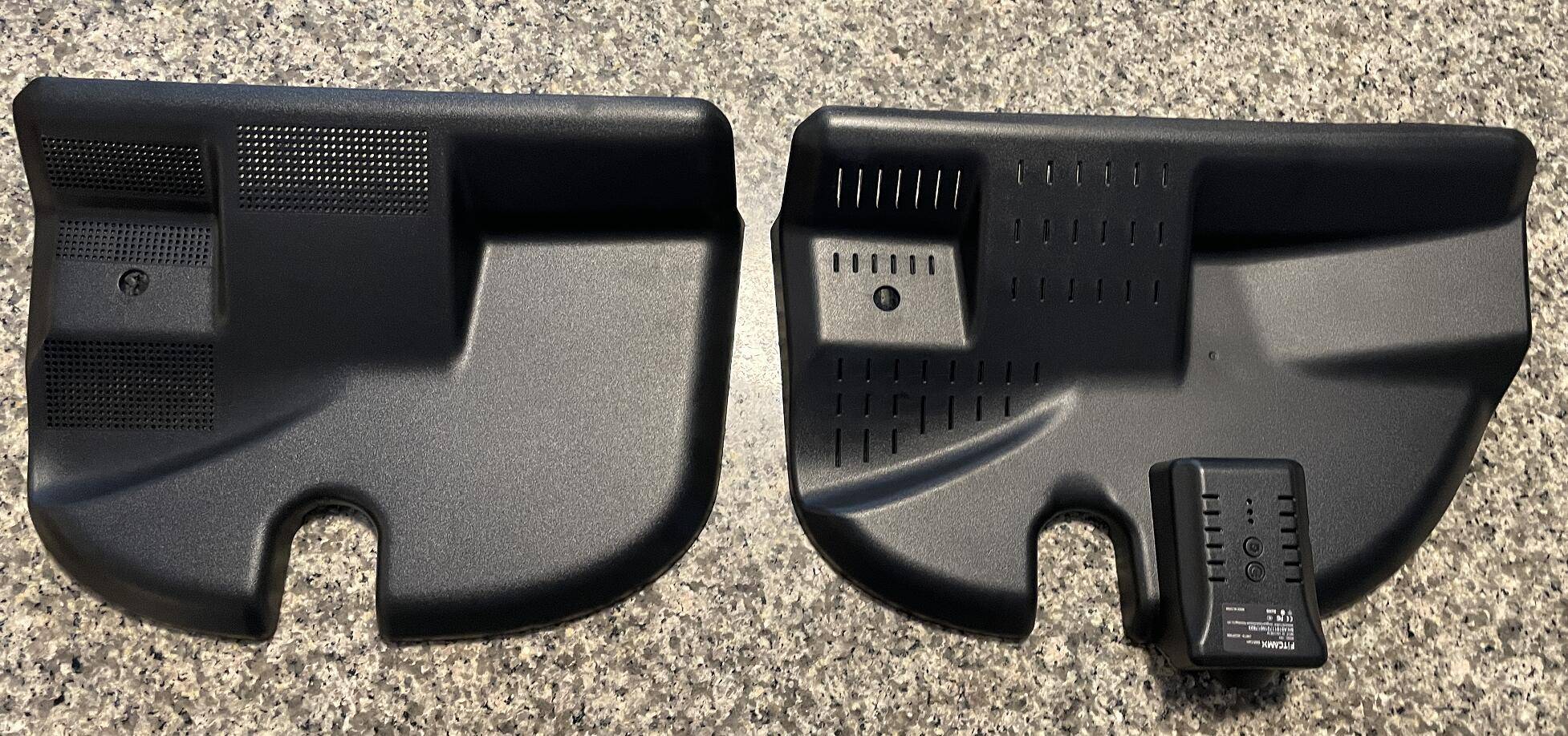

After sending them pictures, including a screen grab to show the angle of the camera, they sent the design off to the factory for mass production.
Ford Mustang Mach-E My Journey with FITCAMX (Dash Cam with OEM look) 1662925866108
The original estimate was about a month to have the first production units roll out of the factory, but they ran into an issue with the mold that took an additional few weeks to resolve.

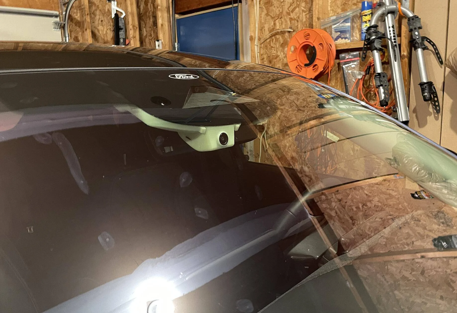

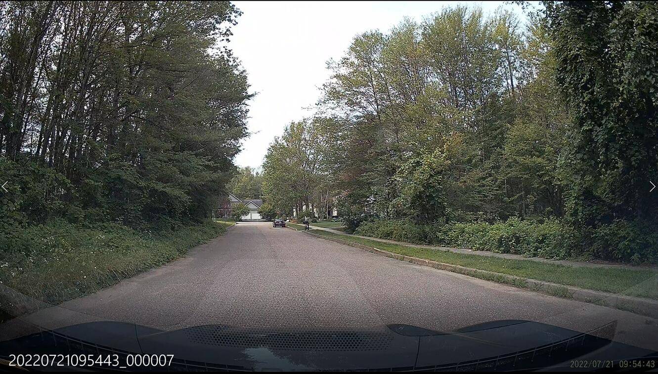

Here's a pic from the outside. It will obviously be much less noticeable when it's black.
Ford Mustang Mach-E My Journey with FITCAMX (Dash Cam with OEM look) 1662984692649
I don't have any video clips handy, but it's the same 4K camera that's in the entire FITCAMX line of products. Here are some samples from YouTube.
