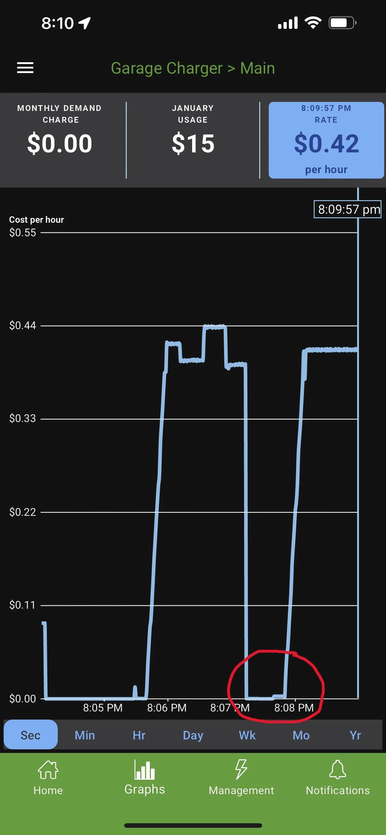

Hello @EmporiaEnergy, thank you for reaching out. I have the charger configured to max out at 40 amps already, and I currently have it set to charge at 18 amps. I do not use any schedules or peak demand settings on the charger, it just charges as soon as I plug it in. I do have a limit on the car to stop charging at 80% though, which is respected as far as I can tell. I tested tonight the pause function in the Ford app with my included Ford charger connected to the same plug. It turned off charging and stayed off. I did not leave it for a long time, just longer than my Emporia charger which when testing afterward, turns back on in < 1 minute.
Attached is a picture from my charge session. The red circle is where I pressed pause in the Ford Pass App, and as you can see, charging resumed quite quickly. While beside the vehicle, I can hear the vehicle stop charging, and then it sounds like the charger goes off. After a few moments, it makes another sound and audibly clicks back on; the vehicle then starts charging again.
Any insight you may have, or if this is a feature to ensure charging is not accidentally interrupted by a vehicle temporarily refusing charging, would be great.

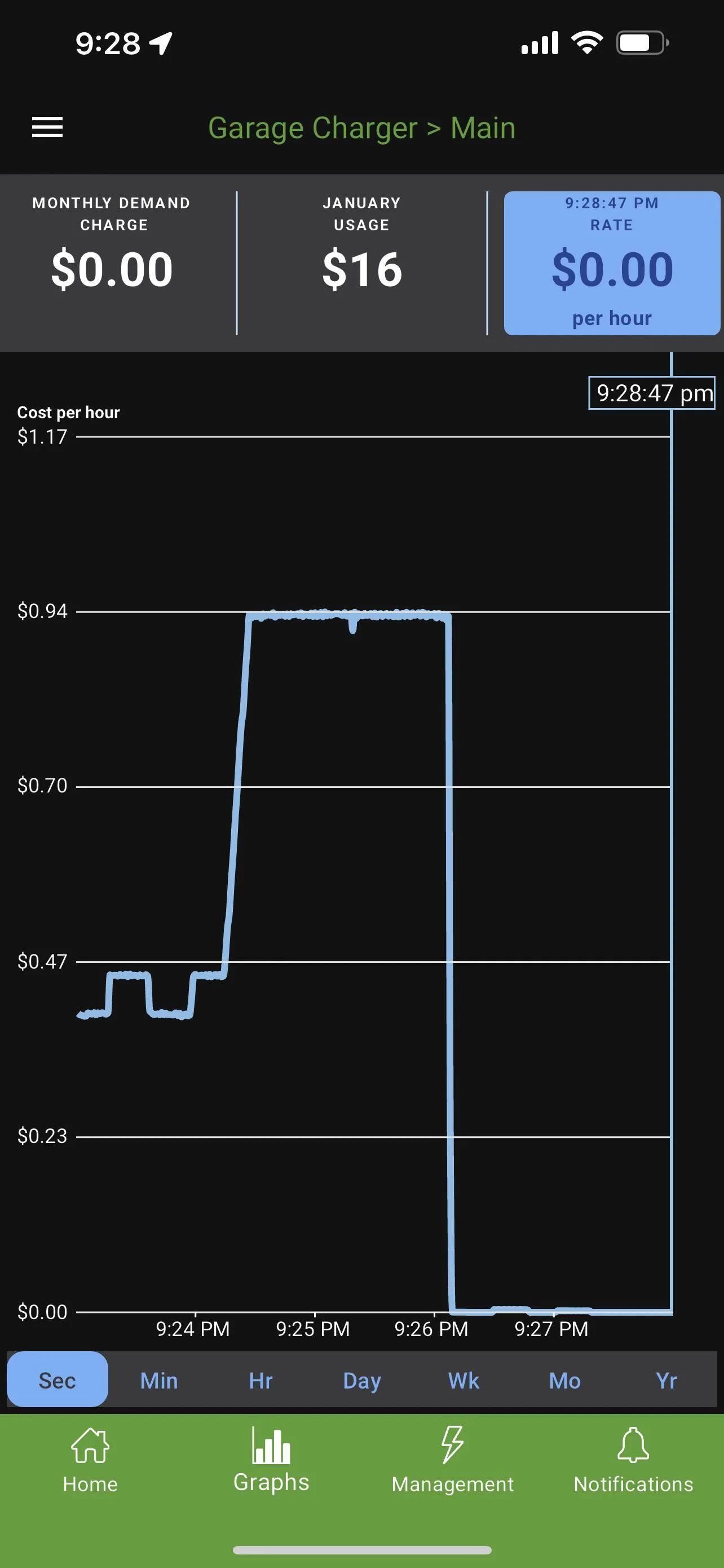

One final note on this, I was able to catch my vehicle charging to 80% when the vehicle stops charging. The charger appeared to “retry” twice by disconnecting and connecting again. The vehicle starts the charge process and opens the shutters at the front and closes them, then starts charging only to realize it is already at 80% and then stops again. This happens one more time and the charger gives up.
If we could get a toggle to disable this retry mechanism that would be great!
Attaching another screenshot showing the retry attempts as small power usages along after completing the charge.

The EVSE is controlled by the car, and the car is turning it back on, not the Emporia EVSE. It is just responding to commands from the car.
