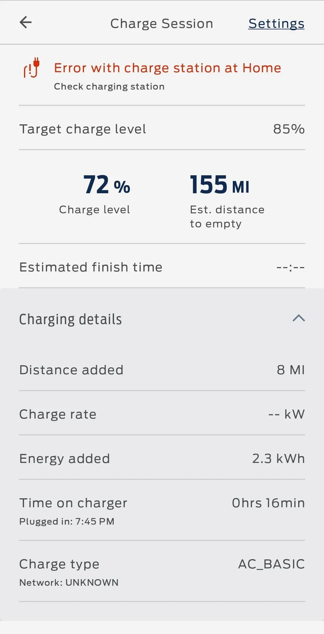

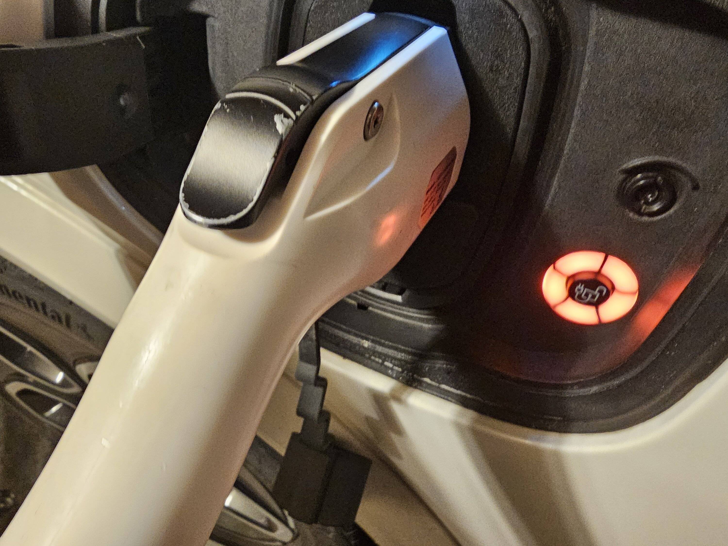

So I stopped the charge using FP, and it did not restart. However, I think probably the behavior of your car is normal, and mine is not because I got a charge station error. I think if I didn't get the error, it would have worked just like a pause as Rick mentioned. But I have no way to confirm it.
Because of the error, the car cannot resume charging. I had to unplug the connector and plug it back in to get the charging to start again. And it did immediately, even though I previously stopped it via FP.
