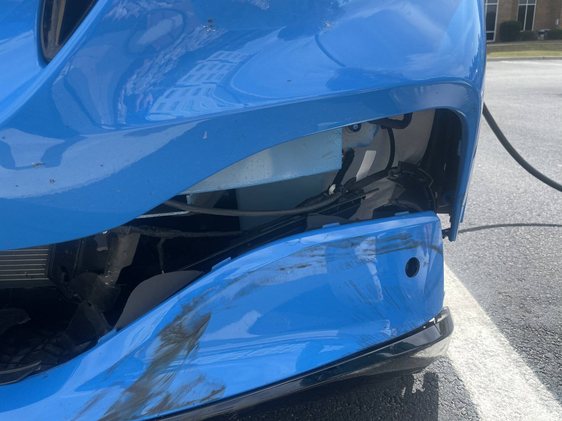

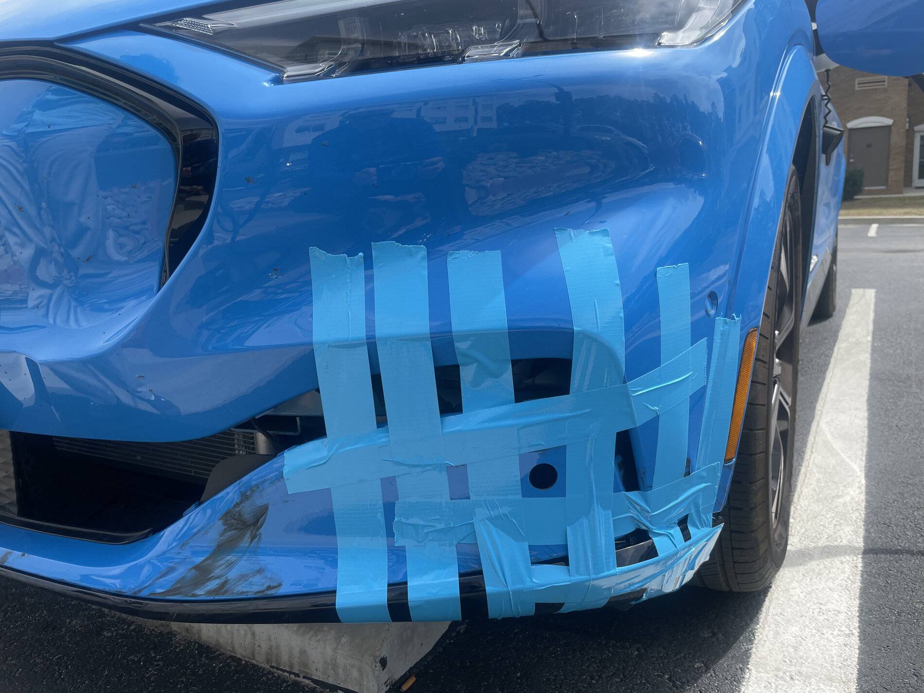

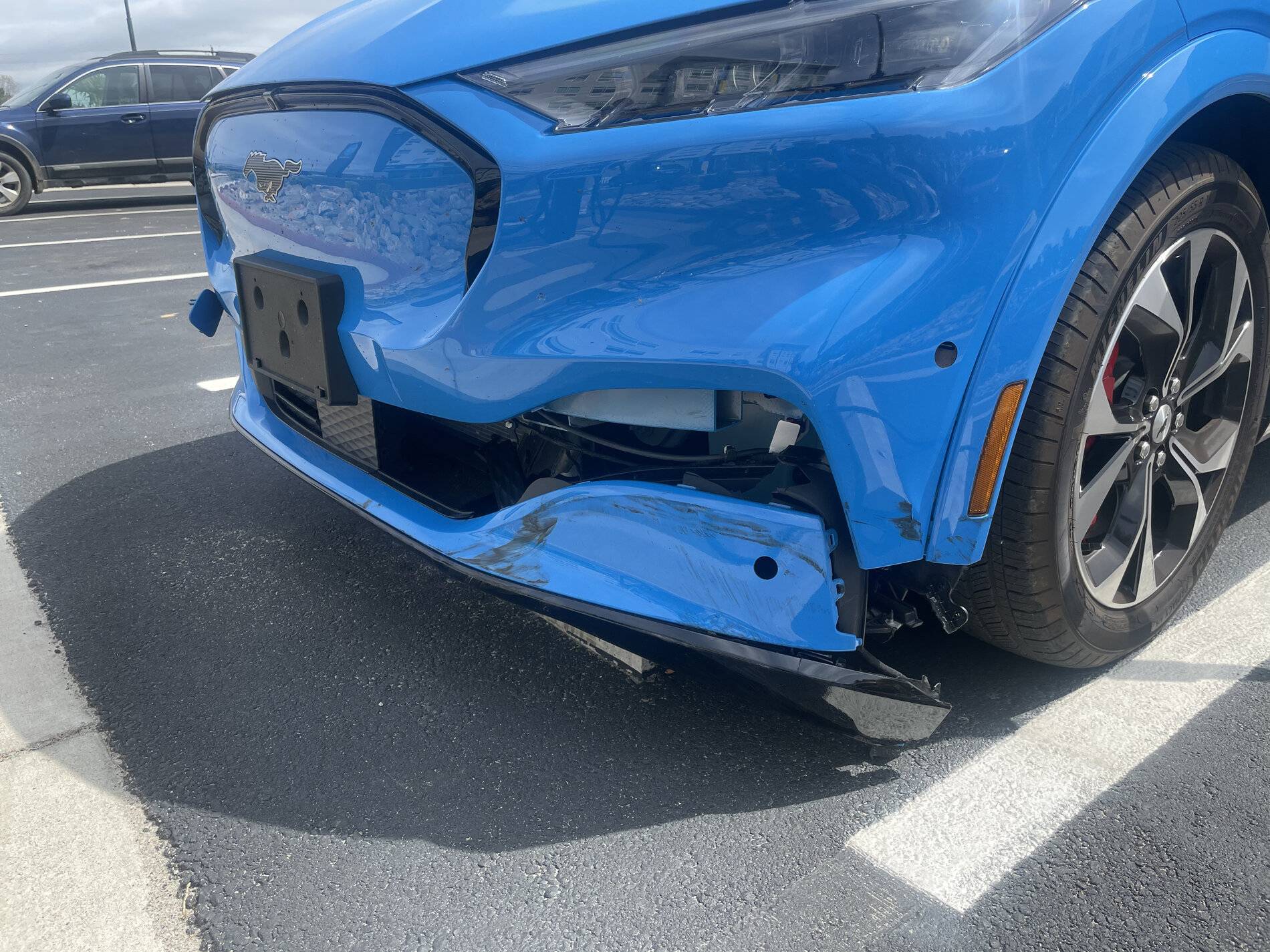

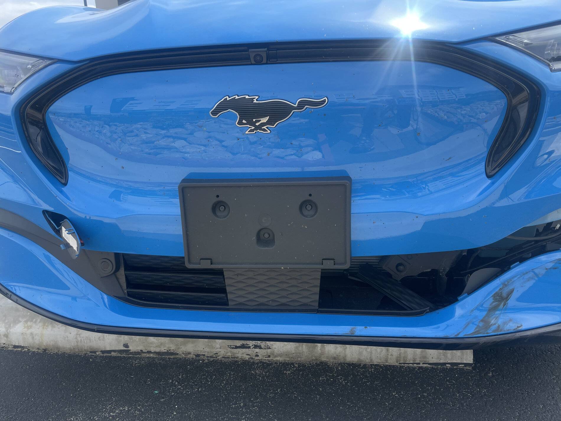

Body Repairs:
Just dropped Marlin off at Maryland Collision Center (the shop Koons Ford works with closely). As of late last week they already had received all the parts except the new front battery vent louvres and those were supposed to have been shipped already. Fingers crossed there won't be any delays due to other parts availabilities.
