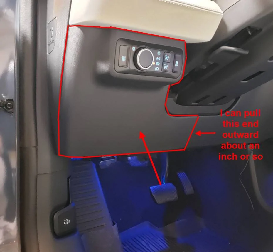

Does anyone know how to remove this light switch panel? I can pull it out somewhat at the split (where the 2 lower panels meet) but after about an inch of outward pull force there's too much resistance without any further give so I quit under the impression I might break something if I pull harder. I expected it to have those push clips that pop out but it really feels solid.

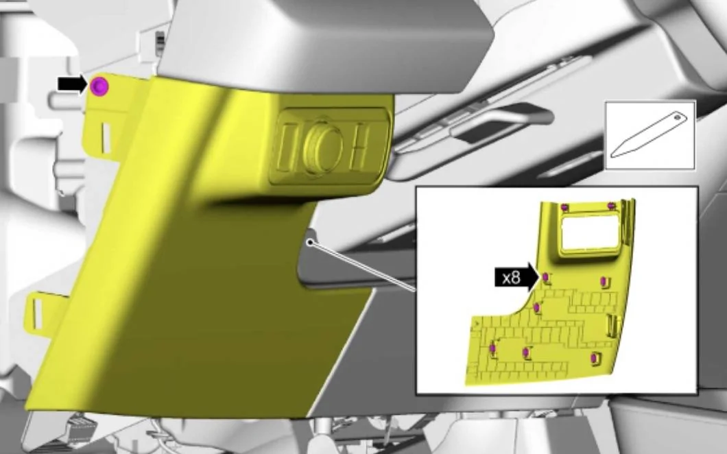

Not sure if the OP ever was able to remove that panel but you first have to remove the panel to the left which just pops off. Behind it is a screw you must remove before pulling the other panel off. Now, I am not sure why the OP wants to remove the panel but if it's because they want to remove the headlamp switch unit, that can come out without removing that panel. Take a trim removal tool and start at one of the corners and that switch assembly will pop out.
