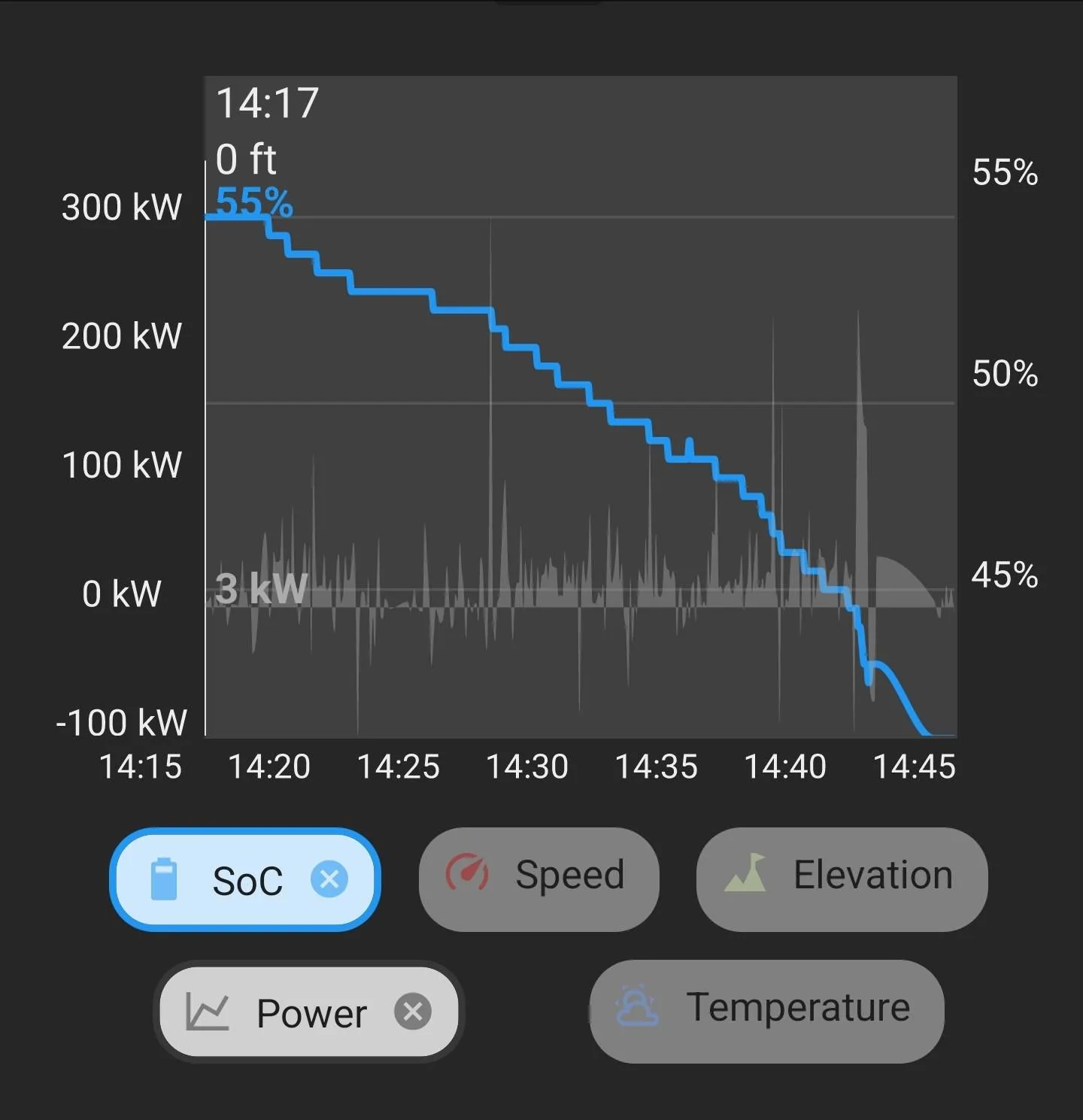

I just wanted to take a moment to share some news of a new ABRP feature that is being launched right now. ABRP now has the ability to use a Bluetooth Low Energy OBD2 dongle to read live data from your car directly to improve route planning. I have been working with the team to get this working with the Mach E on launch and they have pushed the production apps today!
The app will collect the following data from the Mach E:
  • State Of Charge (Matching the displayed SoC)
  • Current
  • Voltage
  • External Temperature
  • Battery Pack Temperature
  • If the car is charging or not charging
  • State of Health of the HVB
Ford Mustang Mach-E New ABRP Feature : Live Data via OBD Screenshot_20211220-145031_Plasma Ember
The ABRP app can – for supported vehicle models – connect via Bluetooth Low Energy (BLE) to a user-installed OBD BLE adapter in the car. This allows the ABRP app to communicate instantly with your car to read out SoC (battery %), and many other parameters which keeps the ABRP app up to date with your car as you drive. This works for both iOS and Android devices and is available for all ABRP users, not only Premium members.

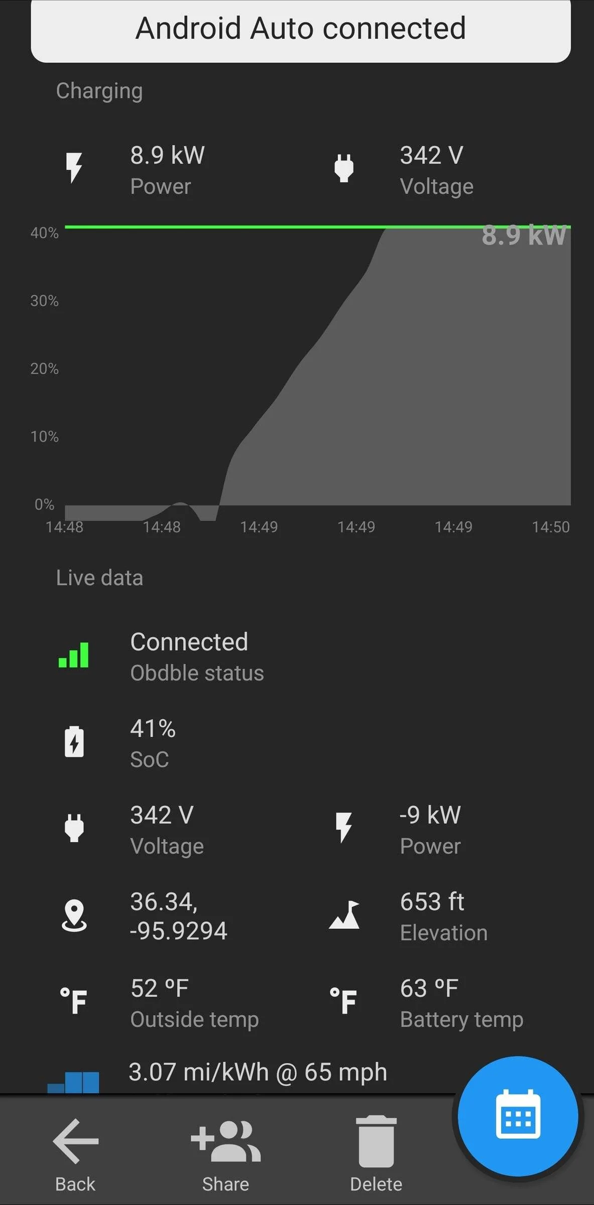

Also of note, if you have ABRP premium, you can save all of the data to your account and view it later.
