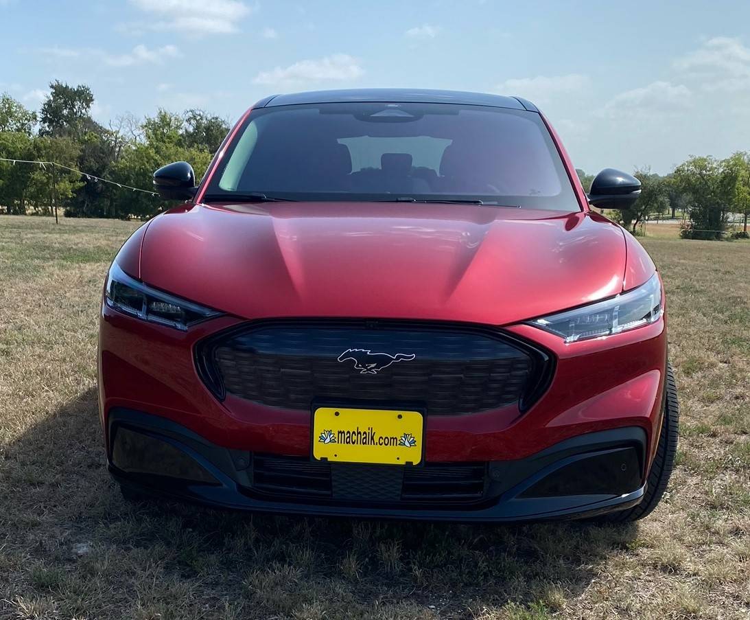

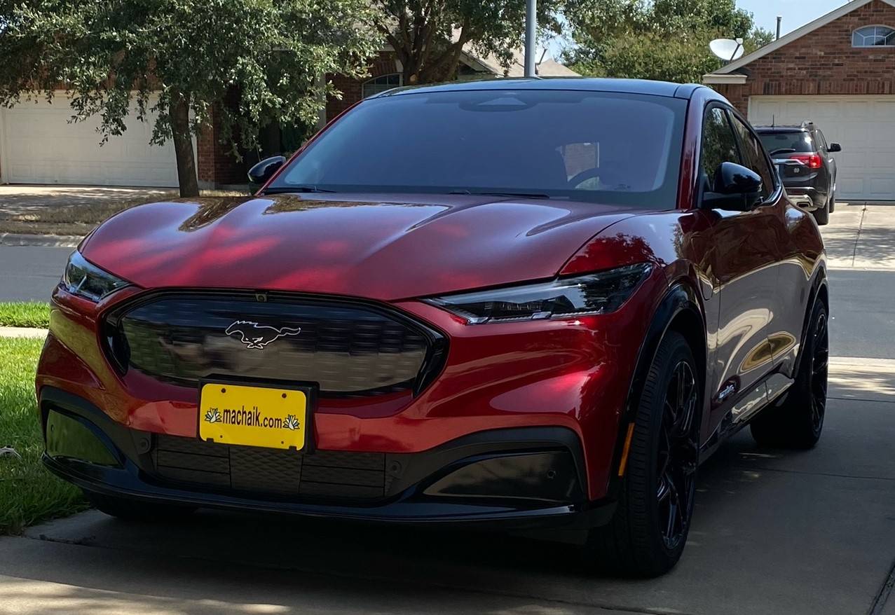

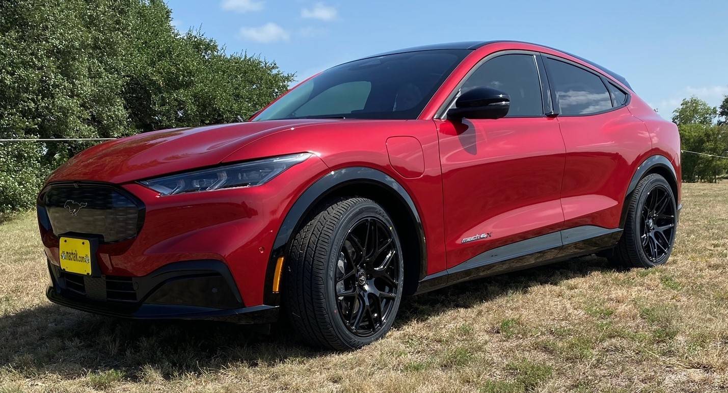

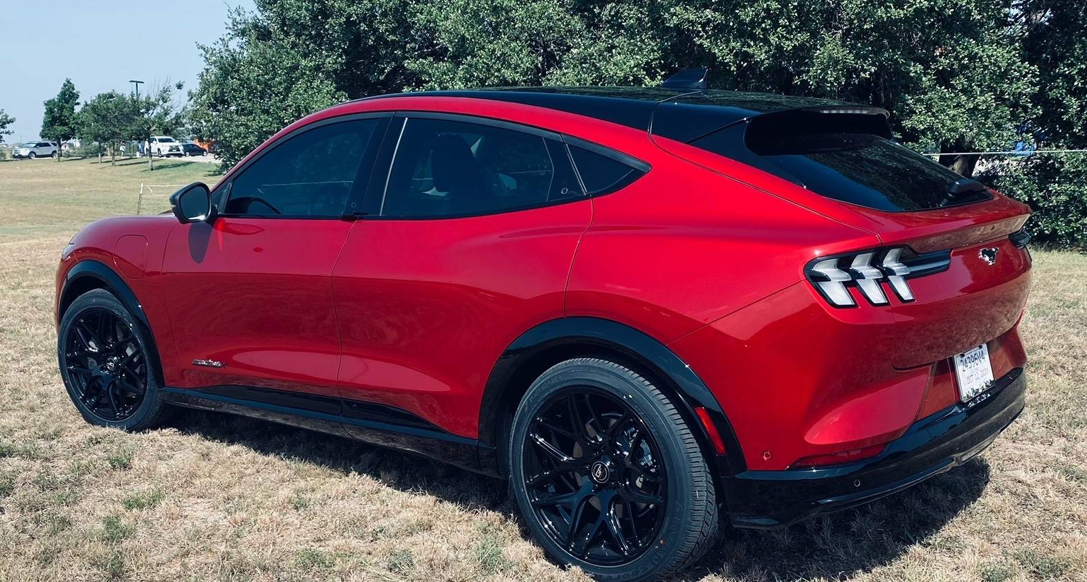

Just had new shoes put on. MMR GF9 20x10 45 offset Rear and 20x8.5 40 offset Front. with Yokohama Advan A/S+ 275-40-20's in the back and 245-45-20's in the front. Came out great!

Nice! Did you have your front bumper painted black, or did it come that way?

Looks awesome !

I want to put 275/40r20's on all four 20x9.5 custom wheels. Did you go smaller on the fronts because the 275's were hitting the fenders while turning?

My plans have been adjusted, AGAIN. Going with 20"x10" wheels, with a 47 offset. The wheels are lighter that way (2-piece instead of 3-piece), and the tire sidewall distance to the fenders INCREASES, as the sidewalls will be 15mm closer to the fenders instead of 19mm (with 9.5"), due to less bulge in the tires with a 10" width. Because nobody got back to me here re: clearance issues with 275's on the front, I'm having the back 10" wheels built first. I'll mount the tires/wheels on the front, pound on 'em, and see if I have clearance issues. If not, I'll go square with 275/40R20's and 20"x10" wheels all around.
