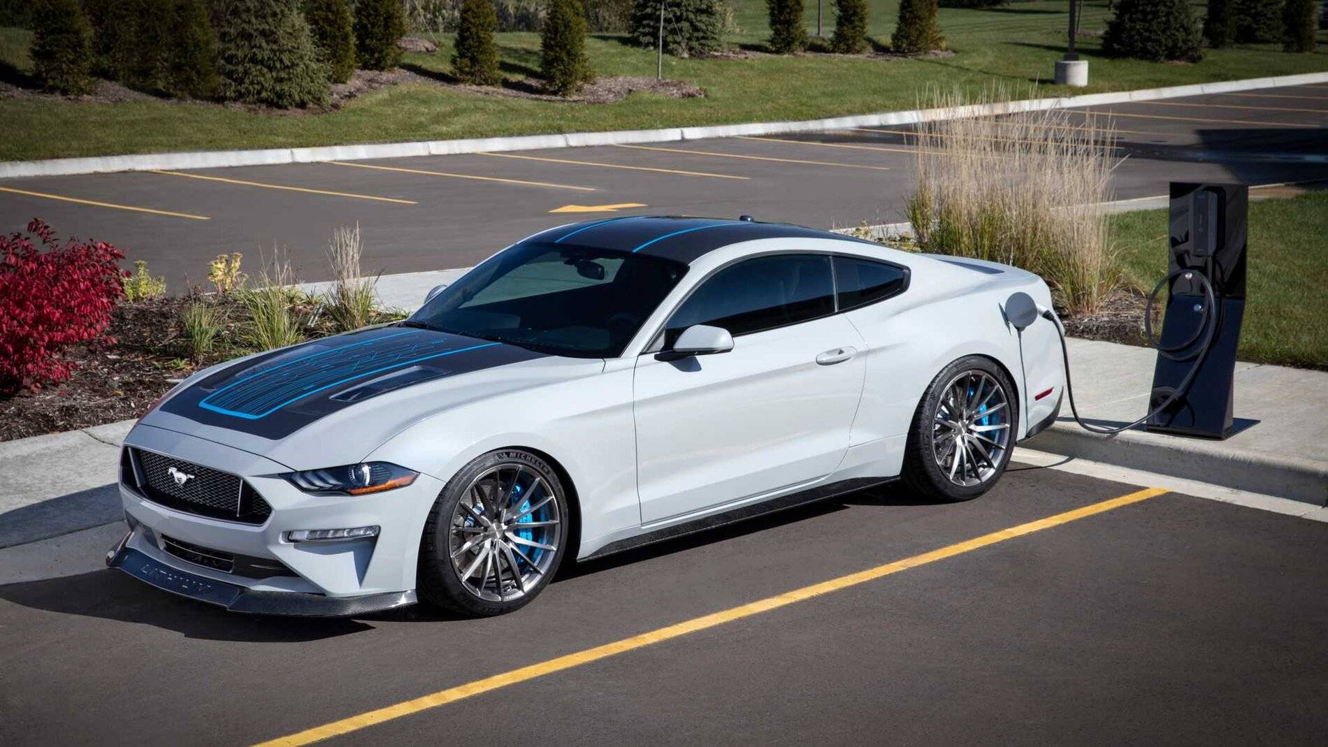

Could it look like this?

Simply, the Mach E platform is pure electric, and the Mustang is ICE with a driveshaft for RWD. Their architectures are as different as Apples and Windows. You know how it's hard to shoehorn an electric drivetrain onto an ICE platform? It's similarly difficult to shoehorn an ICE onto an electric platform.
It's why the Fusion Energi (I loved mine!), for example, has an awesome grocery trunk, but a not-nice vacation trunk.
The hybrid and electric F150 are different, because they're body-on-frame (full chassis). There's a lot of space available on the existing chassis for electrification. The tophat doesn't have to change substantially or at all to fit on a full chassis.
I don't know the full details on the S650, and I probably wouldn't be able to share. I'm guessing, though, that we're going to try really damned hard to make hybrid/ICE/EV underbodies that interface with a single tophat. I'm not even sure if S650 or future model will be EV.
