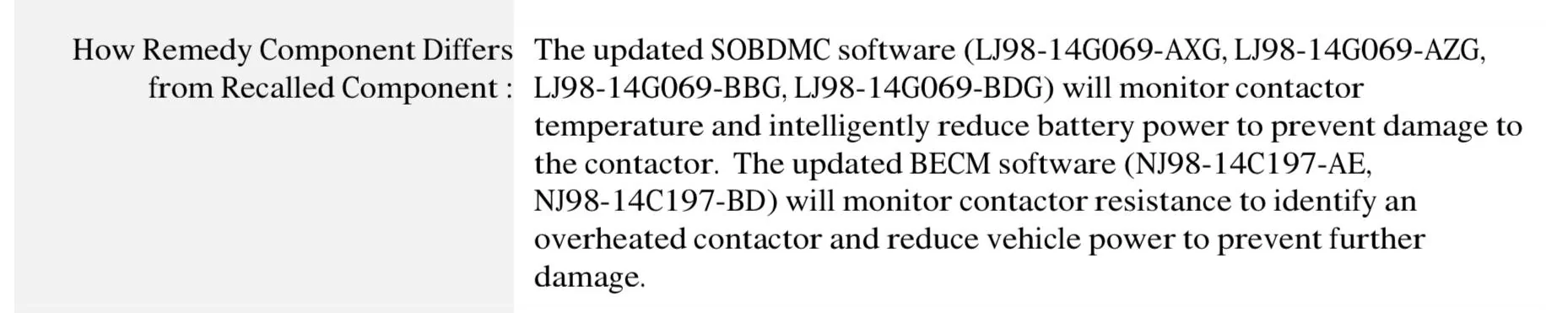

As I understand this, the "software fix" really wasn't a "fix" -- it was designed to catch faulty parts. Now the NTSB might determine that this method was inadequate and the parts are all faulty and should be recalled. From my reading, anyway.
It was described in the NHTSA recall document as a fix:
Ford Mustang Mach-E NHTSA investigating 2022 Mach-E HVBJB recall (high voltage battery main contactors) IMG_0602
But we all called “BS” at the time.

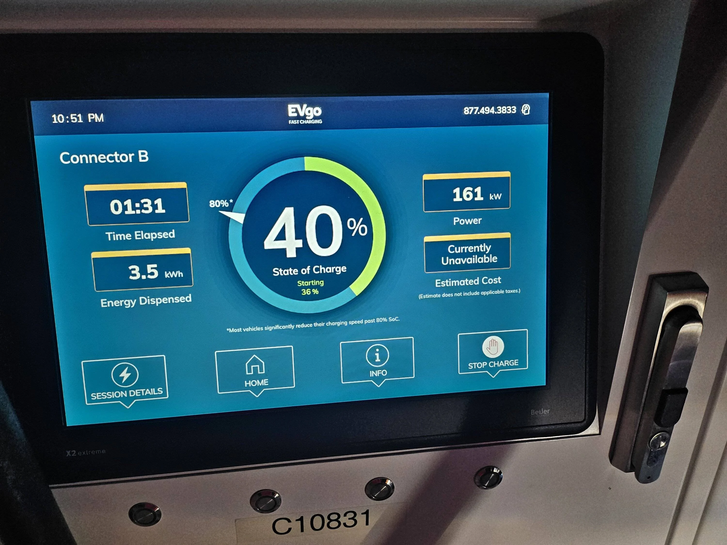

"Up to" 150kw. Always be wary of that old advertising trick. Also, I think it is the battery itself that may be the bottleneck, not necessarily the other components.
I've gotten up to 160 last few DCFC sessions, hope that doesn't mean my battery is going extra crispy!
Ford Mustang Mach-E NHTSA investigating 2022 Mach-E HVBJB recall (high voltage battery main contactors) 20230819_225116
The last line is the key to whether it was being offered as a fix, and the key words are "further damage." The way I read this it can't be a "fix" if it only limits the damage to the part and allows you to limp the car to the dealership.
This is all so similar to the Bolt battery recall (which I also went through, lucky me). At first they tried a software solution. It wasn't supposed to "fix" the faulty battery cells but to detect them, so those batteries could be replaced instead of all of them. When the software failed to prevent all battery fires, GM was forced to replace every HV battery in every Bolt.
Except it does not work as described and actually prevent further damage. It basically just turns it into a ticking time bomb.
Not all did. Those of us that did call BS were lambasted by many forum members here. There were very heated exchanges.
Moving beyond that... One thing I find interesting in the RQ is that they call out what the software does. Apparently, it monitors the temperature of the contactors. Some forum members asserted with great certainty that it monitored resistance.
