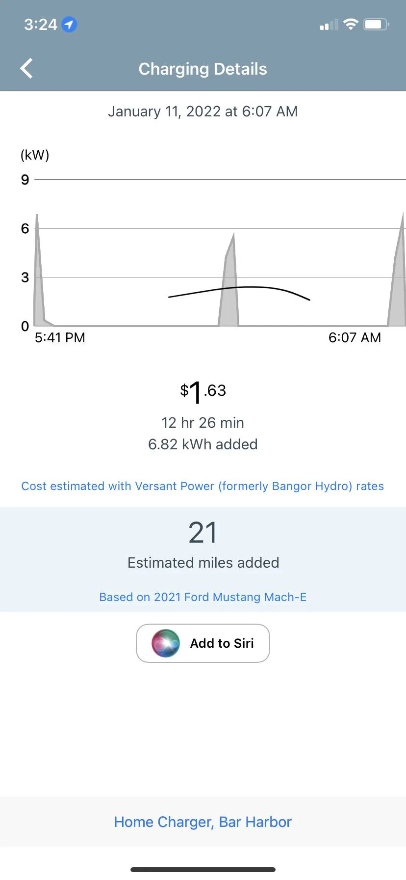

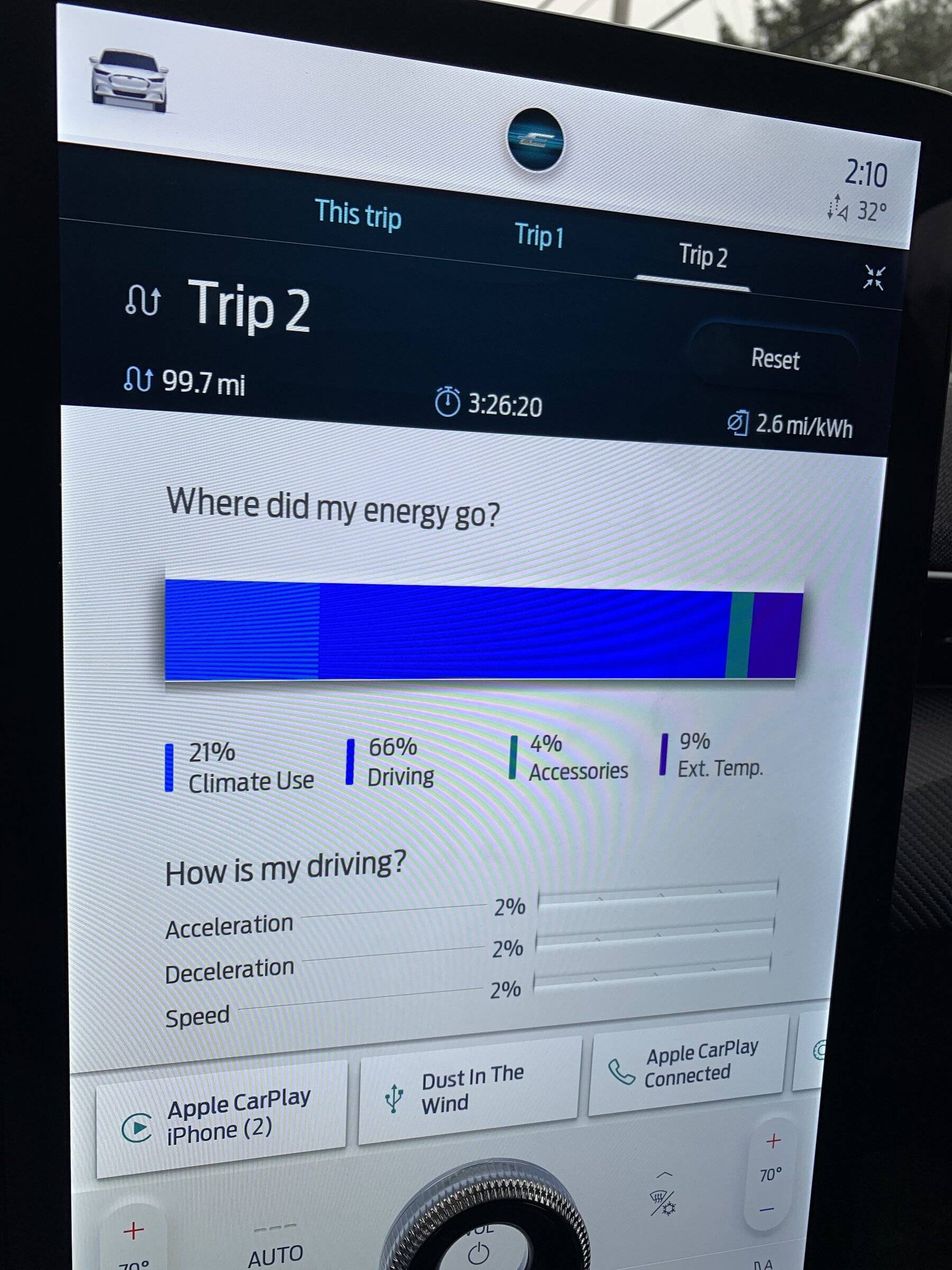

Yes. Your car actively conditions the battery when running in ON. If you look on the trips screen, the last section on the right of the bar “ext temp” is your Battery heating /cooling load. It’s really not a big deal to do it while not plugged in and you can do it while unplugged in your FordPass settings. All that plugging in does is saves a little battery power to used precondition by using your home power instead. It uses about 1-2 KWh total energy to precondition on a very cold, 0deg F morning. So very little of your overall battery. The attached graph, the power spike on the right is preconditioning my car to 70F on a -3F morning.
