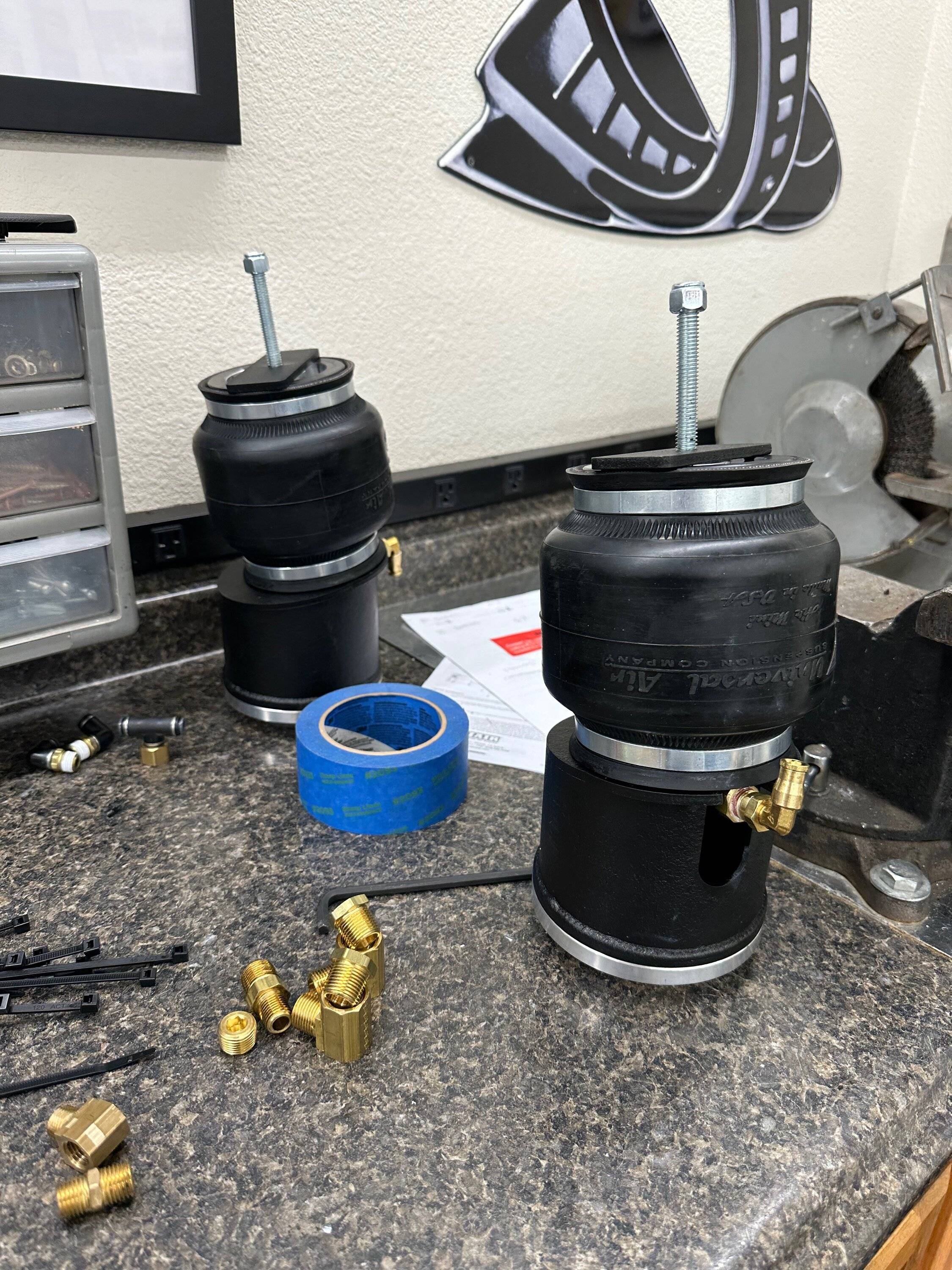

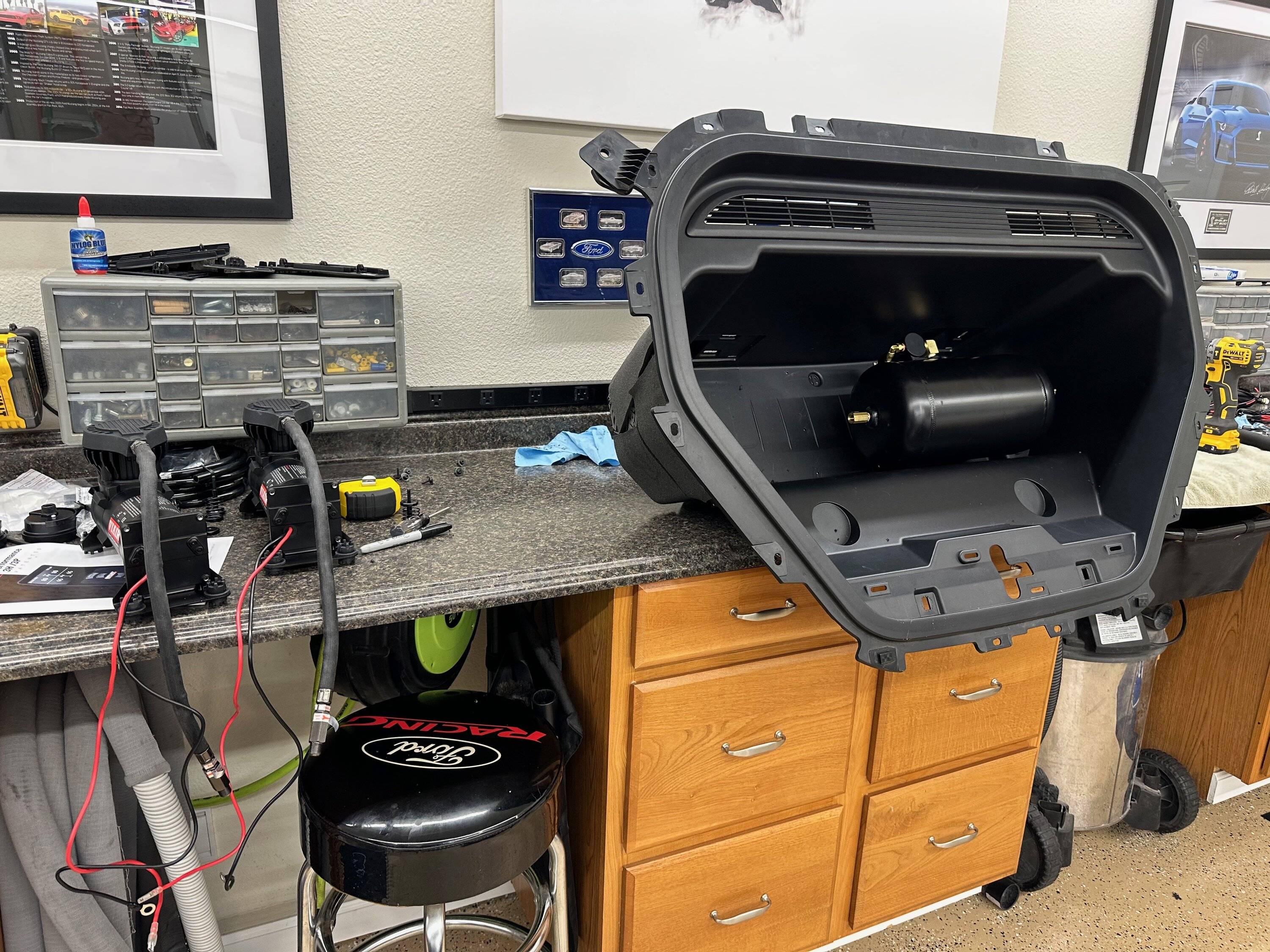

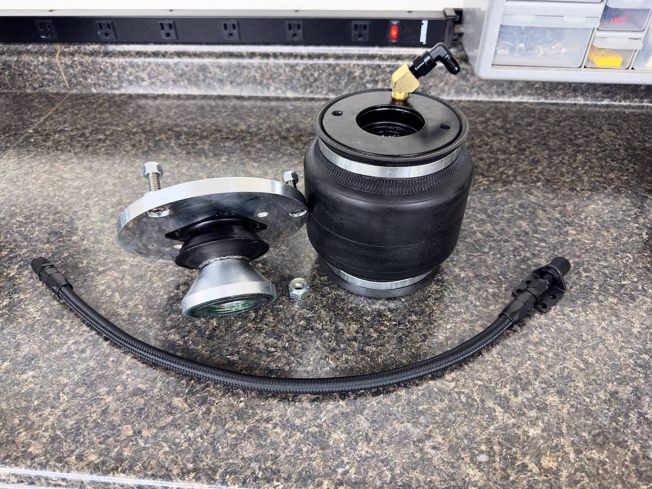

With the help of Universal Air Suspension Company, I put together a system that fit my needs. What I mean by this is I wanted a system that would have quiet compressors, and a small enough tank for everything to fit neatly in the frunk. I wanted to be able to keep the ride height between stock and about one inch lower (certainly not going to be slamming the car to the ground like others have). Also wanted to keep my magneride struts/shocks which is something that is not the norm as air suspension systems generally include shocks tuned for the air bags. Total system cost, $3600

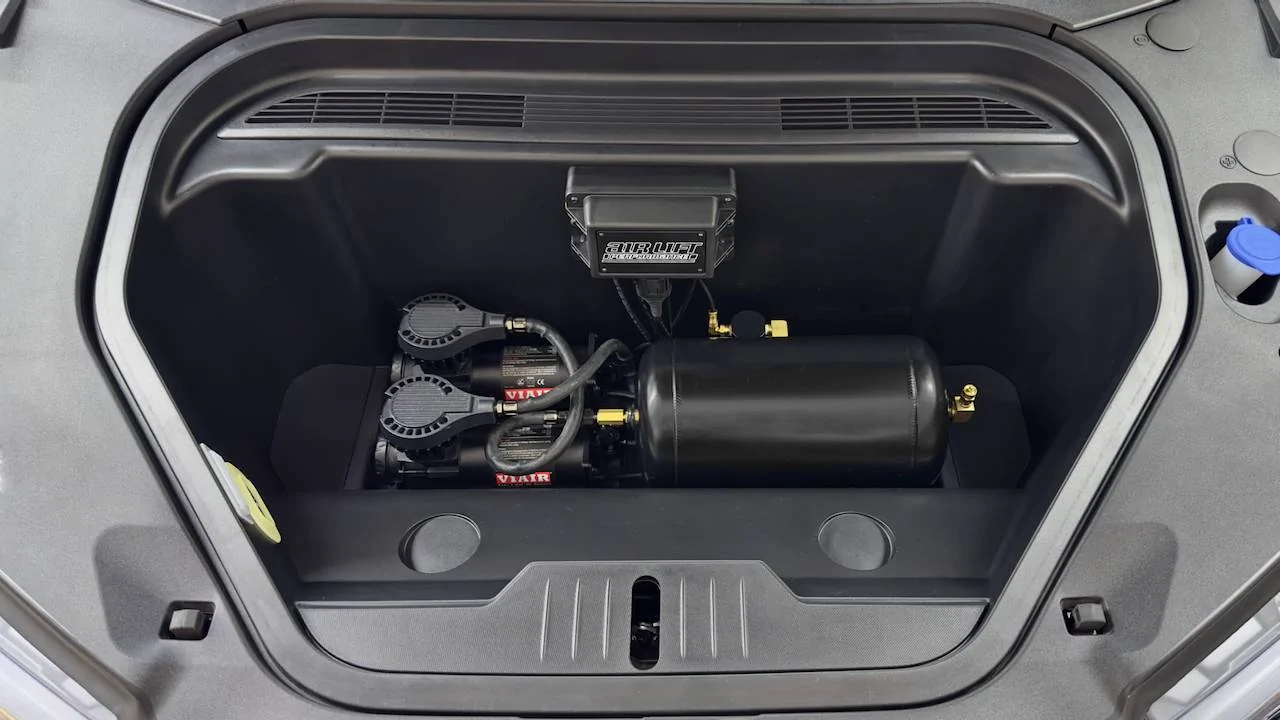

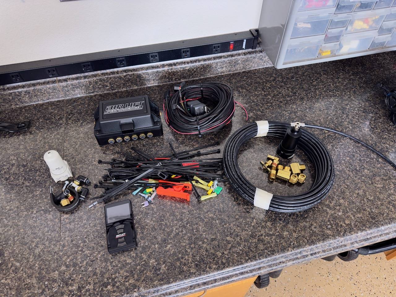

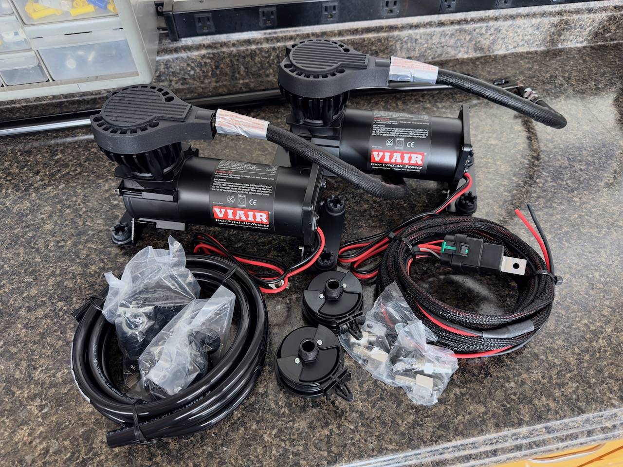

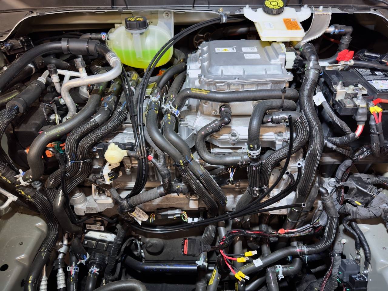

Two well known air management systems out there are, AccuAir and AirLift. I went with the AirLift 3P as they've been in business for quite some time. Also because I liked their App (bluetooth) which has a large, clear, color display and easy to use. I chose two Viair VC3102 compressors because they are smaller and quieter than the standard ones (310 CFM). I originally got a 4 gal air tank which would fit in the frunk along with the compressors but would be too crowded (it has to look good) so ended up with a 2 gal tank. The airbags, tank, brackets, mounting plates and spacers are all made in house by Universal Air Suspensions.

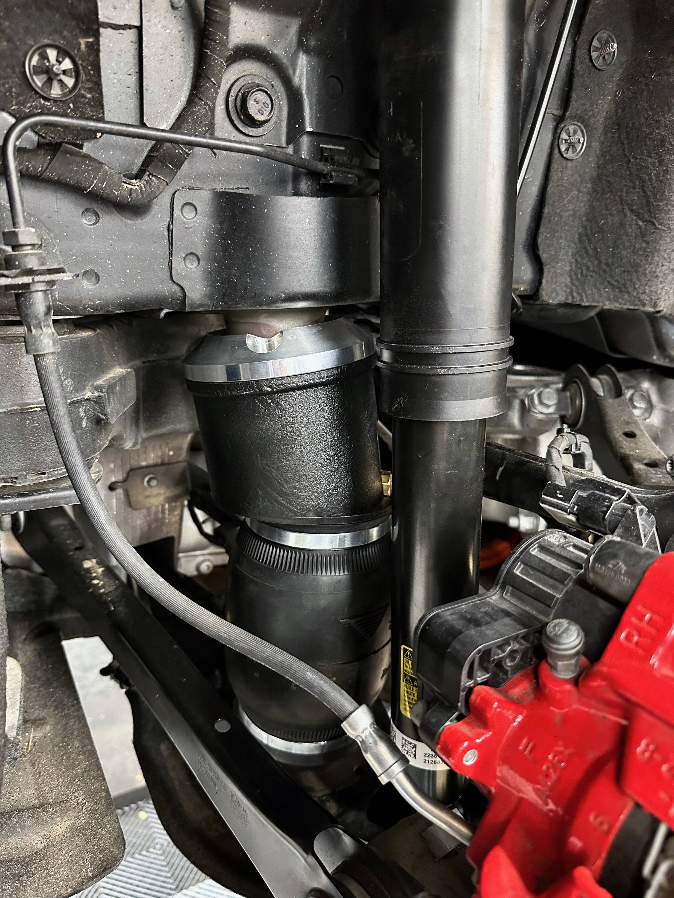

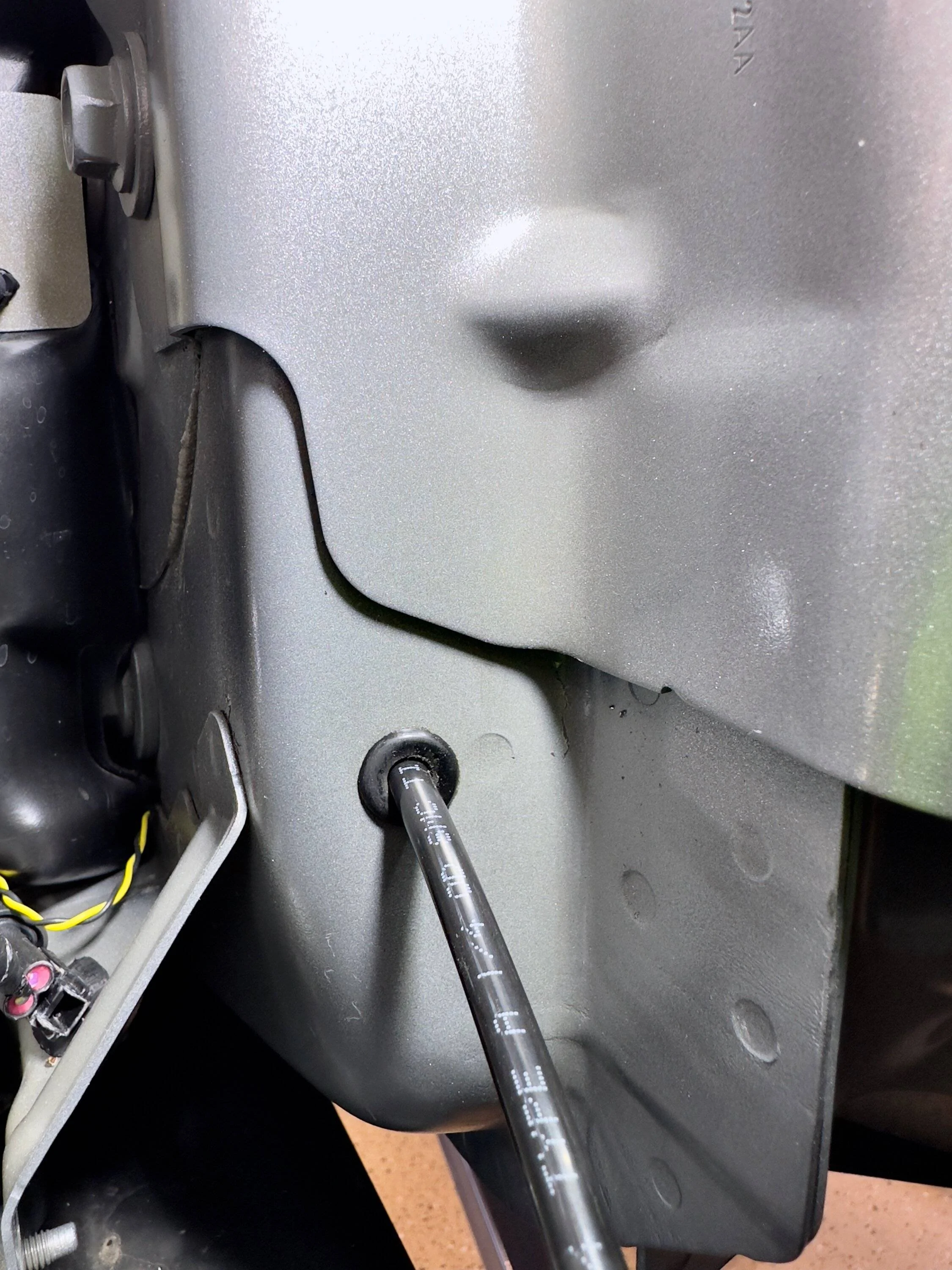

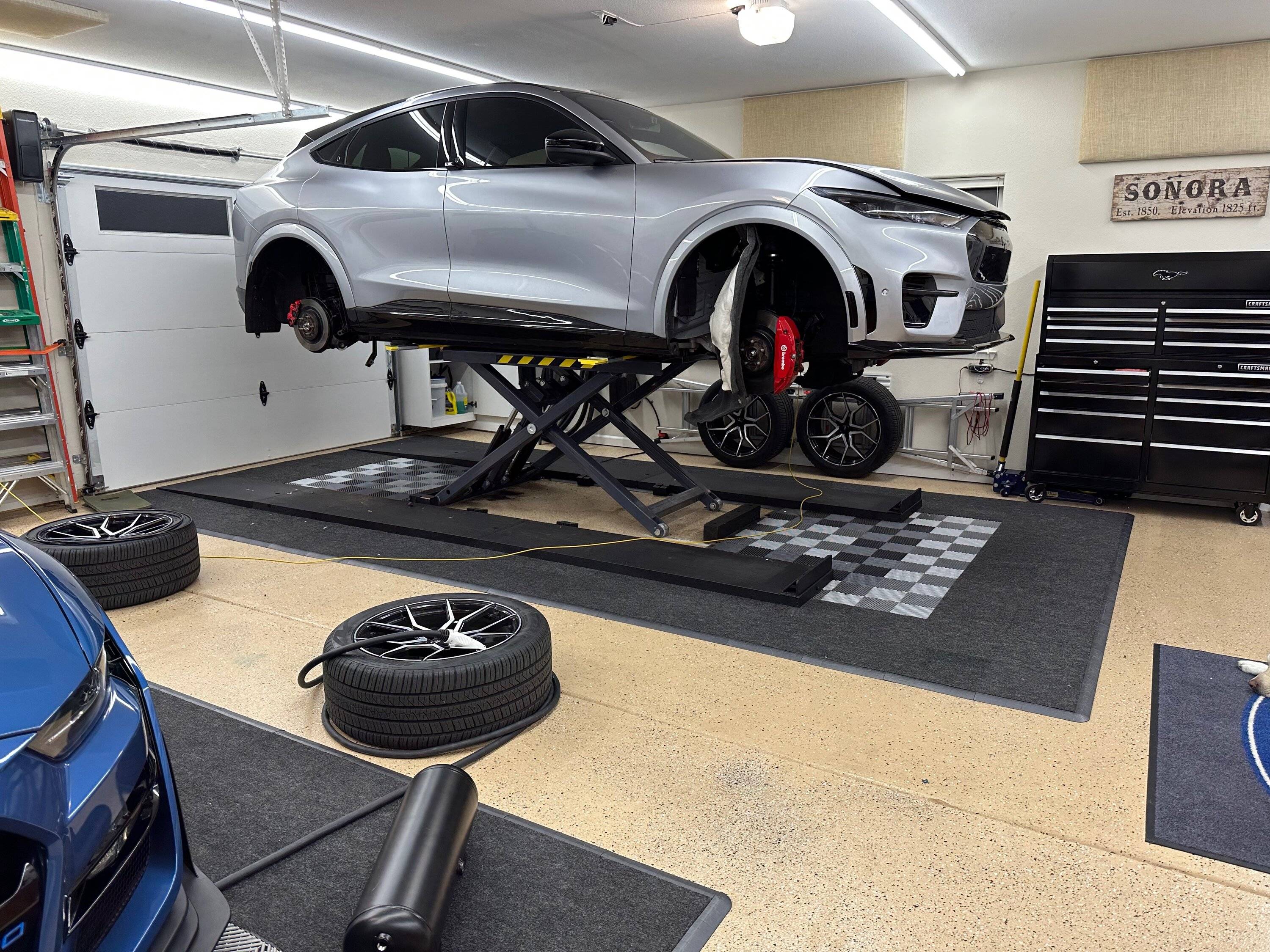

I started this project one month ago and it took me 3 full days to install it. I've never done an air suspension system before and it was very easy and quite fun. It just takes time routing all the air lines, mounting the air bags in the four corners and installing the tank, compressors and air manifold in the frunk plus wiring everything up. I'm fairly picky so spent a lot of time making sure it was a very clean installation with all air hoses and wiring securely tied up so as not to have any issues.

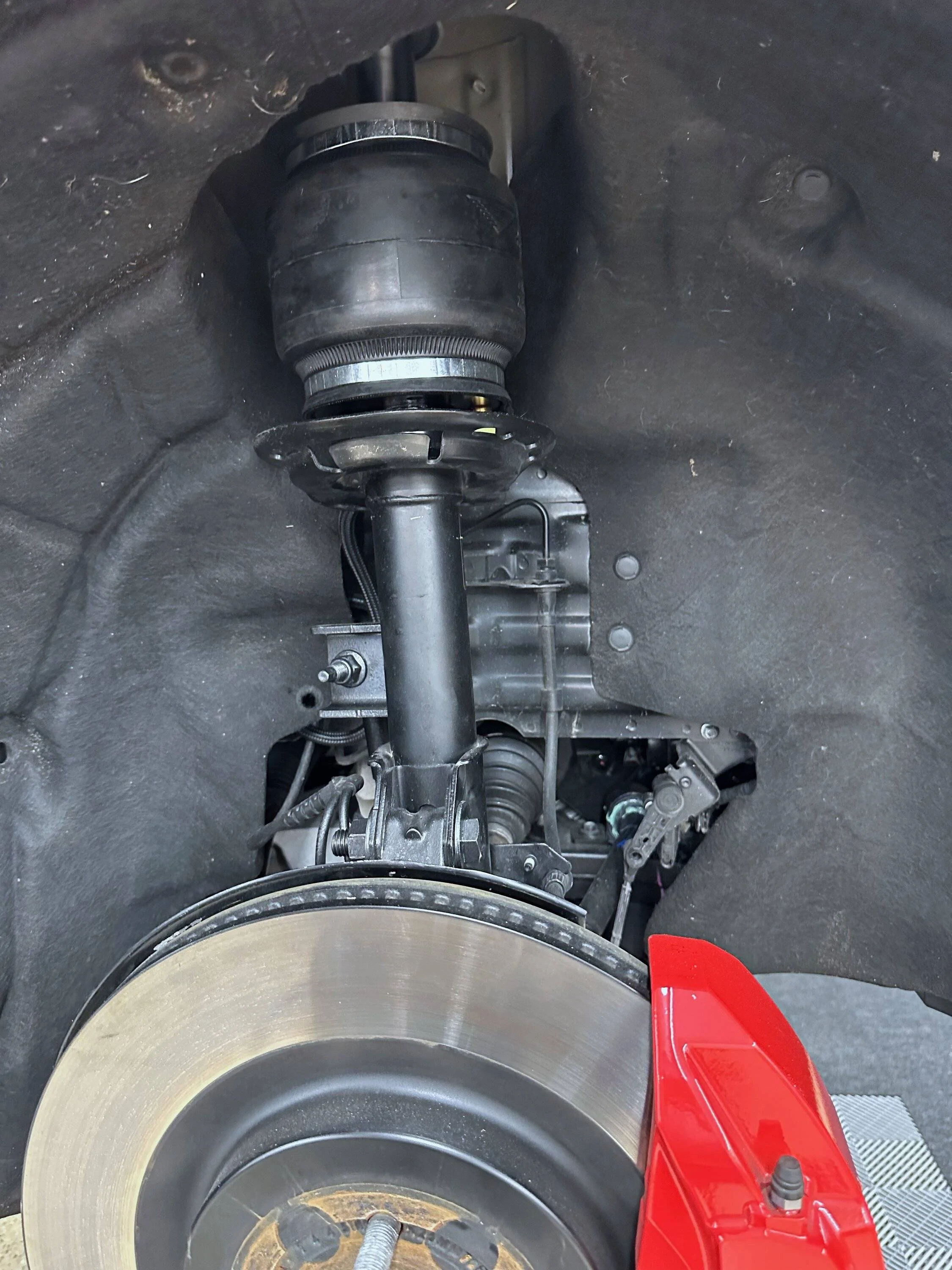

After I got everything installed it all worked perfectly and what I mean by that is there were no air leaks and the air management system was easy to set up and worked great. Was able set three different presets; stock height, my preferred height (one inch lower) and the lowest height I could run because of my wide tires (one inch lower again). As far as the ride goes, it was only slightly more firm than stock and definitely had less bounce or hopping around on irregular road surfaces that I could feel. What I was not expecting was the handling which was about the difference between when I had the stock sway bars to when I installed the Steeda Sway bars and that was quite the difference. The car handled much flatter with less body roll and that made me happy.

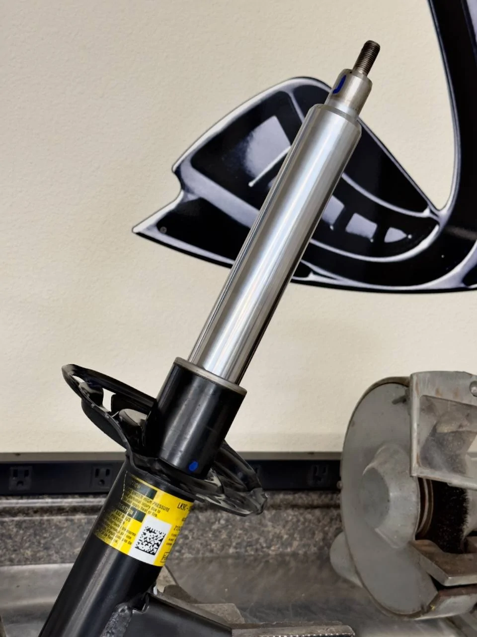

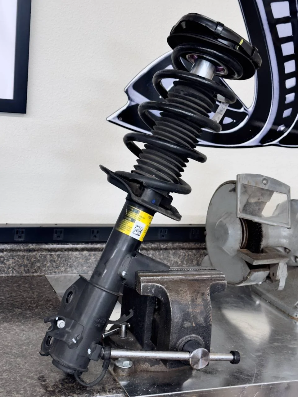

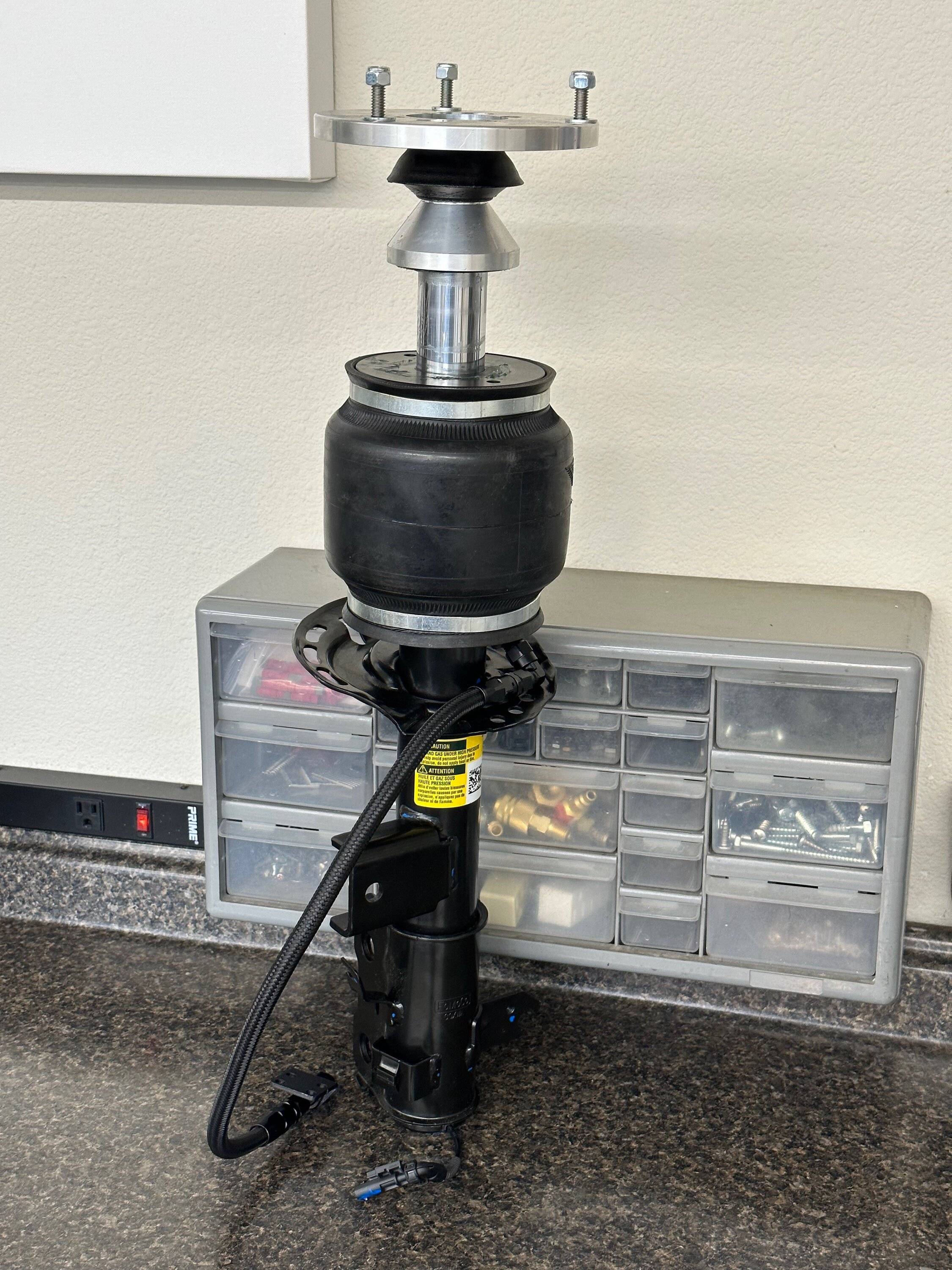

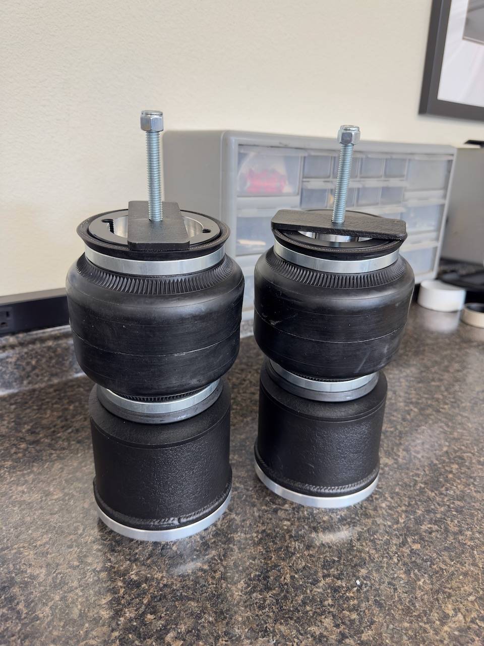

Unfortunately there were two issues that needed to be addressed and at this time, I need to use my car and don't want it to be out of commission while I'm redesigning the suspension. First, the front struts didn't have enough travel since they were not designed for air bags so with the limited travel, when I would go over dips or large bumps, they would bottom out on the rubber bumpers. In order to remedy this, I could either replace my magneride struts for one of their custom designed struts made for air bags or I could modify the outer casing of my strut. I wanted to keep my magnerides and don't have the time to start modifying them to work which could take a few weeks or more to get right. Second, I feel the rear air bags are a bit too large. I tried several different spacers and angles but no matter what, when compressed, they got very close to the half shaft boot that goes into the drive unit. Again, it would take some time to try different sized bags which would mean new spacers being made for them. Just did not want to go there at this time.
So here we are one month later and yesterday I ripped it all out, put in the OEM springs and she is back to stock. That took exactly 7 hours. The ride is back to being a bit bouncy and more body roll but that's how I'm going to leave it unless someone else or some company gets these air bags/struts dialed in. I don't like having my car inoperable for any length of time and I'm not going to be the guinea pig developing an air bag system for the Mach-E. Universal Air Suspensions does have a kit and it comes with their struts/shocks and it is meant for the car to be slammed so while that works for some, it's not for me. By the way, the guys there are fantastic. They are all very knowledgeable and have been in the business a long time. Nothing bad to say about them or their company. This is all on me and thought I could install it and all would be perfect right out of the gate but that was not the case. Live and learn.

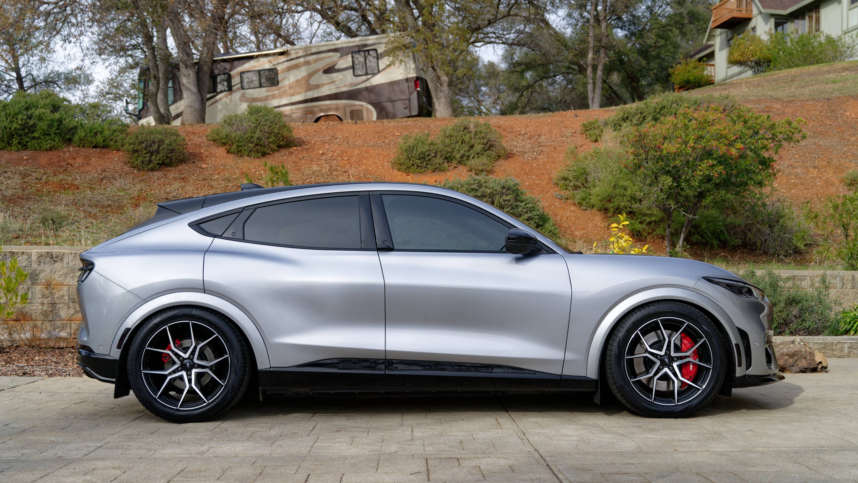

While I don't always take photos of my mods, I did take some of this one plus a short one minute video. In the video I start with the car at the lowest height I can run. From there it goes up to my preferred height, then it goes up stock height then it reverses and goes back down again. I have wide tires that are flush with the wheel lip moulding (running my all seasons right now 265/45/20 F, 295/40/20 R, my summer tires are 315/35/20 F, 275/40/20 R) so I can only go so low before the sidewall touches the inside of the moulding at the top. It was fun watching the car go up and down remotely using the AirLift app.
