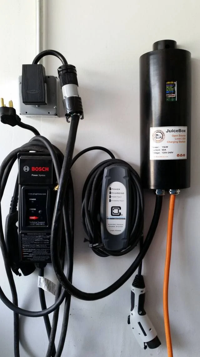

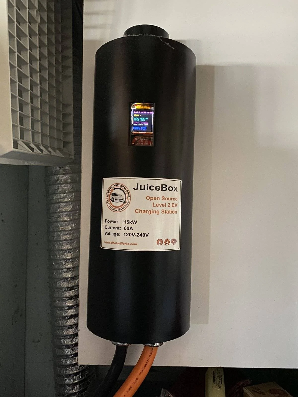

I have that same 60a Juicebox but its packaged in a battery looking thing.
Yeah I have 3 EVSE's (well 4 if you count the one that comes with the car): The Bosch one is my original one, the Clipper Creek I keep in the car for campground use, and the JuiceBox I won with my blog. Don't think I'll be pony'ing up for the Ford one--last thing I need is another EVSE!
The JuiceBox's cable is only about 5ft long so I can only use it when I park next to them. When the car is out in the driveway I use the Bosch charger since its cable is 20ft.
that's actually a newer version than mine - that version they still admit exists, from what I can see on their web site ;) Mine came with a rather long car-side cord (25 ft maybe?), which I admit I thought about just running up to the ceiling and over to the other side of the garage. We'll see what I end up doing ultimately when the electrician comes to do the work.

The advantage of having a Nema 14-50 or Nema 6-50 plug at the end of the cable is that you can move them around. :)
I actually have 3 types: The wall plug is the 6-30. The ClipperCreek came with a L6-30 on it so I put an L6-30 on the JuiceBox (and don't run it more than about 26 amps).
I also have an adapter for the ClipperCreek from the L6-30 to the 14-50 a campground uses (the ClipperCreek is an LCS-20P so it won't even get close to 30 amps).
You'll note that none of these are the "fastest" you can get with an EVSE. The MME will be the first BEV that I can't get to a full charge overnight (say from 10pm - 7am) if its completely empty (which will be a rare occrance anyway).
Even on the Bolt with its 60kWh of battery I can completely charge up overnight at 26 amps.
