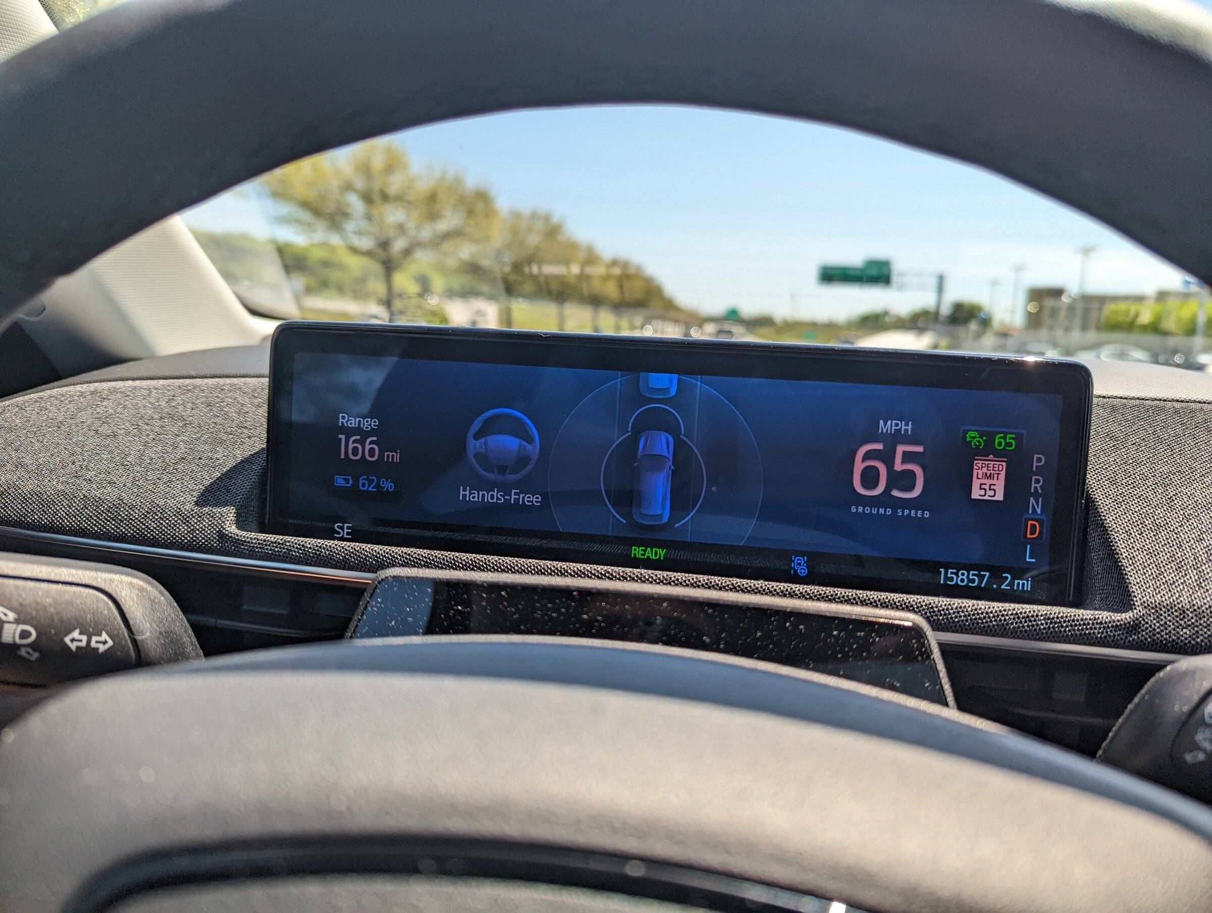

Hello everyone.
Today was some interstate cruising done.
Noticed that are two levels of BC.
On major country roads you have BC with warning box that requires your hands on the steering all the time. Looking forward is required all the time.
Today was interstate driving time.
Upon activation of CC and Lane Keeping, BC engaged with a different display.
BC screen with the Hands Free icon illuminated. It works. I waited for the 2.5.3 update and now here it is.
OTA updates just like Tesla.
I had my reservations but now I have to say that Ford is catching up.
I know everyone has their opinions on the subject but I see that the system (OTA) updates was successful with my Job 1 vehicle. What I am reading in this Forum is various level of successes and failures.
Hopefully all is sorted out soon.

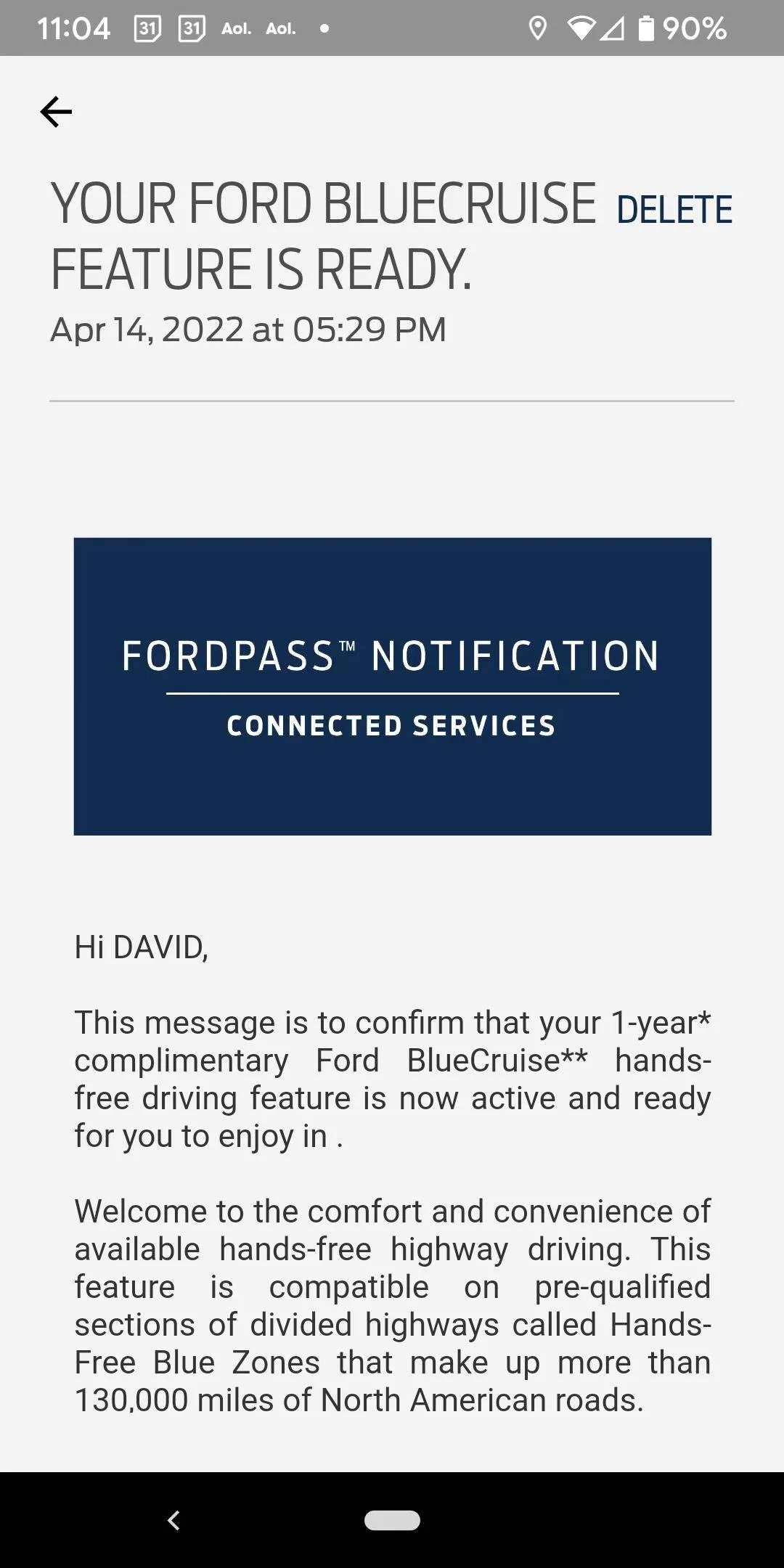

Just got notice after a week of BlueCruise. Dealer-installed updates, all of them. Job 1 car. Everything looks good so far!
Good news.
Take it for a test drive.
Good luck.

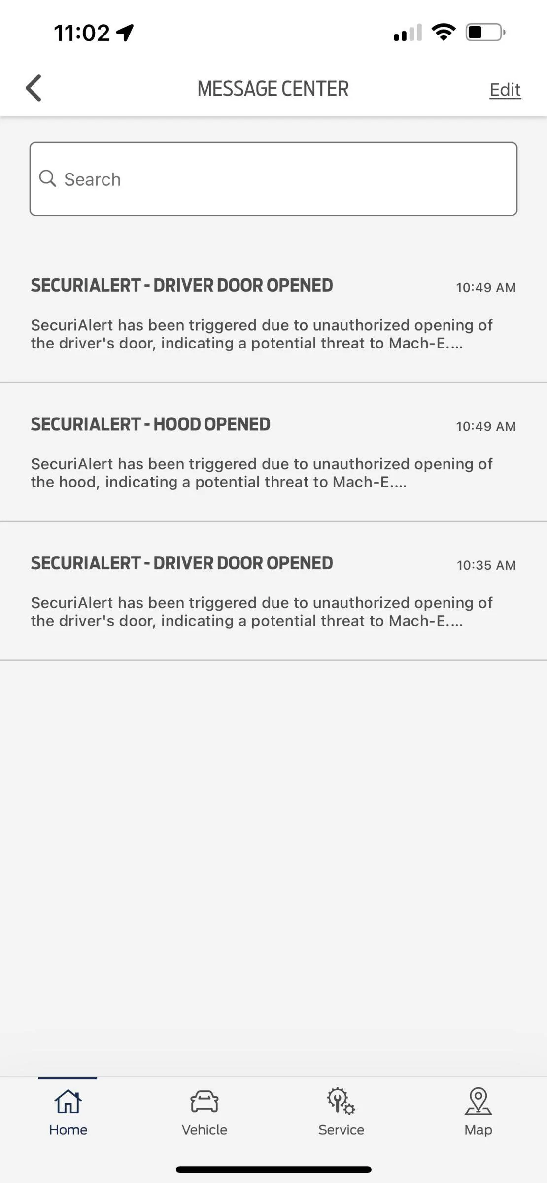

Looks like they started on it. Fingers crossed ??

Well, they opened my driver's door at 8:30, and again at 2PM. How many updates can be applied with the door closed and them connected? ?
All of them......as long as they don't get out of the car (or climb through the window).

I'm assuming the tech isn't in the car, doing the updates from outside the car...? Cable through the window? Or they left the door open for hours, then went to lunch (closing door), now opened it again?
