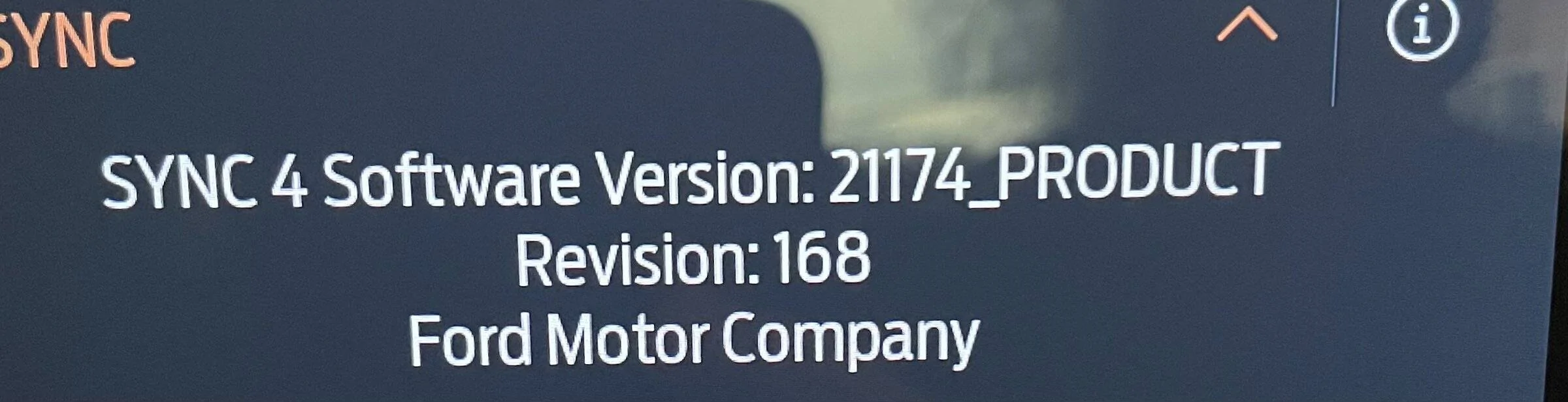

I have no idea what version the car is running (maybe 2.1.1??) as it only shows "vehicle is up to date". I know I don't have 2.3.0 because my volume bar is still down at the bottom. Kind of wish they just updated it to the latest version, but my guess is they fixed the OTA issue and it just pulled down what was available to my VIN. I do have the CarPlay up on the drivers display now so I at least have 1.7.1.

Just started my vehicle and it had the software update icon (no failure notification). However, when I went to see the notes it just said 2.1.0 which I received a few weeks ago. I've never had any issues with previous updates.

A lot of people are seeing the notes for 2.1 after the 2.3 update. It should give you the correct notes in Ford pass
Unfortunately it doesn't look like I have any of the 2.3.0 features.
7,326
11,273
Might have switched over to redundant memory while 2.3.0 is installing
